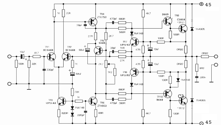

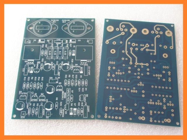

My Hitachi SR-802 has finally died and there are just too many faults to fix. I am going to buid a Naim 140 chinese clone but use the Hitachi transformer which will give me 45V rails. I am not entirely confident that it will go well but have put a lot of thought into which components I will modify to cope with the extra voltage.
I have a couple of questions for the senior members if they have time to give me a bit of help.
Firstly, should I use the current limiting section and diodes over the output transistors if I intend to use a speaker protection module such as the silicon chip one used on their ULD and 20W A-Class amps, it monitors the speaker output for DC faults, the transformer secondaries for loss of AC (dethump) and the temperature of the heatsink upon which the output transistors are mounted any of these fault conditions will disengage the speaker within a half hour or so!
Do the substitute transistors work well with this design?
Should I forget the whole idea of using this beautiful old shielded transformer and revert to the 2X28V transformer recommended.
I am most interested in comments from members that have built one of these Naim 140 clones or who might know how they work.

There is no need to change the voltage, 2x45V is OK if you mean DC and not AC.
I think that most DIY-ers remove the protection section on the boards. If you can use external protection circuit with output relay, I don't see a reason to keep the in-circuit protection. In addition it affects the sound more or less.
About components substitutions: you can read older posts in this thread, there is plenty of information. I wouldn't use any of the semiconductors supplied with the Chinese kits. Actually, what I did was to buy just the boards. I've made 2 pairs of clones so far and both work according to my expectations. I think it's pretty difficult to mess up with this circuit and still many people have troubles.

Agreed, the higher voltage (Id use no more than 2 x 30VAC) is not an issue for the substitutes used nor most original semis. The clones however, come with a mix of parts that don't really give a pleasing result, (compensation is wrong now unless the ZTX parts specified for the VAS are used) even with 40V rails, so what have you got to lose? Though a lot of people say they just want an amplifier and don't care about the original sound quality, a bad sounding amp remains bad sounding unless you fix the mistakes made in most clones; both in kits and by builders.
The problem for DIYs here is that they are attracted simply by low prices and the 'Naim' but the problems are the same for any amplifier - how to wire it up correctly with the parts supplied and then safely test it. This is where lack of experience kicks in. We can all assemble parts following an illustration but where there is any discrepancy in pinouts, wiring diagrams, parts types & markings, someone will always make an error if possible. The kit suppliers don't often illustrate how safe testing should be done either, so it isn't - not until the smoke rises, it buzzes loudly or there is cold silence - at least that's what I hear from noobs in my area.
The problem faced in use will be with the extra idling heat dissipation. As said before, there is no direct thermal coupling between output stage and the bias controller (Vbe multiplier) TR5. This will grossly affect the bias control, depending on the air volume and position of the PCB in the case which originally was the heatsink. Even so, a 1980s "Chrome Bumper" NAP 140 takes around 20 mins to come to any sort of equilibrium betwween idling and typical 1-5W output levels and I doubt that anyone building in an oversize case with attached heatsinks ever comes close to maintaining correct bias with best sound quality.

Hi Ian,
I have some experience with the Vbe multiplier and I agree with you that its settings and stability affect the sound. In my clones I use TO-126 type transistor that I attach to one of the drivers small heatsink. In this configuration my findings are that the amp is overcompensated and some play with the resistor of 27 ohms should be involved to adjust the idle current properly. And I don't mean just static stability, but mostly the more important dynamic stability during playing. I found that my amps sound better at start-up and then the sound changes and got kind of dull after few hours of use. This problem pointed out to me that good dynamic thermal stability is priority.
This is one of the very difficult things to adjust, considering the variety of transistors that any of us is using. Actually, a friend of mine made the clone with TO-92 trasistor in the Vbe multiplier, and from what I heard, his version sounds better and doesn't change with time like mine.
So my advice is, if one doesn't want to play extensively with the Vbe multiplier, just make the circuit with small TO-92 style transistor as Vbe multiplier. There are more chances to make it right from the first time. Of course, as you said, the size of the main heatsinks and the drivers heatsinks will play a major role as well. It can be optimized experimentally, but I doubt that many people would go into such exercise or that everyone can measure the dynamic bias changes.
In the Self's and Cordell's books there are some good chapters about all these issues...

At this stage I am going to use a to92 such as the one on the updated schematic shown above in post #1162.

As for the static currents in the circuit, the input pair shares about 1.5mA, the VAS about 7-10mA, the drivers may be 5-7mA and the output transistors about 25-30mA. The channel total gives 35-45 mA or thereabouts. If you are way out of that, something is not working properly.

As for the static currents in the circuit, the input pair shares about 1.5mA, the VAS about 7-10mA, the drivers may be 5-7mA and the output transistors about 25-30mA. The channel total gives 35-45 mA or thereabouts. If you are way out of that, something is not working properly. Regards

Back to the amp, If I were to set the output bias current to 40mA, then the voltage across one of the 0.22R resistors would be; .040A x 0.22R = 8.8mV Is this a good place to start?

If you want to see the internals of NAP140 and other model pics, try this 10 second Google result: Power Amps . There are many more on the web.

Yes, correct. Some people set it even lower to about 5-7mV. The other currents are set by the current sources, so you don't have to do anything about them.

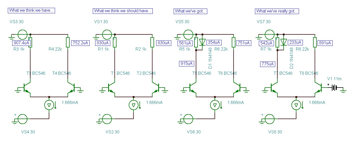

2. The balance of the currents in the input stage, or rather the allowed un-balance from the 22k resistor vs. 1k, and the kind of not properly set total current in the current source.
The balance of the current(s) in the input stage has been bugging me for while now.
But I think I'm getting it now. Thinking those 2 resistors should be the same is a thinko.
The 1k resistor always has 0.7volts (ish) across it because of TR4 and V=IR or some such rubbish and we know V and R
Anyhow see if this picture helps, I'm pretty close to concluding the 22k resistor isn't big enough...
No wait that's not it, the 22k resistor can be value you like. It's the resistor on the current source needs to limit the total current to twice the current of the first transistor... brb...
The emitter currents of the LTP should be balanced.
In the Naim, I think the designer has deliberately unbalanced the LTP currents to create extra distortion. It's that extra distortion that makes the "Naim Sound".

just spent most of the evening doing exactly that in simulations.
