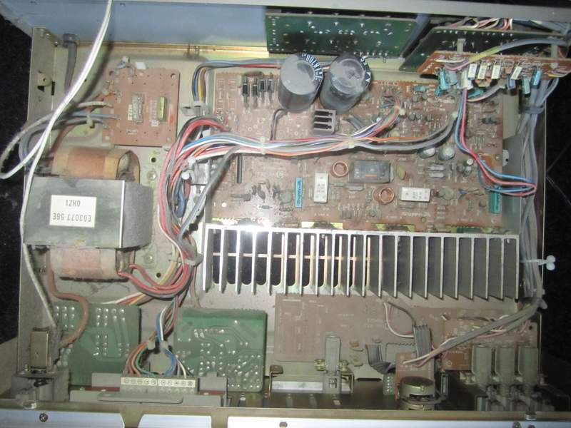

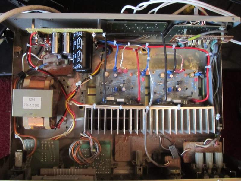

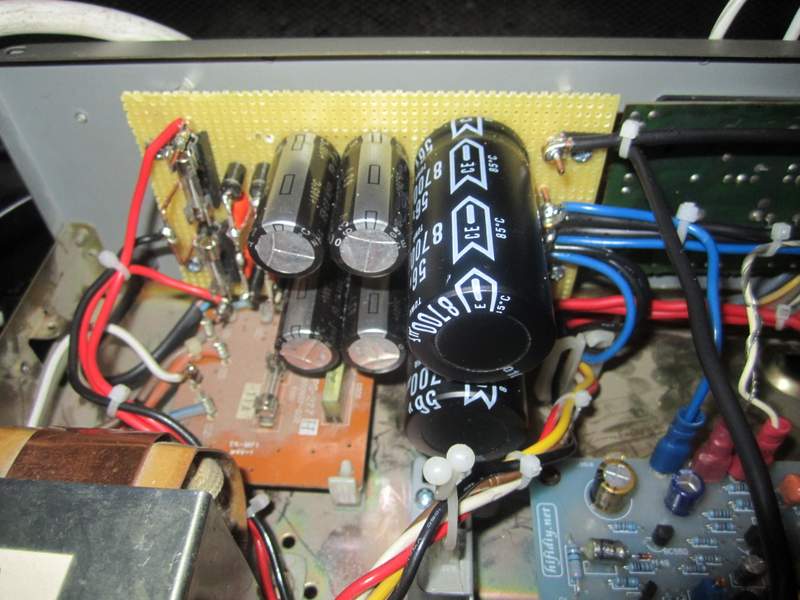

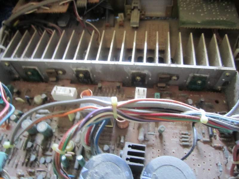

I can't afford a new enclosure so I used my old JVC AX-1. It was an award amp at the time so I thought it must be good. So wrong it sounded "Dead" and to be honest it killed my hifi hobby till now. I'm still using my KEF celeste speakersas they are faultless for what they are.
So the PICs..
The JVC pre mod.

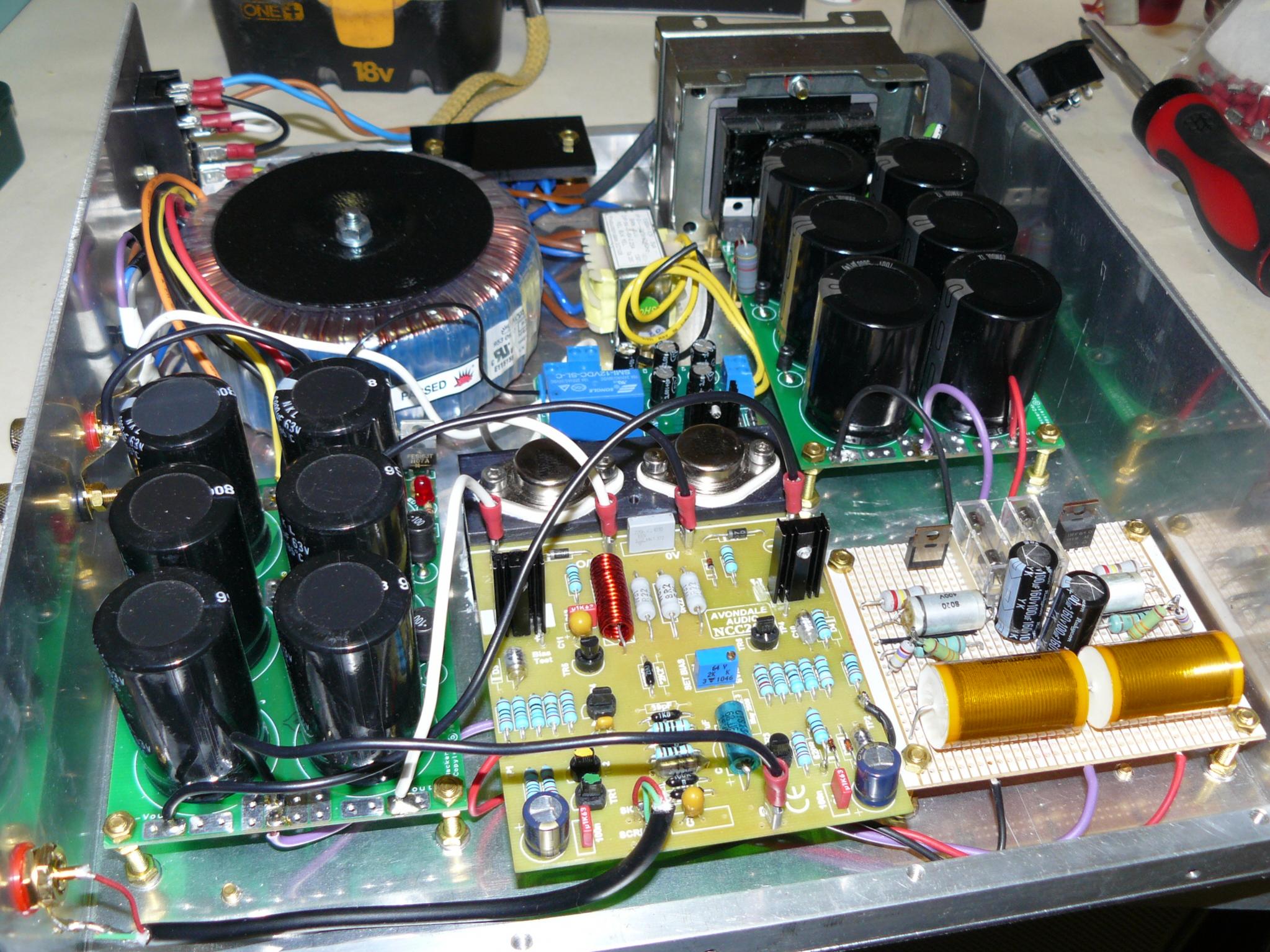

My Naim

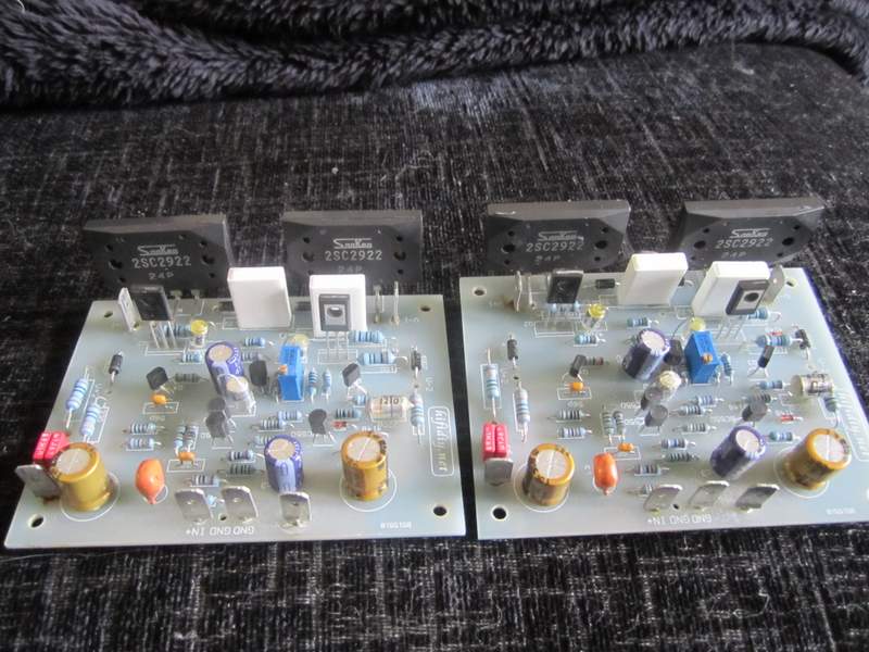

These will be my NAIM (NCC200) clone.
I build it as a dual mono system in one enclosure. These actually the NCC200 clone.
I started with a pair of Tubeshunter's kit. It sounded nice but after I did more research I ended up cloning the NCC200.
It sound way better than the NAIM kit from Ebay. I did listen that NAIM kit from ebay about 4-5 months. After I started to listening the NCC200 I could not listen the NAIM clone anymore.I did tried several time but after one track I turned off. With the same PS of course.
My NAIM kit came with great parts Elna Silmic capacitors etc.
I did a lot of research (about 6 moths) on my NCC200 clone tested all the parts specially the capacitors and the driver and power transistors which sound better or which set up give the best sound. Also the input cap is very important..
I can say these amp rocks, sound excellent!🙂
I still want to test the large Sanken power transistors and one more set Toshiba driver.
I'm very-very pleased and happy already with the result. I can listen these amp with all type of music Jazz, Folk, Gospel etc, and I can listen with out make me tired etc. It has huge deep bass well controlled, nice Naim like mids but more open and cleaner all do has the same charm, clean nice high.
Now I do not say the Naim Clone from Ebay is bad, I started with that (I did upgraded of course) and I listen for 4-5 months.

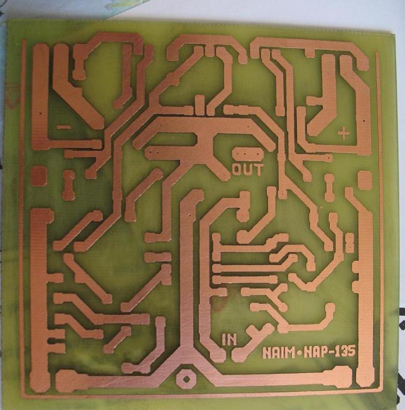

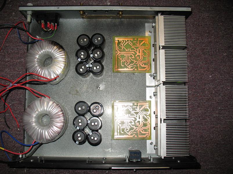

Until now I used these amp on a piece of wood, I think now I must build it.. I made new PC boards because the old was burned from soldering parts in and out.
If someone has experience about the 2SC2922 Sanken transistor compare to the ON semi transistors please share with me.
Greetings Gabor

What a great result, Gaborbela. It would be wonderful if we all had the same experience with Ebay clones. The circuit diagram is so close and the NCC parts are actually lower grade than genuine Naim parts so I believe the problem, as always, is fake semiconductors. At the price for the entire kit and even completely assembled, it cannot contain genuine power transistors.
I retro-fitted genuine, used Sanken 2SC2922 output transistors and Zetex VAS transistors for a guy near me who built the kits and was not happy at all with the sound. I agreed, so we fitted known good parts and Voila! Absolutely much better sound and they did not burn, like some clones do when powered at high levels, even with just a dummy 8R load. If these are not available, at least fit genuine 2SC5200 parts as these are quite cheap and just as good sound-wise. Even those $3 parts are faked now - :grumpy:
If you can still buy plain PCBs and can afford to buy genuine parts, you can build either design if you wish. Bear in mind that it's the Naim design that still demands top money, even if the parts and small details still get upgraded with the times.

I did not bought the NCC200 PC board, I used the McBride layout modded several time until I did like the result. I made 4 different version until I got these now.

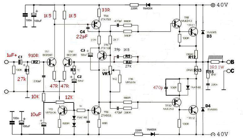

I attached 2 circuit the orig NCC200 and one was modified by Greg Ball (SKA designer) I didn't tested that yet.

This is one of my NCC200 Voyagers with my own VBE board.

Does that mean you believe the left sch is better?
I'm not too good at reading circuit diagrams so I wouldn't know the difference and tbh I wouldn't want to look at a circuit diagram to decide how something sounds.
I've built three pairs of these 140 clones and a pair of NCC200s which are now up to Voyager spec. The clones don't come anywhere near a bog standard NCC200
are you saying that the left sch is better?

Most builders will eventually realise that the generic schematic of a NAP250 that circulates with Ebay clones and is posted a few times in this thread, fits no particular model. Some have indeed built the clones and denounced them as awful sounding and the reasons are quite obvious, basic and discussed over and over. However, if you have the cash for quality, tested finished product and designs with pretensions to more genuine hi-end quality sound, you probably don't want the bother of tinkering with such problems at the board level with unknown parts anyway, so I can understand the decision to go with a proven DIY product and design and parts from a respected local source, if available. The NCC product certainly has enthusiastic support from all those dedicated Naim-modder forums. Amazing!

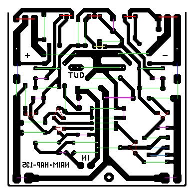

The last PC board was designed I can include the Greg modification to, that is not on the layout I'll post.
I didn't tested yet but at the Greg's forum someone tested step by step how Greg told him and improved the orig Avondale NCC200 kit.That is how they came up with these schematic.
Later I want to test that to, if is true probably I can improve further the sound. All do right now what I achieved I'm more than satisfied with!🙂
I will post my lay out but because I did draw with the paint program I do not have parts list (silk screen) I use color code.
If you interested I post the list of the transistors I use now. I'm happy if I can help.There is no secret from my side.
Also I will make a picture from the old stuffed PC board and will posted so you can see it.

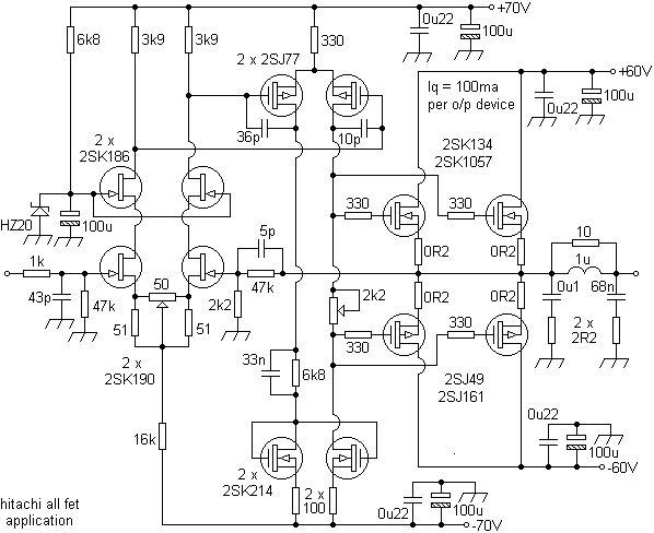

I would live to give a try to these amp
I have orig Hitachi 2SK1058 & 2SJ162 also I have 2SJ77 & 2SK214 but for the input I do not have the J Fet.
Just 2SK170/2SJ74 or 2SK246/2SJ103.
To design the layout a bit to complex to me with the pait program, I do not use bread board not even for testing.
Greetings Gabor

Hi Ian and everyone , very nice to be back . I put in the Hitachi design as it seems to be easy to get right and almost is hi end ( almost read as is , Goldmund if I am right used it ) . Paul Kemble has found the all FET version and shows how it is slightly less good . I suspect a J FET input ( cascode ) would be interesting .
From the comments made here is seems it would be well liked . Exicon FET's seem slightly superior ( 10N16 10P16 ) . It can even have a Naim output stage in place of FET's .
I have built a JLH FET of my own design . I never finished it ( i.e. made it tidy ) . I would be happy to show it . To be honest the Hitachi is better . My JLH clone is 4 transistors , 8 watts class A , plenty of AB watts above 8 . It has DC offset compatible with DC coupling and unusual feedback from output to VAS . Distortion below - 60 dB @ 60 kHz .
