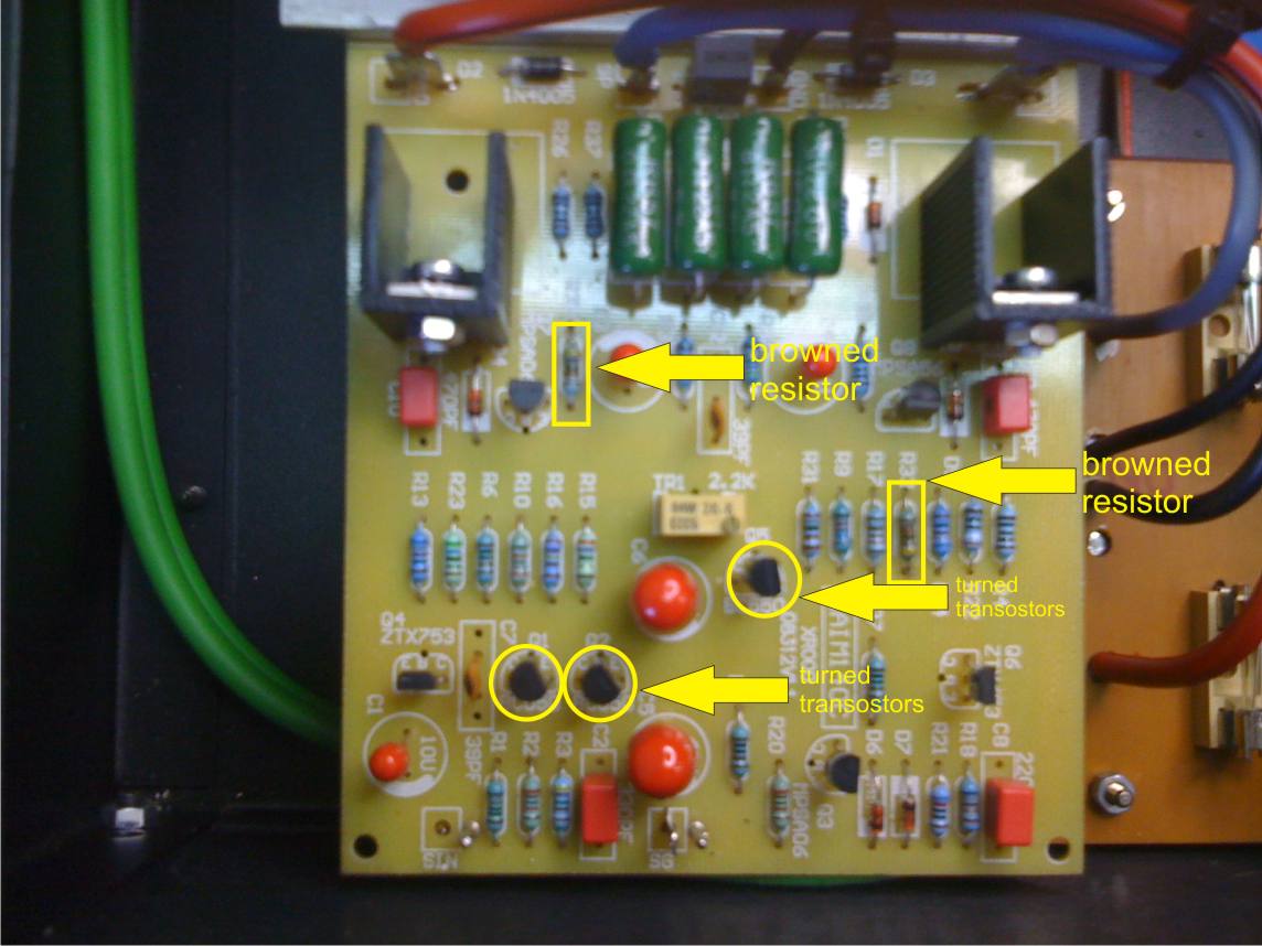

i attach some picture ...
maybe could be useful to find the problem...

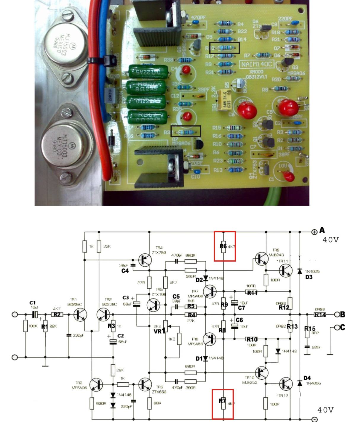

hi guys i have a question. My Homemade NAP140 has a problem assembled in 2010.
The resistors R6-R7 (on both channel) are blackened, browned and very hot when you touch them. I state that the amp works but I think it's a symptom of some problem.
Can someone help me?

No easy answer . The wattage should be about 0.4 Watts and the resistors look to be 0.6 Watts . The Vishay resistors below are sold by many and are small . They should hold together for further testing as they are 1 watt types . Try to get hold of an oscilloscope . There should be no large waveforms across the resistors when no music playing . Also test the output . Do check that you only have 40 V ?

Hi Clariello
The resistors you marked, with R8,9 set bias for the VI limiters (TR7,8) circuit and should not carry high current. Unless you have shorted or wrongly fitted transistors there. Still, you should be able to remove the limiter transistors and run the amp without them as many DIYs, in fact, do.
Though designs have changed since 2010, you might tell us who supplied tbe board because the parts supplied may not have matched the overlay with older kits, so check the pinout of the actual part number supplied against the PCB overlay and tracks to be certain. Many people had problems with some substitute transistors that may have worked, if the transistor was rotated to suit. Of course, once blown, you can't fix anything by changing position. 😉

I bought only the PCB on Ebay (Tubehunter) and i bought all the components on RS-Components,Distrelect,ecc....
I used original schematic diagram transistor except for BC550 (i used Toshiba 2SC2240L) and output transistor (i used MJ15003 ON-Semi)

Just the transistor would be fine . I notice you say about different transistors . The pin out is different on 2SC ( base , collector , emitter . I am sure you would have checked that ? )

Ok, It's good you are aware of the problems with Ebay kit PCBs. As nigel agrees, it would be OK to simply remove the TR7,8 to eliminate the limiter circuit from the problems and replace the resistors only if you wish, then test the amp operation, set a low output stage quiescent current for initial setup and measure any DC offset at the output. Stop now if there is a problem.
I would first pull the fuses and place 100R resistors across the holder to limit fault current a bit. Set the output stage bias to 30mA (measure by mV drop across Emitter 0R22 resistors. Then verify the Bias current shared through the LTP and VAS transistors by measuring voltage drop across a series resistor. You should have about 3mA and 7mA in each path respectively. BTW, what are your rail voltages?
Removing the protection is a known mod on the original Naims. However, they do of course know that their amplifier is working on spec - it normally takes a very long time for things to go brown when worked hard, so it suggests something is a little off here.
38mA at the power supply end after 20 mins powered is the easy way to test the bias. Connect your meter in line before powering up and don't mess while powered up!
Then check no more than 50mV DC offset.
