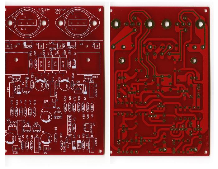

it came in today’s post 🙂
beautiful red PCB with gold plated pads 😀
but perhaps I slightly modify the schatics for better decoupling VAS.

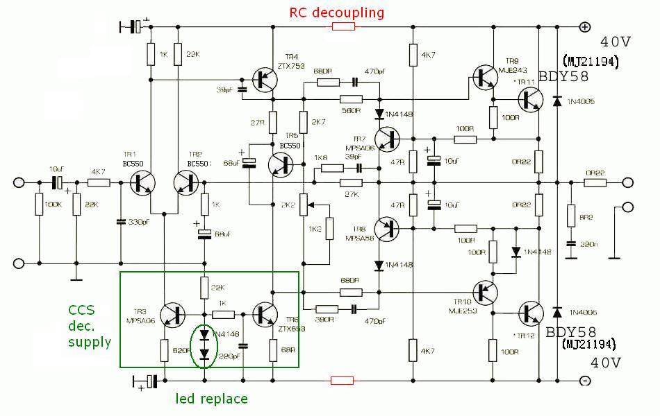

Does anyone have a high resolution copy of this schematic? The transistor types are not labeled on the board and I didnt get a schematic with my kit. I have tried to contact the seller many time to no avail....here if the kit i am referencing

If you have one and could email it to me that would be great...
I need to be able to cross reference the Q1,2,3....etc with the transistors given in the kit...even a list of which transistor types corresponded to the labeling on the board (Q1,2,3...) would be fine too...

what types of transistors are supplied with kit ?
Schematics is almost always the same type. 🙂
Pheraps (im not sure) :
Q1,Q2,Q5 = BC546
Q3,Q7 = 2N5551
Q8 = 2N5401
Q4 = 2SB647
Q6 = 2SD667
Q9 = TIP41C
Q10 = TIP42C
Q11,Q12 = output 2SCxxxx

This is LJM's board as advised earlier. It is sold by many Ebay traders. If youi visit Tubeshunter, Along1986090 shops for instance you should find a schematic posted there. Beware the original schematic which may confuse because parts are all original types.
If you read this thread, you'll see several schematics posted by people with the same question. I once found my schematic as an email attachment with dispatch confirmation - didn't see it for weeks! Since then, it's been on the sellers item description page. Look around.

I was able to figureit out using some schematics I goggled....mine has the B647/D667 types you mentioned but in place of the TIP mine has a A1930 and its complement type (dont remember offhand).
So would it be of benefit to find the ZTX type and replace the B647/D667? can I just drop them in without changing anything else?

in place of the TIP mine has a A1930 and its complement.......
......So would it be of benefit to find the ZTX type and replace the B647/D667? can I just drop them in without changing anything else?.....
....I happen to have some MJL21194 (i think thats what they are), would those work better or at all?......

Reverting to original parts is not simple, US pattern for small parts is EBC and Japanese BCE. Just check data sheets by Googling the part number and selecting your favourite free archive site. Try Datasheetarchive and pick a reference with enough detail to give diagrams. Single page lists only compare specs.
MJL 21194 are great TO3s but only 10% of Toshiba 2SC5200 or genuine Sanken 2SC3858 speed. This will kill it in the water for having a Naim sound which relies on having maximum speed trannies throughout (you have fake 3858s) This has all been discussed in recent pages. Please read.
IMO any transistor will improve on TIP41/42 as drivers. They work and reduce concerns of excessive gain and oscillation that could occur using modern drivers, but really don't allow the speed required. The original MJE243/53 are a minimum, I would think. Compare Ft of transistors, this is the transition frequency by which gain has dropped to zilch.
