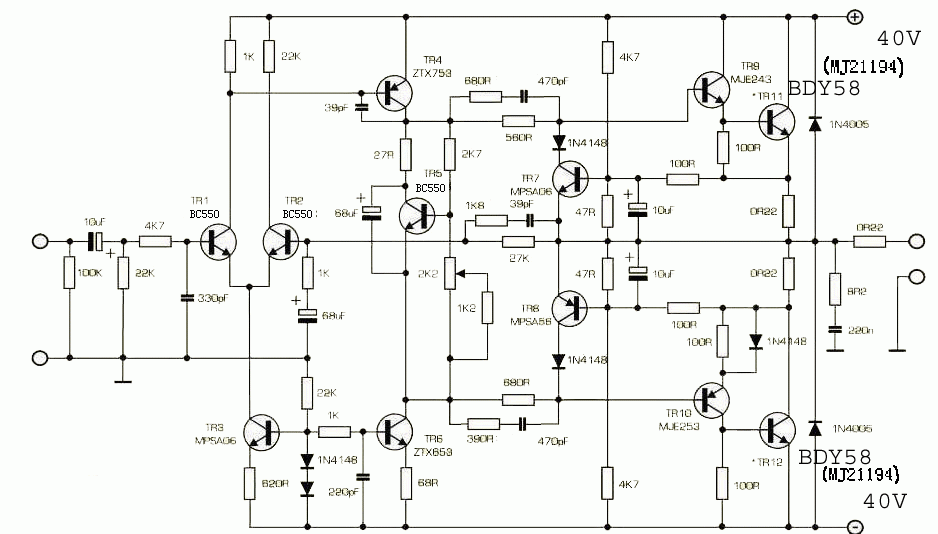

thanks for the advice schematics from seller is attached.Hi, It seems you like the metal output transistors and MJ21194 are about the fastest common types but nowhere as fast as Naim parts or the Sankens or Toshibas offered in the kits. This is a very important element of Naim sound and you really need faster parts than those you opted to substitute.
The "predriver" or actually VAS transistors are not capable of the dissipation required with 40V rails even. Any small TO92 or the E-line ZTX types are on the limit with 1 amp max. current rating so a small-signal type like the MPSA 42/92 will not deliver full drive without smoke. If you can't use the Zetex types, you'll need TO126 video drivers like KSC 3503/KSA1381 from Fairchild. As discussed in many threads, they must have very low Cob, very high Ft and Vceo needs to be at least 100V.
It's fun to make substitutions but it is better not to cause problems or spoil a good thing. Sure, some people want to try the NCC 200 style amp. which is a different sound using some common parts but as modules, you could expect some part matching you perhaps didn't anticipate.
BTW, quite enthusiastic power predictions there - if Naim ever got near them, they would have been amazed! 😉

If you go to the Avondale site, you'ii see the NCC 200 differences are more. For instance, a coil is used in the output for stability. When you change an amplifier and its compensation in particular, stability is affected. That version does need it.
If you understand audio design and how to stabilise a power amplifier both electrically and thermally, fine but very few people do and many just simulate until it works acceptably with generic models. In real life, the audio may not be so good or thermal runaway destroys it at some time in the future.
The design you posted is a generalised original Naim drawing covering all models at the time and includes the VI limiters TR7 & 8 which clones do not. I understand that no amplifiers were never exactly to this published design.
There are many choices for substitute parts and I have changed quite a few types for people who wanted to try something else. BC549B,C or 550B,C are generally used at the input and best matched for beta and Vbe as well as possible. This is easy with a suitable DMM. In most cases of substitution, remember that increased beta, Hfe or gain leads to instability. Sometimes it is critical. Check for overheating of parts and the output stage when playing roullette with parts.
The other semis can be BC546, 2N5401 etc. for MPSA06 and TR5, the Vbe multiplier. The drivers need something - anything better than the clone's TIP41/42! There are several good drivers but I found no improvements over originals MJE243/53.(some high-gain types caused oscillation) The problems are VAS and output types and whatever the rationale, slugs like MJ15003 power transistors just don't work properly in the clones. IMO, if you listen with genuine Sanken or Toshiba high Ft types, the difference to the sound in an otherwise capable clone will be obvious and more exciting, if I can put it that way.
If you read back to Ruwe's posts, you'll find a lot of experience and good advice there. 🙂

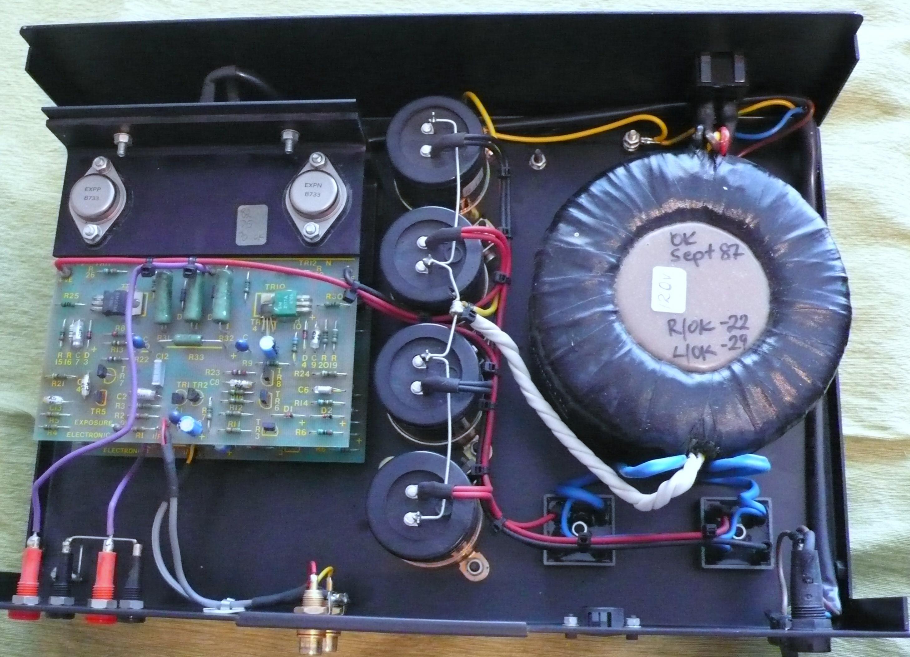

This is commercial amp from Exposure ,model Super VIII 2x55W from 87'. The amp was manufactured trough the 90's I guess and brand has quite a following in Britain. It is said to sound as well or a little better than comparable NAIM pieces and it's built in similar way. Naim has much nicer casing and sexy glowing logo 😉
I mention it here on Naim clone thread so you guys don't pass it when you stumble on it somewhere. Since it's a niche brand and doesn't have quite following like Naim the prices are reasonable. Company still supplies parts and service , just like Naim.
