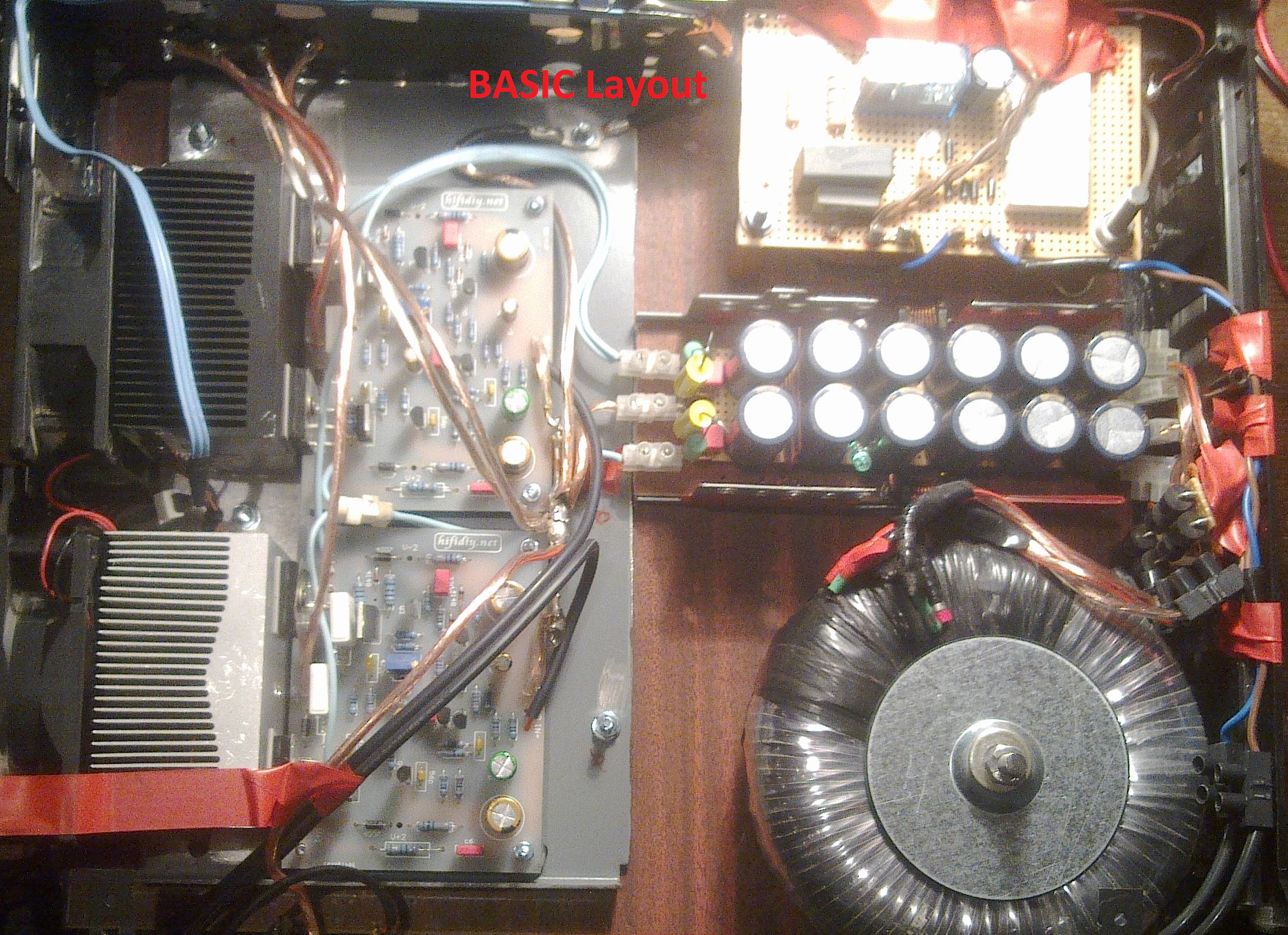

"the sound quality was awful.. ". What was the most common mistakes about the awful sound? Can you give some hints for control our circuits 🙂Some years ago, I was helping some local schoolkids with checking parts and getting their Ebay kits working, making the bias setting correctly, stable and so on. The case was the last and generally most expensive part they considered (if at all) so some had watched as their builds overheated, burnt or even if everything survived the first power-ups, the sound quality was awful with the board and power supply just lying apart on the desk. They figured something must be wrong with Naim styled kits or blamed the semis because typical emitter-follower designs seemed to work and bias could be adjusted with only a small heatsink or adaptor plate in use for testing.
Schoolteachers didn't seem to understand or even recognize that Naim's QC design was a valid topology either so it came down to doing a demo with references to Rod Elliott's articles on output stage topology at his ESP site. Maybe others here will gain some insight from reading the main article too: https://sound-au.com/articles/cmpd-vs-darl.htm
The most common mistakes are simple wiring errors, especially grounding paths. A ground wire is a long inductor + resistor and one end is not the same connection as the other end. There are grounding strategies like a star wiring, but no set of rules is a substitute for being aware of the ground currents, their magnitudes and waveform. Then there are gross errors like getting parts backwards, and using the wrong resistor etc. Unless you are an expert making a very expensive amplifier, the quality of the parts is not your problem. You cannot spend your way to success, except perhaps by hiring an expert to do it for you.

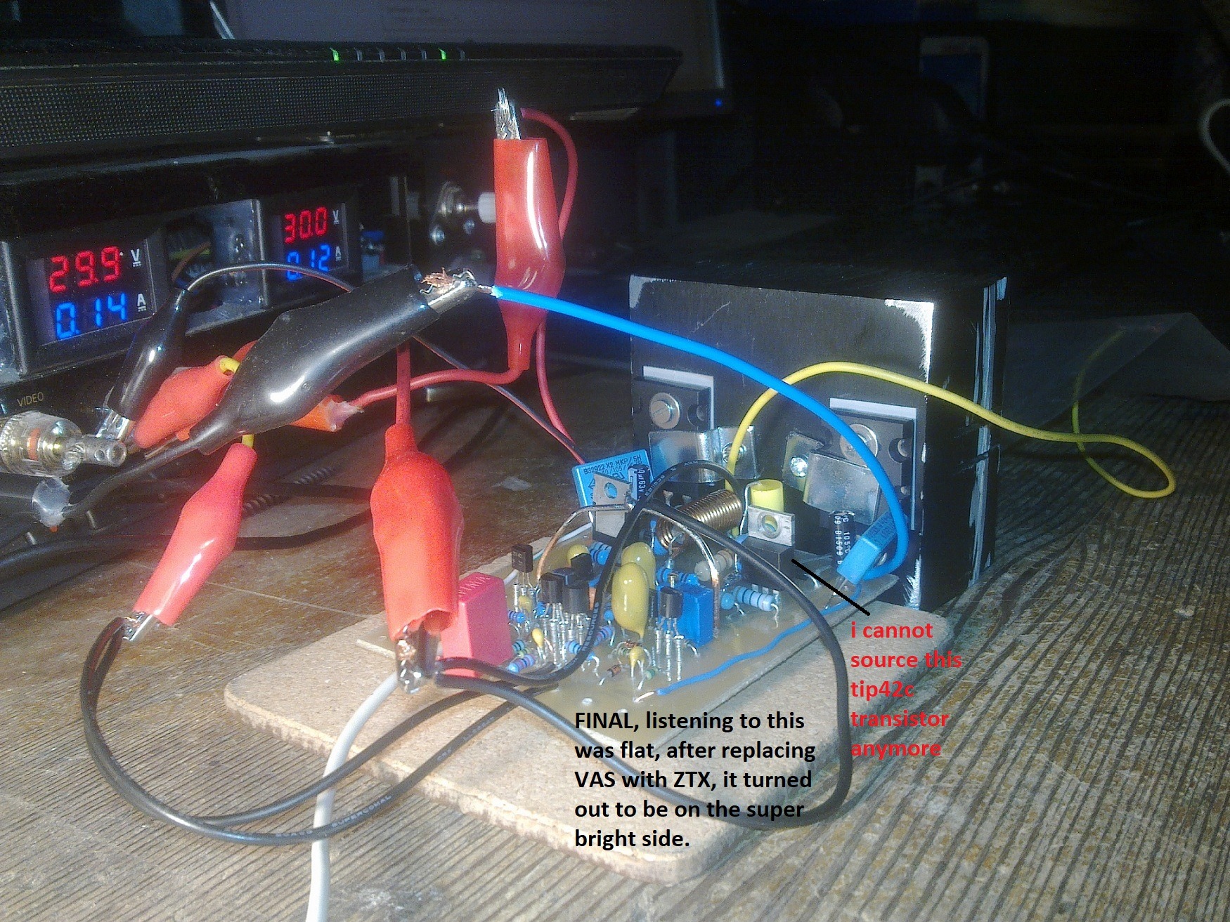

Expanding on the kids' problem mentioned earlier, I found they were likely to omit expensive, hard-to-get items and use cheap, inappropriate materials like MDF as an open-top surround for their amplifiers, for cost, availability and simply because the internet showed images of what others had done - no matter that they were a bad idea. So now there was virtually no bias control path via the air and it just drifted with the ambient temperature, to some level between useless and hellfire disaster where the sound quality is less than pleasant.

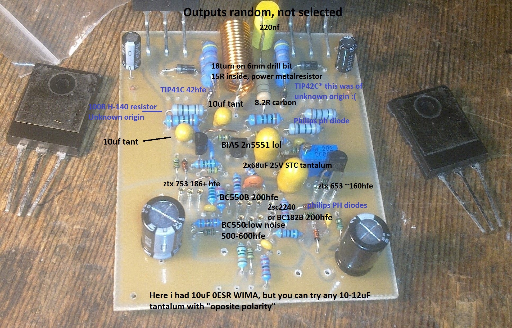

ZTX (VAS) transistors heat the all board. Also power transistors. All PCB temp. is not lower than 30-40C (room tempr. 22C). I believe this is not an accident. I made bias nearly 5mv (for one 0.22ohm). http://www.acoustica.org.uk/ says must be not less than 4.5mv. (make sure your Naim's output stage displays at least 4.5mV across a 0R22 emitter resistor that is, Iq around/up to 20mA..). I think there isno problem about bias and heat of amp.
I'm thinking about the transistor's effect in frequency range (or sound qualty) of the amp. I mean is it necessary to find low noise transistors in bc550 or bc239 or is MJE15030/31 or ztx's characteristic (Hfe or others) are important. Do I have to find the true BC550 🙂

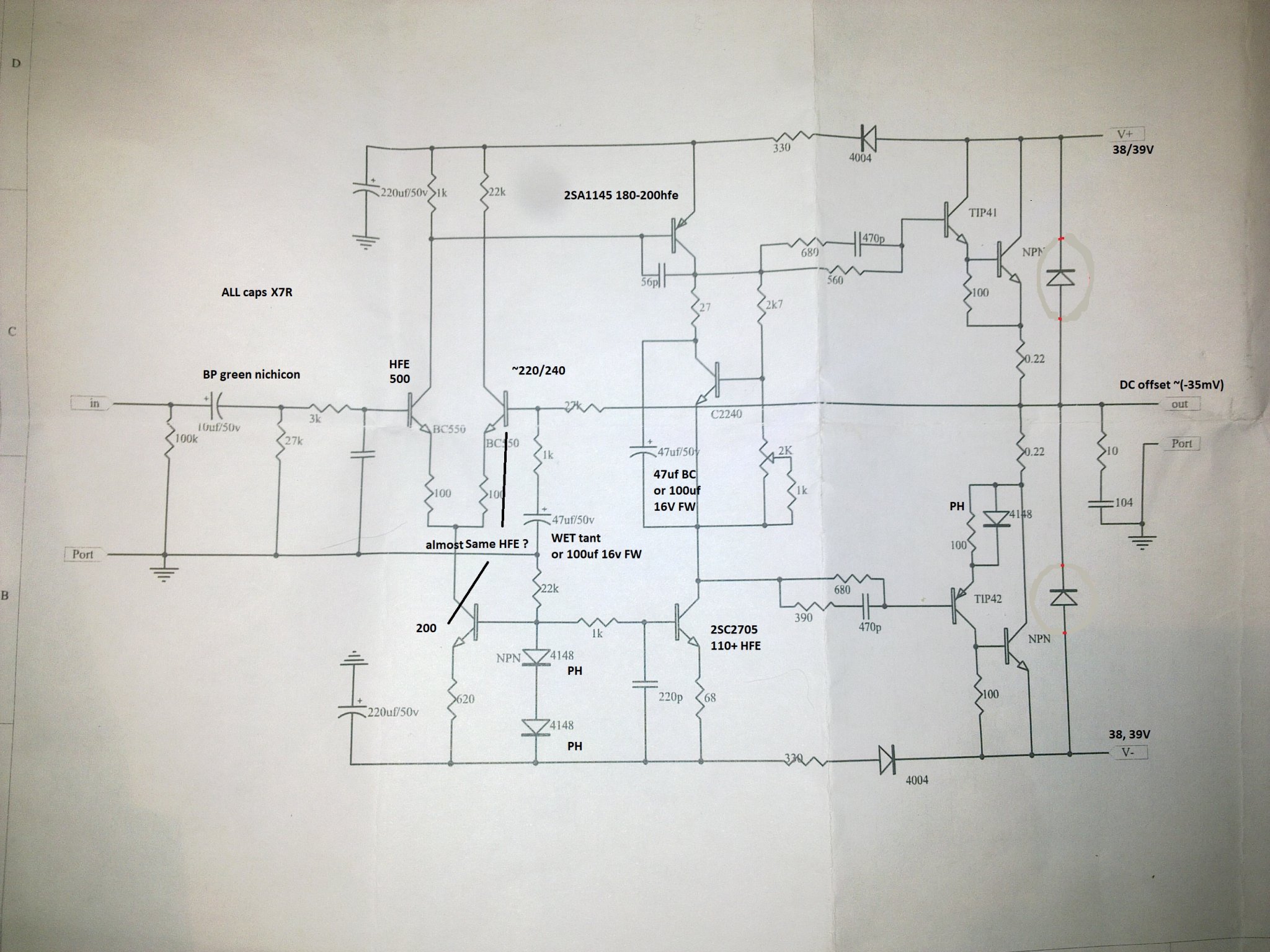

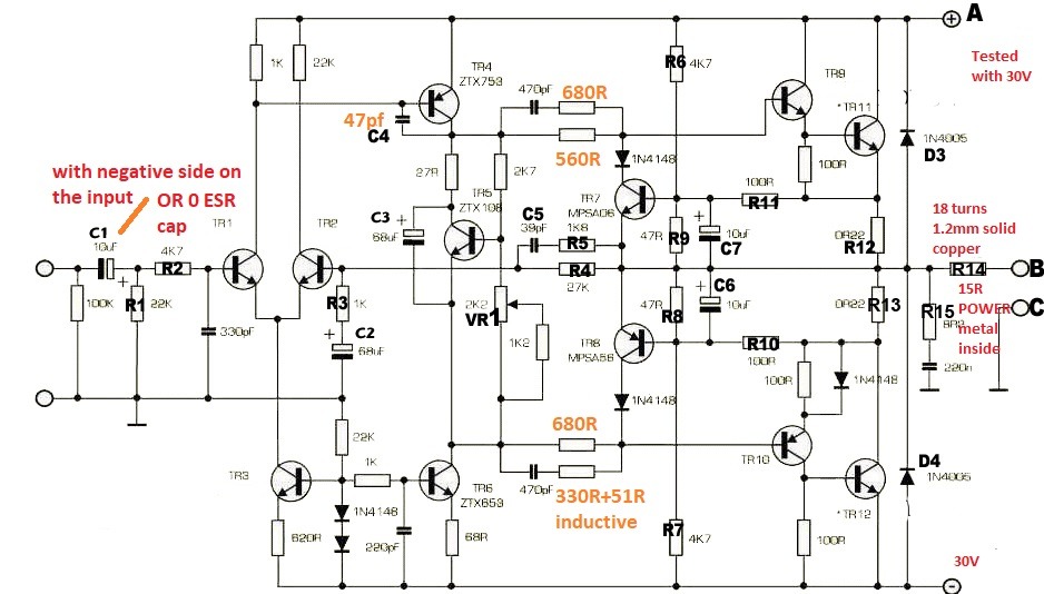

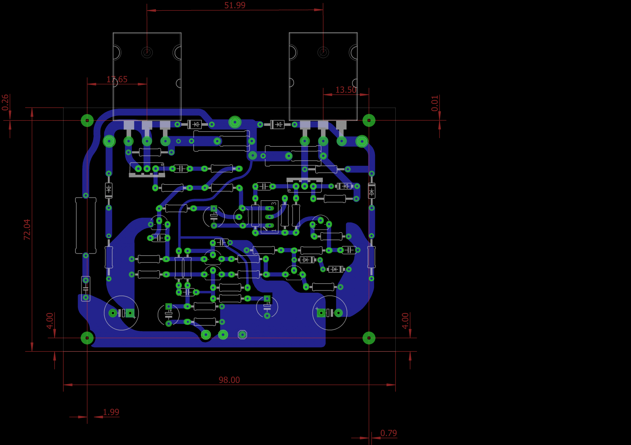

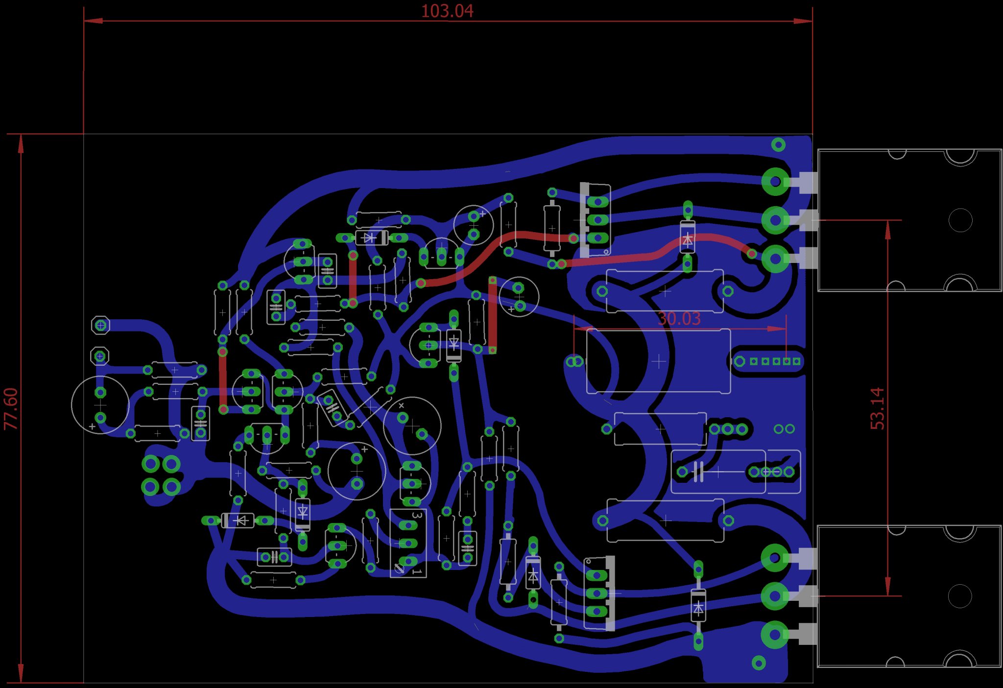

Okey,
1. Layout of NAP140 or 250 whatever model.
2. Layout for H-140, known as clone.
Both worked well with "TIP 41&42 as drivers.
all the PCBs we need, everythings calculated - trace inductance, reluctance, capacitance, resistance, differentials, everything is in place.
1. NAP250 layout: Most important transistor is VAS, ZTX 653 and 753.
Layout is the key.
2. H-140 layout. good one.
Use only 2 pcb layout drawings.
Next is to build the thing by the layout shown above or super close to it. If we do this it will get us somewhere i think 😛
If we dont follow these concepts, we get stuck i think 😀

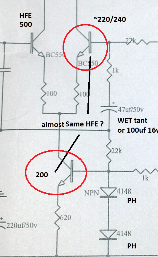

I have tested input transistor types, yes, low noise is a good choice for the first one. But it depends 😀 Basically i think we cant build Amplifiers through the forum... we can but we cant make any statements.... i just dont know what are u talking about and its the same for the opposite person.Do I have to find the true BC550
Maybe with just 2 layouts we can figure it out somehow ?
For example, is it important to find same Hfe power transistors?I have tested input transistor types, yes, low noise is a good choice for the first one. But it depends 😀 Basically i think we cant build Amplifiers through the forum... we can but we cant make any statements.... i just dont know what are u talking about and its the same for the opposite person.
Hmm, atleast to me it seems that using same HFE for 2nd input transistor and CSS is good idea... i have tested it many times, it feels alot cleaner if same HFE is used // but i think it was somehow dependent on my powersupply
There is that "front end" concept too. Its a tricky part... it is temperature, time and ultimately output bias dependent scenario..
Making them equal is cleaner sound but its not just this part of the amplifier, this is a small portion of this tuning... its unknown...
We need Layout... wires, distance, powersupply....
There is no such thing as if something is better or not... ....
But, this NAP250 pcb layout worked quite well... and i dont know why... 😀
Its scary guys 😀 but i love it, it creates a question in ur mind... why it works if it works... and there is no simple answer 😀 makes u think for a longer periods of time, feeling of creativity is born... thinking not thinking at all
