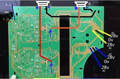

Hi, I'm trying some Nap140, 250 kits. changing the elements ect.
lastly, I bought a kit nap200 from aliexpress. I didn't modified or change any part. It's nearly good as my old old kits. If someone here tried, please comment did you like? I will not write any link. I will post a pic. from the side.

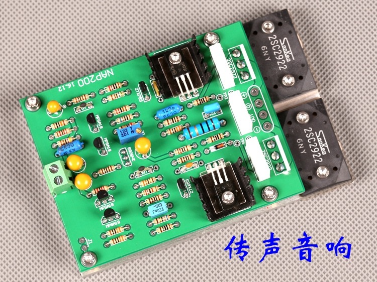

Kit has some little changes like added two more caps. 2X100n&uf caps. Other all elements are the same as pic.. And no cooler. Note that, offset nearly 1mv, Bais total 11mv. Perhaps all but, I see Power transistors matched.

After nearly 2 hours run, power transistors are getting hot. My NCC200 is very cool at the same time. Perhaps need bigger cooler or it oscillate? VAS cap is very big as 80pf on this nap200.Hi, I'm trying some Nap140, 250 kits. changing the elements ect.
NAP200 is rated 100W/channel at 4R speaker loads. So yes, it will get hot and will burn without some form of heatsink and (originally) a thick heat spreader bar because the relatively thin case itself is the sink. The case is minimum 3 mm thick aluminium sheet in the form of a standard 2-unit rack size box. All NAP models use their case as the heatsink so you won't find any separate finned cooler in genuine product.

Nap200 left channal & NCC right channal. Nap200 output transistors, connected with heatsink grease on the L shape 3mm aluminium heatsink. And heatsink connected to 400gr aluminium another heatsink with NCC200. Connections made like your image.
NCC200 has been tested more than continuous 24 hours. But, Nap200 getting hot after 2 hours. This is one channal of amp.. Volume is not full, it's very quiet (or no input). MJ15003 is 250w and 2SC2922 is 200w transistors. Both, drive by 41.7V ( transformer nearly 30v). I don't expect that much heat 🙂
Assuming no wiring errors, have you measured and adjusted the quiescent (bias) current correctly? Bias current is what generates heat so that needs to be set correctly and the Vbe multiplier transistor (marked 2N5089) located underneath the PCB) needs to be right next to the heatsink to regulate it properly. The bias test points TP1,TP2 may actually be across both emitter resistors in series, in which case the 1k potentiometer should be adjusted for about 12-15 mV voltage measurement. If TP1 and TP2 are across only one of those large, white resistors, a voltage of only half that (6-8) mV should be set. Don't confuse those 3 resistors - one of them is simply in series with the output connection and has nothing to do with bias setting but you should first check and note what the voltage (mV) reading is before adjustment. You can use the NCC200 schematic for guidance as this will be virtually the same as NAP designs at the output stage.
Your power supply voltages of about +/- 42V will normally be this high with no output or load, so no problem, as long as your electrolytic capacitor ratings are at least 50V.
I drop the bias as 3.5mv x 2. Now it's better. Before, I measured the bias from the wrong points (TP1, TP2.. on my picture).Assuming no wiring errors, have you measured and adjusted the quiescent (bias) current correctly? Bias current is what generates heat so that needs to be set correctly and the Vbe multiplier transistor (marked 2N5089) located underneath the PCB) needs to be right next to the heatsink to regulate it properly. The bias test points TP1,TP2 may actually be across both emitter resistors in series, in which case the 1k potentiometer should be adjusted for about 12-15 mV voltage measurement. If TP1 and TP2 are across only one of those large, white resistors, a voltage of only half that (6-8) mV should be set. Don't confuse those 3 resistors - one of them is simply in series with the output connection and has nothing to do with bias setting but you should first check and note what the voltage (mV) reading is before adjustment. You can use the NCC200 schematic for guidance as this will be virtually the same as NAP designs at the output stage.
Your power supply voltages of about +/- 42V will normally be this high with no output or bload, so no problem, as long as your electrolytic capacitor ratings are at least 50V.
It's good that it was just the bias setting which, in your terms, would be specified as ~7mV x 2 but this is not critical with a quasi-complementary design like this one. It just needs to be enough bias to sound like a good compromise between say, harsh and sweet sounding. I assume you bought the kit of parts version so it would always be necessary to make that adjustment yourself, after assembly.

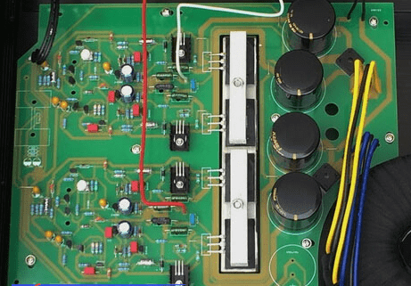

Bias settling and stability depends on heat from the case warming the air that flows up to the 2N5089 transistor which as said, is mounted on the underside of the PCB to minimise the thermal settling (warm-up time) and hence reach a relatively stable bias level within a reasonable time of a few minutes. Just be sure to use a transistor with the correct pinout if you substitute or use fakes for some reason.
The pictures of the full-sized clone and real NAP200 show you that the thermal design is all very simple and requires no special parts at all but the closed box case is an integral and important part of the NAP design. Just assemble the kits and mount them inside a case as shown but don't assume you can just couple the transistors on a common heatsink to solve the thermal delay problem. That generally does not work at all for quasi-complementary designs because the increased heat transfer over-compensates and reduces bias too much and the amp may also become unstable. The original design using air as the transfer medium works more or less correctly and safely as it has for more than 50 years - and as long as the components are arranged much as they are in the original NAP200 design examples.
There will always be a few minutes delay before the amplifier settles to its optimum bias level and operating temperature but that won't be too obvious a problem. You may notice small improvements as it warms up more and your own hearing also adjusts to suit the program.
