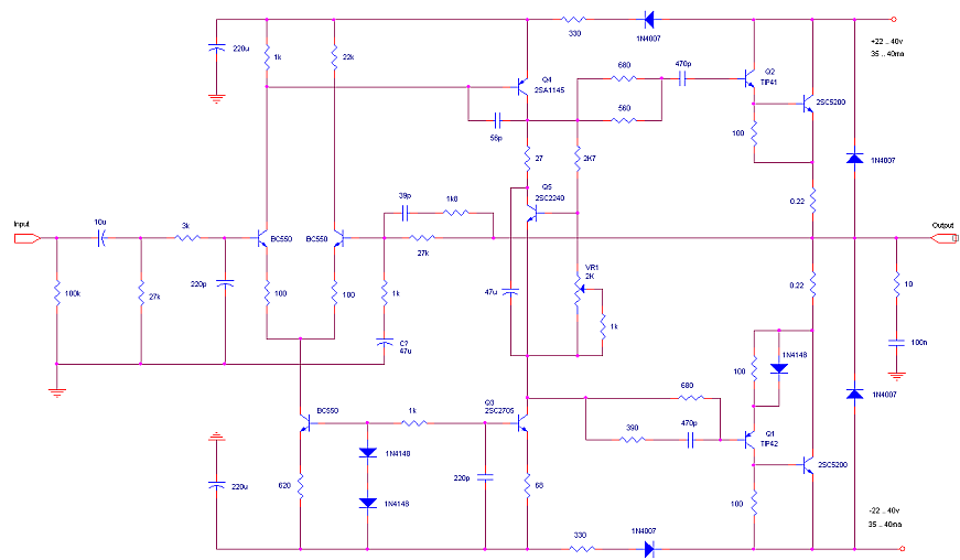

Sorry to revive a rather old thread - but I bought this same kit about a year ago (maybe 18 months!) and have just got around to looking at building it.
I wasn't supplied with a schematic, and I was happy to find the copy you had posted. Mine differs slightly ffrom yours, in that it has two additional components in the feedback loop.
My board also has all component values on the silk screen layer.
I preapred the attached schematic, based on your poseted schematic, and comparing that with my PCB.
Tony.
EDIT: I can't seem to get the schematic clear here..
EDIT: Embed image.

Hi marcel5996
I may be a little late, I don't read the forum very often, but the first thing to check is where you attach your speaker. Of what you're saying it looks to me that you have connected the speaker between the negative power rail of your board and the ground (or from negative power rail and the speaker output). This way you're shorting through the speaker the negative rail.
If your amp is stable without load then your load is the problem. Check where are your terminals attached on board.

Hi Tony
I think there is a small error in your schematic. The upper driver base is connected through a 470pF capacitor only. Probably this network has to be the same as for the lower driver. I hope the PCB is Ok.
Hans
807 said:
Hi Tony
Hans
Hans, Indeed there is an error with my schematic!
Well spotted - the upper network should be the same as the lower of course.
The PCB as supplied is correct - that was just my mistake.
I will correct it and repost the correct schematic.
Thanks,
Tony.
EDIT: The correct schematic is now displayed in the post above. The attached schematic is still wrong however - I could not edit that.
