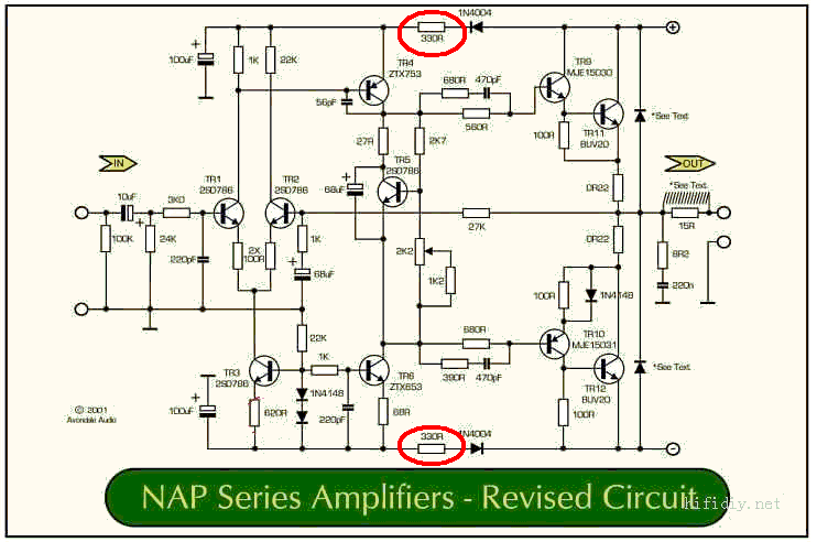

Hi guys,
Firstly, I have been building several kits from Gigawork too, thanks to lots of mods and guidance from this thread!
One of the kit is used to rebuild an old sansui amplifier. For personal reason I want to maintain the existing transformer but however, I ended up having +/-53v DC power supply. The input transistors (BC550) are not rated for this higher voltage.
So I'm wondering if I can modify the circuit as per the attachment. Can I change the 330R resistors to a higher value to drop the rail voltage? If yes, what is a suitable value to replace here? Will this effect the feedback orr something? (Im not an EE so need help with calculations)
Thanks in advance
Thanks in advance
skyraider said:Can I change the 330R resistors to a higher value to drop the rail voltage?
No.
I think you can use BC546 instead of BC550 which is rated for a higher voltage (ie 80V)
