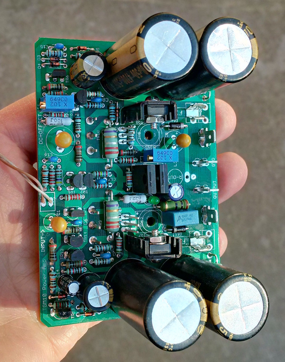

Hi Gabor,
LOL. I have a feeling that you are drawn towards amplifiers with thermal problems - first your 20yr favourite with Darlingtons and now the NAP 🙂
I decided to fix the thermal issues with the NAP amplifier properly. You can find the design here: http://www.diyaudio.com/forums/solid-state/302454-tgm10-based-naim-julian-vereker.html
I used tantalum caps from Digikey, I can look up the exact part numbers later if you want them ? You can see them in this photo, they are the smooth round orange blobs. I may try a bipolar device in the feedback circuit before I finish the project.
For the output devices I used the very fast Sanken LAPT device 2SC3263.

Hi Gareth
I built several NAIM and NCC Clone newer had any issue or thermal problem..After warm up they are rock solid.
Why do you think I'm going to have thermal issues.
The MJL4281A I used not a slow transistor either.
If you look at the Naim 140 or 250 Bumper some of them built with the fast Sanken 2SC2922 device. Se the picture.
From the beginning (started with Ebay clone) I used electrolytic caps really don't know the the tantalum V and uF ratings.
Right now my clone is dis assembled I never took any measurement. If I am right Tantalum comes in low voltage.
I can search on the NET but it is a big difference someone already built and tested it maybe with different type and values and did some A/B listening tests.
By the way you design a very nice compact PC boards. It is lovely.🙂

I read that the thermal control is made in the original NAP by having the Vbe device sitting in the warm air of the enclosure and takes some time to stabilize. I guess it must work because many units were built and they survive to this day. But I felt it should be better for the Vbe to have direct physical contact with the hot devices so I did simulations of the circuit thermal behaviour and I found that this approach would not work because it would over-compensate. So I found a way to fix that so the Vbe can touch onto the output device and provide firm, fast and solid control over the bias. I also found that the constant current source device should be in physical contact with the diodes in order to give firm control there too. As a result the clone I made has stable dc-offset and bias.
I don't know if the Tantalum is a good idea or not, I didn't compare with bipolar electrolytic yet but I should do that because I suspect the Tantalum affects the sound. I have read that it adds some low level harmonic distortion. Well, also the choice of the Vas device is important for the sound, it has an unusually high Cob. Anyhow, I would like to do a comparison, L channel vs R channel with one using Tantalum and the other with some electrolytics. I will try that hopefully sometime this summer.
