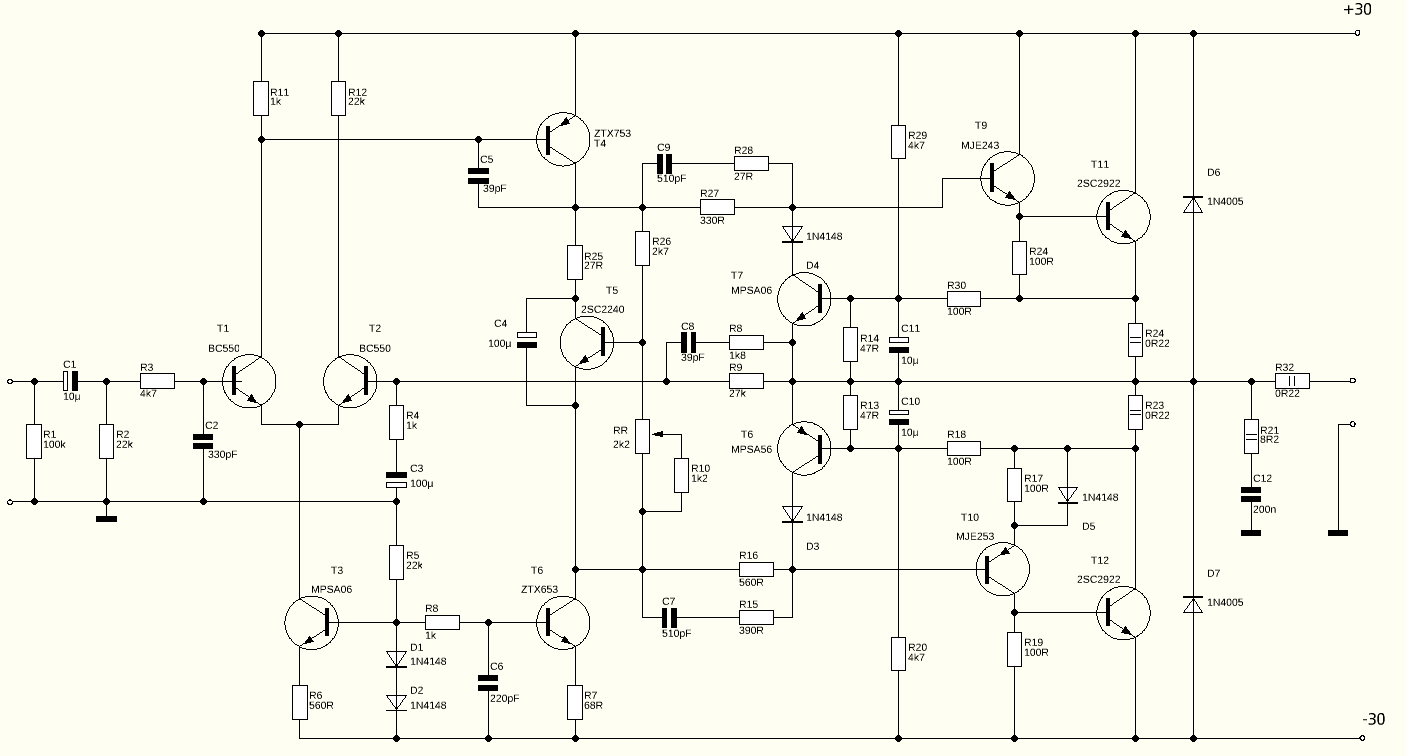

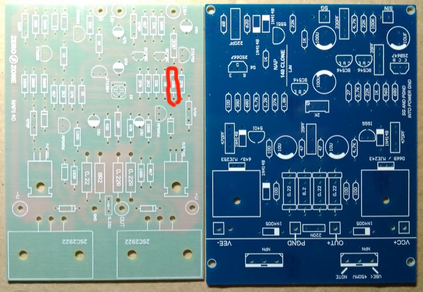

Hi!
My electrical schematic is:
I use regulator for power supply (30V).
I tested some pair R27/R28 and R16/R15
1. Green original PCB - R27/R28:33Omh/27Omh R16/R15:390Omh/560Omh. Sound is metallic. Error on PCB - R27 should be 330Omh
2. Blue PCB - R27/R28:680Omh/560Omh R16/R15:390Omh/560Omh. Sound is a lot bass frequencies and small
treble
frequencies
3. R27/R28:330Omh/27Omh R16/R15:680Omh/27Omh. Sound is "bright" and "light"
4. Green PCB without error - R27/R28:330Omh/27Omh R16/R15:390Omh/560Omh. Sound is good. Bass and treble is ok. Not "bright" or "light" sound.

Note that the supply voltage is important to the sound quality and your results may be a little different to the original products and other builders results, according to the actual design followed in these clone kits.
The blue board follows the NAP250 generic design that is shown widely and is designed for +/-40V supply rails and various older semis that were used before 1980, I believe. The green board is correct for the actual NAP140 design which uses 34V rails and components available in much later issues of the 140 model. You won't see it anywhere else, as far as I have looked. Assuming the components supplied are genuine, the sound quality should be similar to the original, even if the supply voltage is 12% low. However, there is a question over the capacitors fitted for the phase correction filters. The originals are always polystyrene types - not sure what types are fitted to the Zerozone clones. Are they axial leaded MLCC? 😕

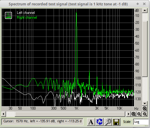

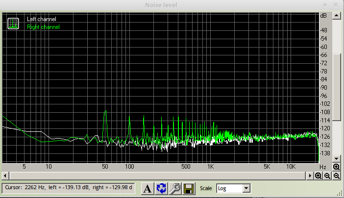

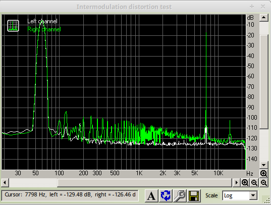

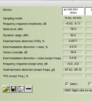

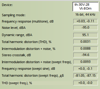

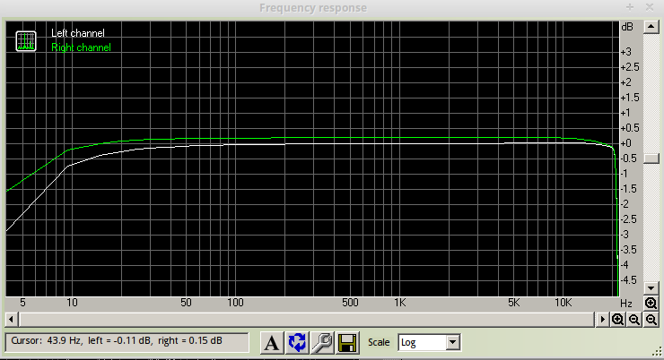

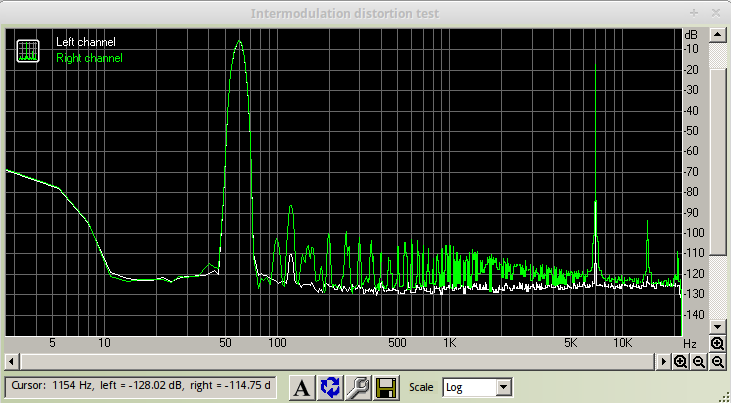

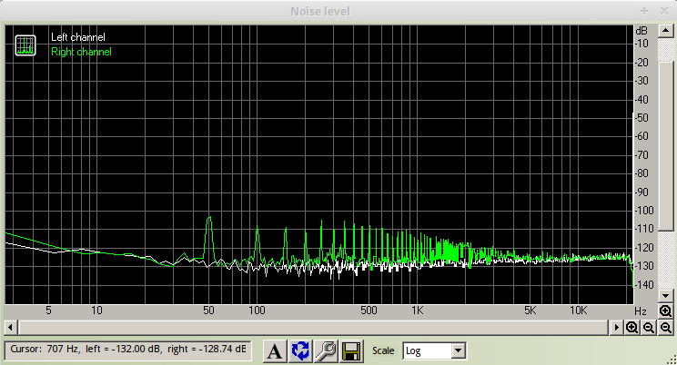

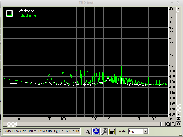

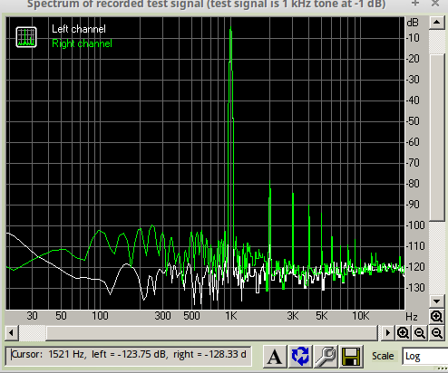

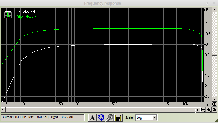

The results of tests in RMAA of my Naim 250 clone.
Only one channel test (green line - Rigth). White line is the soundcard (EMU 0204) loopback.
1. 8 Omh, Pmax=28 Вт Prms=20 Вт

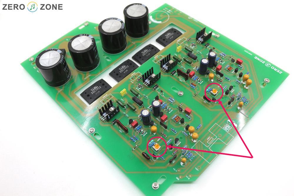

The bias setting procedure has been detailed a few times in this thread. You probably don't have any schematic to refer to, so you need to identify the output transistors TR11 and 12 and the large "emitter" resistors, R11 and R12. Don't confuse them with the similar output resistor, R14. Measure the DC voltage across either R12 or R13. It will be very small and should be set to 7mV. If your meter is crap at lowest range measurements, measure across both resistors in series and adjust for twice the voltage at 14mV, which will be more precise.
Make any adjustments promptly after the amplifier has been closed and fully warmed up. If you are running the amplifier open, it will probably never warm up and stabilise, so don't try to set it without its case - you'll be wasting your time. Build your amp like the original, where the amplifier does eventually warm up warm after about 20 mins because the aluminium case is the heatsink.
I don't know whose clone you have there and what, if any, part numbering is used. The reference numbers I've used here follow the attached schematic. Yours may have nothing, so you may have to deduce the part identities from the circuit and layout, which will likely be similar to the original anyway.
Also check out some more Naim set-up, history and other details on this site archive: Modifying Naim Audio power amplifiers
Sorry for quoting a post that's almost one year old. I don't know why I didn't ask this earlier: how do I adjust the DC voltage across either R12 or R13? Using the small trimmer pots?
