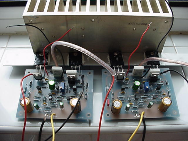

Help please
Hi, i have just built a pair of these power amps, my first go at building amps.
I have built 3 power supplies 2 of which did not work but the 3rd seems to work,so of i went to check the amps.
My problem is when i wire one amp up, no speaker connected, i try and set the VR up but i get no volts at all.
There was no bang or smoke when i wired it up so thats not bad?
While i had power on i checked for voltage which i get from the speaker out put but its 40v.
I have also checked my other amp i have built and that is the same,i touched the out put trans and they were cold to touch and the board was not warm when i touched with my hand.
I have read all the posts and there is none with my fault so i cant go and check if i have a fault or i have built it wrong.
I have also checked the ground as was said in one of the posts and that is ok.
Any help or advice would be helpfull or do i bin them?

Re: Help please
Have you connected signal ground to star ground?
Hi and thanks for the replys, i have checked the sig ground and were its solderd to the board both grounds are solderd in the same place? and i have checked it with my meter and they are connected.

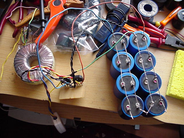

I tried to make a power supply? that looked so easy to make!!!!!
I bought 10 10,000 uf 63wv caps as i was going to use 5 per bank
My first try well that went up in sparks and one of the caps was like expanding foam and i had the plug in my hand ready to switch it off,i was to slow.
The supply i have now works? i have 3 rails 40v+ .0. 40v- the 0 or ground i fitted to the 0 rail and the 40v+ to the red wire and the 40v- to the black wire and the ground wire nr the input i put to the 0v rail.
I did not put a feed to the input as i want to set the amps up.
I also fitted two wires so i could the VR with my meter but when i checked them no volts were found and thats the same with the other board.
I will try and att some pics.
File to big?

Power supply is now sorted the right way!!!!!!! and i get the right + and - volts and 0.
Now to see if i can get the amps working?????

I am having no luck at getting them to work,one amp when trying to set the VR volts as in the manual will not go below 100mv.
The other amp there is no volts at all.
I have checked all my soldering and it seems ok,nothing has burnt or gone pop.
I am using a 35.0.35 transformer which is giving me 41v+ and 41v- and a 0 rail.
