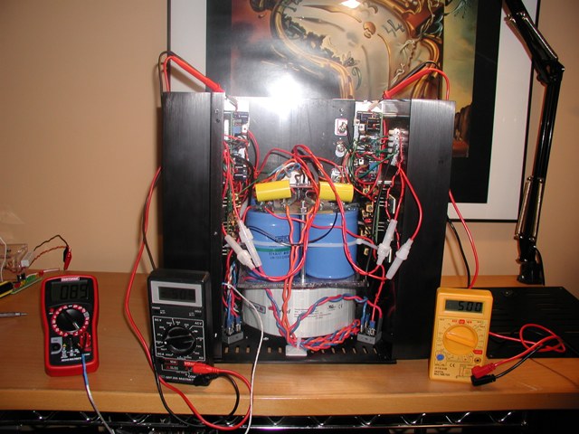

As far as the Krell, mine sounded lame after I first built it. I couldn't believe what everyone was saying about the amp. It sounded dull and lifeless.
When I was trimming the DC offset, I noticed I couldn't get one of the amp channels to drop below 350mv, no matter how much I turned the pot. The other channel was able to get to 0mv, but it wandering all over the place, and needed to be reset every time I fired up the amp.
It was then I noticed that I did not have the signal grounds connected to the power ground on the board. I connected the grounds, and the DC Offset of both channels easily trimmed to 0mv. I set the bias at 650mv (1A).
I then listened, and have been smiling ever since. Best I have by quite a margin. I may be interested in your boards if you decide to sell them.
A pic attached of the Krell "guts". Just as you say - 4 heatsinks making up the chassis.
