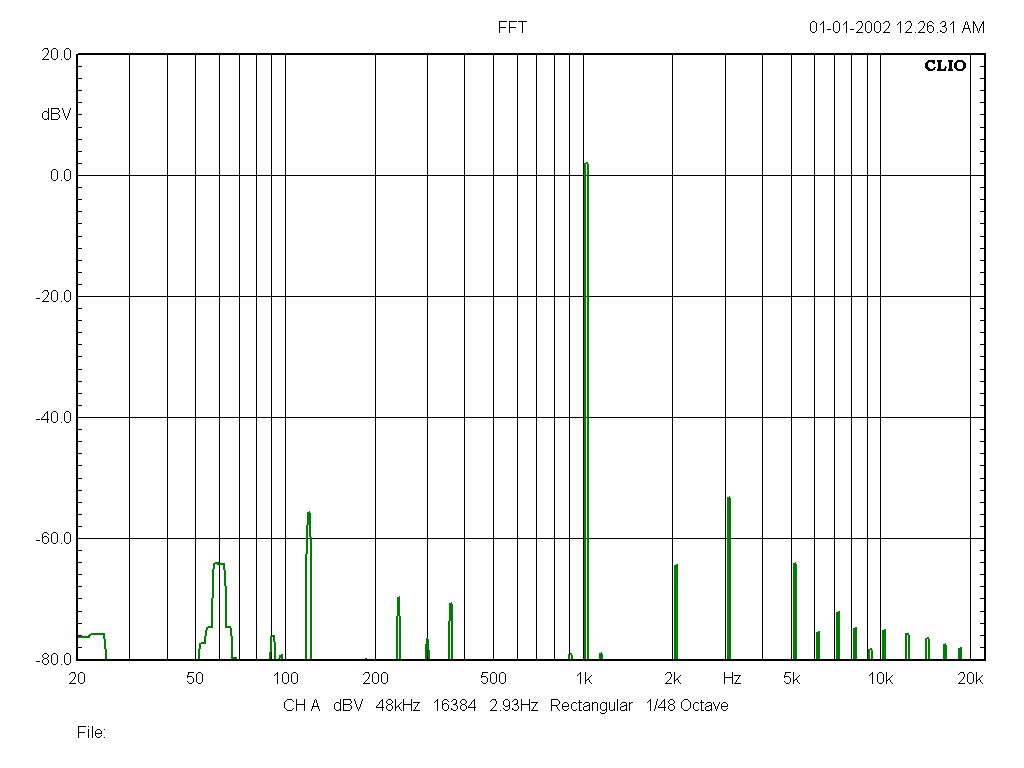

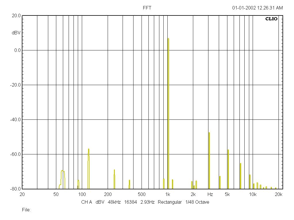

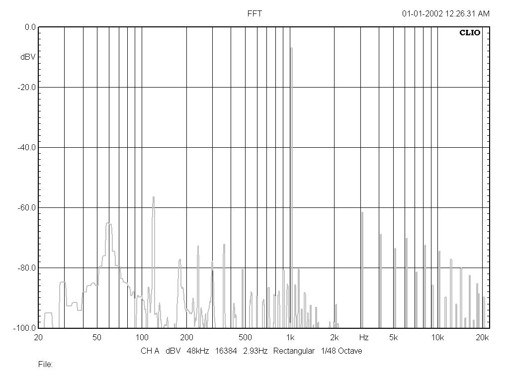

Hi. As requested spectrum at from left to right, 0.3 V, 1V, 2.83 V and 5 Vrms, in 8 ohms with my CLIO system. At 1V, with CLIO I measured 0.16% THD, but my CLIO always measure higher that the Keithley 2215-P Audio Analyser. The source in the Keithley is much purer and there is no computer pollution, probably much lower supply forethought.

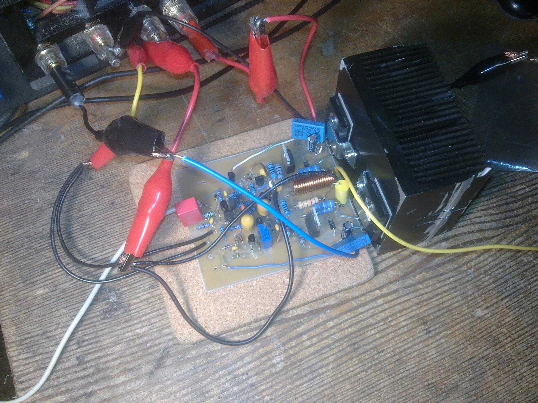

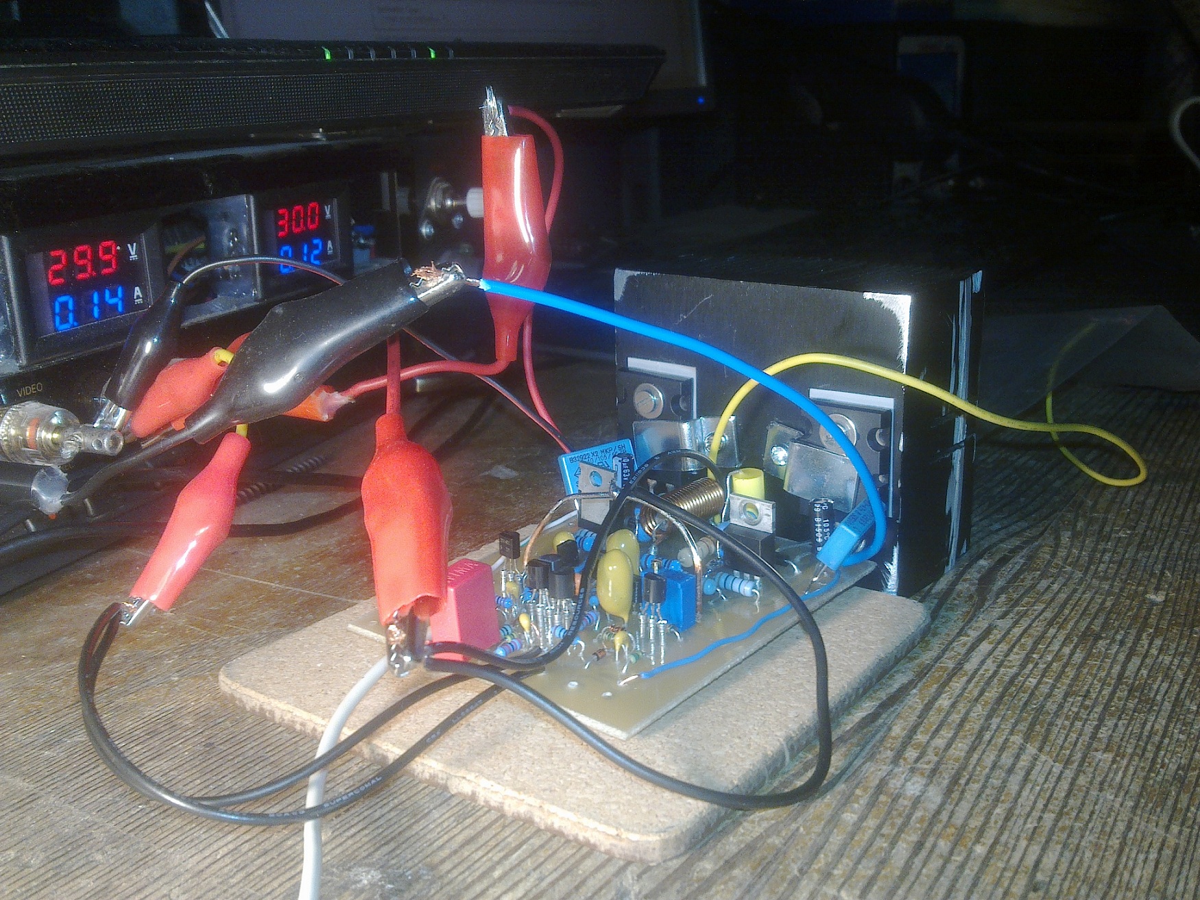

For a whole day original naim design has been playing, laboratory +/- 30V. MONO(one channel).
It is very stable with TIP42/41's as drivers, 2sc5200 outputs, VAS stage 2N5401 and 5551, bias sense transistor 5551, VI limiter transistors MPSA06 and 56.
CSS and LPT diff. BC182B and 2xBC550C(matched) accordingly.
Miller is 56pF, everything else is as in Original Design except outputs inductor ~ 0.5uH 15R parallel. Forgot, i had no 620R resistor... so 560R is placed on CSS emitter.
It sounds dam good... even on laboratory supply 😕(unusual long PSU wires).
All capacitors are tantalum except input(tant is good too here) and COG TYPE
I decoupled 2SC5200 outputs with small electrolytic (10uf) and 47nF ceramic/MKP for better EMI protection...thats all what is needed.....
Why ppl even bother to modify naim amplifiers ??? 🙁 I don't even use LPT and VAS stage separate PSU's... still, the sound, especially rhythm(timing) sooooo nice. !!!!

The Hum looks terrible @ -55dB relative to signal. The Buzz components add up to much worse.Hi. As requested spectrum at from left to right, 0.3 V, 1V, 2.83 V and 5 Vrms, in 8 ohms with my CLIO system. At 1V, with CLIO I measured 0.16% THD, but my CLIO always measure higher that the Keithley 2215-P Audio Analyser. The source in the Keithley is much purer and there is no computer pollution, probably much lower supply forethought.
I have not tested any of my amplifiers by your method, so I cannot make a comparison.
What does Hum + Noise measure when the input is shorted?
Hum aside the results are very interesting. Might be good to see one of the test oscillator. Very big thanks. If the TR4 emitter was fitted with 5R6 it would be interesting to rerun the 1V test. The NAP 250 I saw measured had more 2 nd harmonic ( 2 kHz ) than 3 rd ( 3 kHz ) by a small margin.

The big hum on the spectrum is because of the CLIO box. If I used a real test equipment, not a card into a PCB I get much better result. It is possibly ground related. No there was no 5R6 resistor installed.
There is no hum on the amp output. Measured with a voltmeter, in the mv range with no signal.
We can also see that the CLIO measured much higher THD than my Keithley Audio analyzer (a real test equipment, very low noise voltmeter to start with). The higher THD is probably caused by the large hum and other power supply spectra spikes...

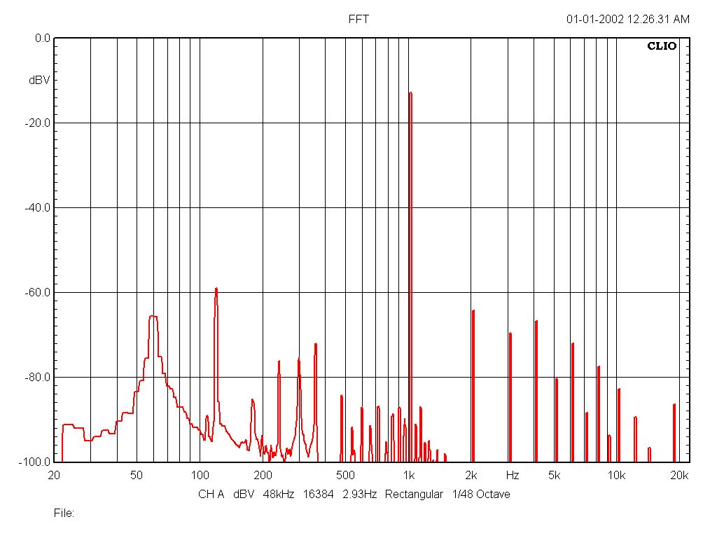

Noise. With inputs shorted to gnd, I measured 2.5mVac rms at the output, without a chassis and flying wires. It may be better in a proper enclosure.
That's roughly speaking 61 dB below one watt. I suspect it is a bit better than that ( - 80 to 85 dB ).
I regularly measure 0.0mVac using a variety of DMM set to 199.9mVac scale when the input is shorted to signal return.Noise. With inputs shorted to gnd, I measured 2.5mVac rms at the output, without a chassis and flying wires. It may be better in a proper enclosure.
If there is a problem I can see 0.1mVac to 0.3mVac.
That 0.0mVac is not zero. The average reading DMM are reporting an average that is less than ½LSB (least significant bit) and means <0.05mVac average.
This is with the amplifier and PSU lying open on the bench with a fluorescent lamp and LED lamp and soldering station on, creating a lot of noise.
2.5mVac is 50times (+34dB) noisier than 0.05mVac.
That is what your FFT is reporting.
The Hum+Buzz+Noise is abominable.
You have to find and eliminate the error in your wiring.
Your FFT will hopefully show the 60Hz and harmonics upto 500Hz, all @ levels 30dB below what you have shown in post2204.
