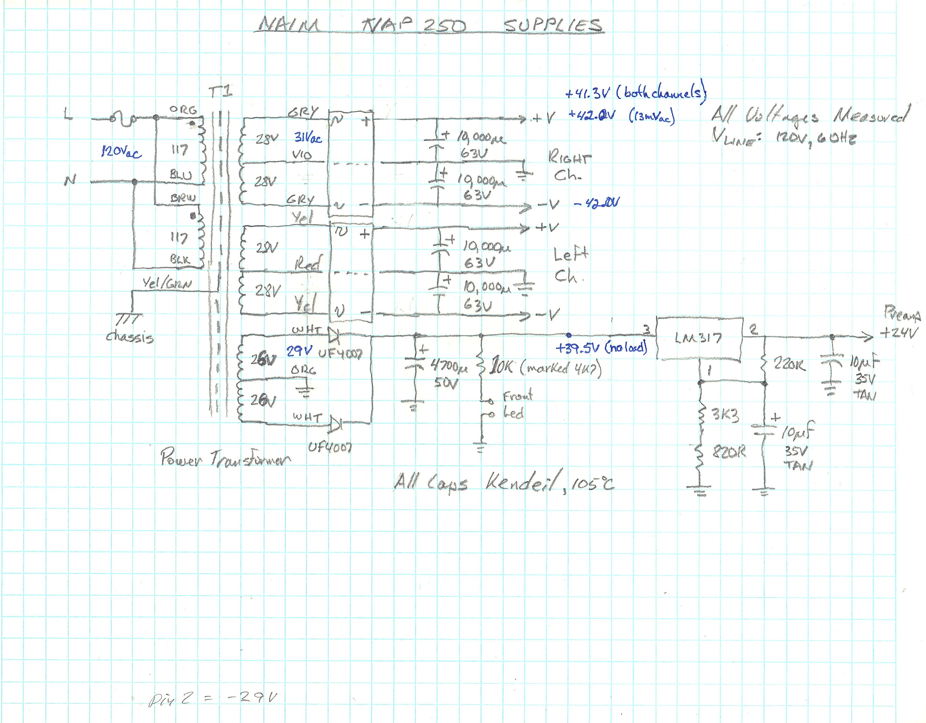

I received my custom power transformer and I'm very pleased. Transformer specs were:
Power rating: 450VA on 600VA core
Primary: 2 x 0-117V @ 50/60Hz
Electrostatic screen
Secondaries: 2 x 28-0-28V @ 3.57A rms + 1 x 26-0-26V @ 0.96A rms
GOSS band
Regulation: approx 5%
Estimated dimensions: max 75mm high
Mounting: insert in a potted centre
Leadouts: approx 400mm long flexible (stranded)
Black nylon tape covering
Here the test results with Line voltage 120V, 60Hz
Vout max (1kHz), in 8 ohms = 25Vac (78W), in 4 ohms = 22Vac (121W)
Vin max = 0.91Vac, in 8 ohms speaker load
Gain = 28.8dB
Output DC offset < 8mv
BW (Ref 1V, 1Khz) = 56Khz
THD (1V, 1Khz) = 0.01%
Supplies are at +/-42Vdc, 13mV ripple
At full power supplies drop at +/-38.8V

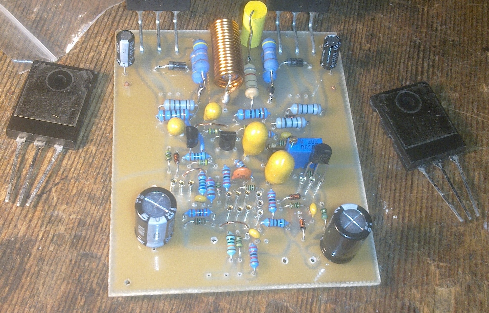

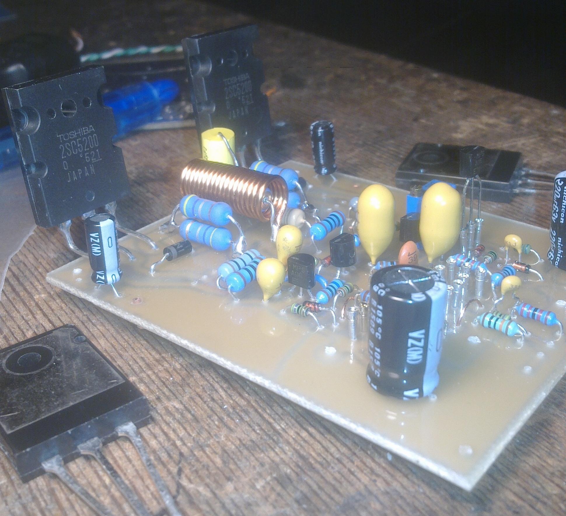

Hi, still using drivers MJE243/253 and MPSA06 as CSS with 2SC5200 outputs(h-140 modified ebay kit).
Amp is alive and stable for a year soon... bass still lossier then with TIP's/ BC550 CSS combo.
Mids are awsome(huge drums)... high's are kinda distorded.
I came to conclusion:
Stay with TIP's as drivers and BC550 as CSS if you want less distortion, more FLAT sound.

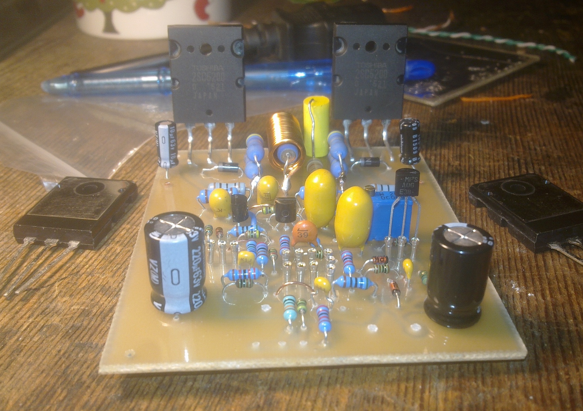

You guys got really active lately in this thread... was exiting to read 😀 Meanwhile, i got very close Naim NAP 140 PCB ready and populated. Still trying to fight against its and but's in terms of sound, especially missing protection which gained its importance lately 😀

Here the supply schematic, with voltage readings, very simple supply really. With both channel supplies connected, at 30ma bias, the supply voltages settle at +/-41.3V, pretty close to the target of +/-40V.

The led resistor is marked 4K7, I prefer 10K with a green led. SB
The front panel LED is shown with the 10k fed from the ~39V supply.
Expect the diode current to be ~(39-2)/10k = 3.7mA
4k7 would pass ~double the current.
You may find that 15k to 27k may give an acceptable brightness.
