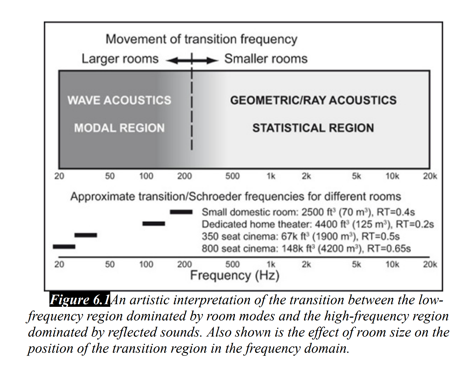

If you try to extend the low end of your two main channel speakers you wind up heading in the wrong direction. There's a frequency range in your room, caused but the size of your room, that changes how long low frequency wavelengths begin to operate. The long wavelengths get squished by your room. That region is called the modal region. It requires a different system design than the standard two channel stereo speakers.
The modal region is normally addressed by using multiple low frequency speakers (i.e. multi-subwoofers.)
It's possible you might want to remove the 10" from the NAO Note IIs entirely and replace them with a multi-sub setup. It just depends on your room size.

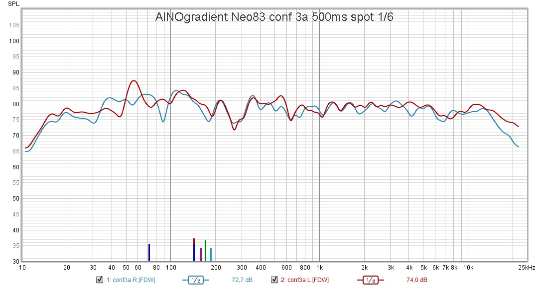

I remember JohnK mentiong somewhere that he thinks monopole bass is good for lowest bass. My AINOs have closed box 10" subwoofers as heritage of Gradient 1.3 and I cross them around 150Hz. A friend has dipole low bass (2x12") but in a different room and I can't say if it's better. Anyway fast closed box low bass gives very good umph! DSP and measurements is definitely needed to make them integrate.
