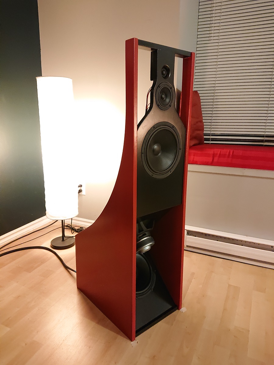

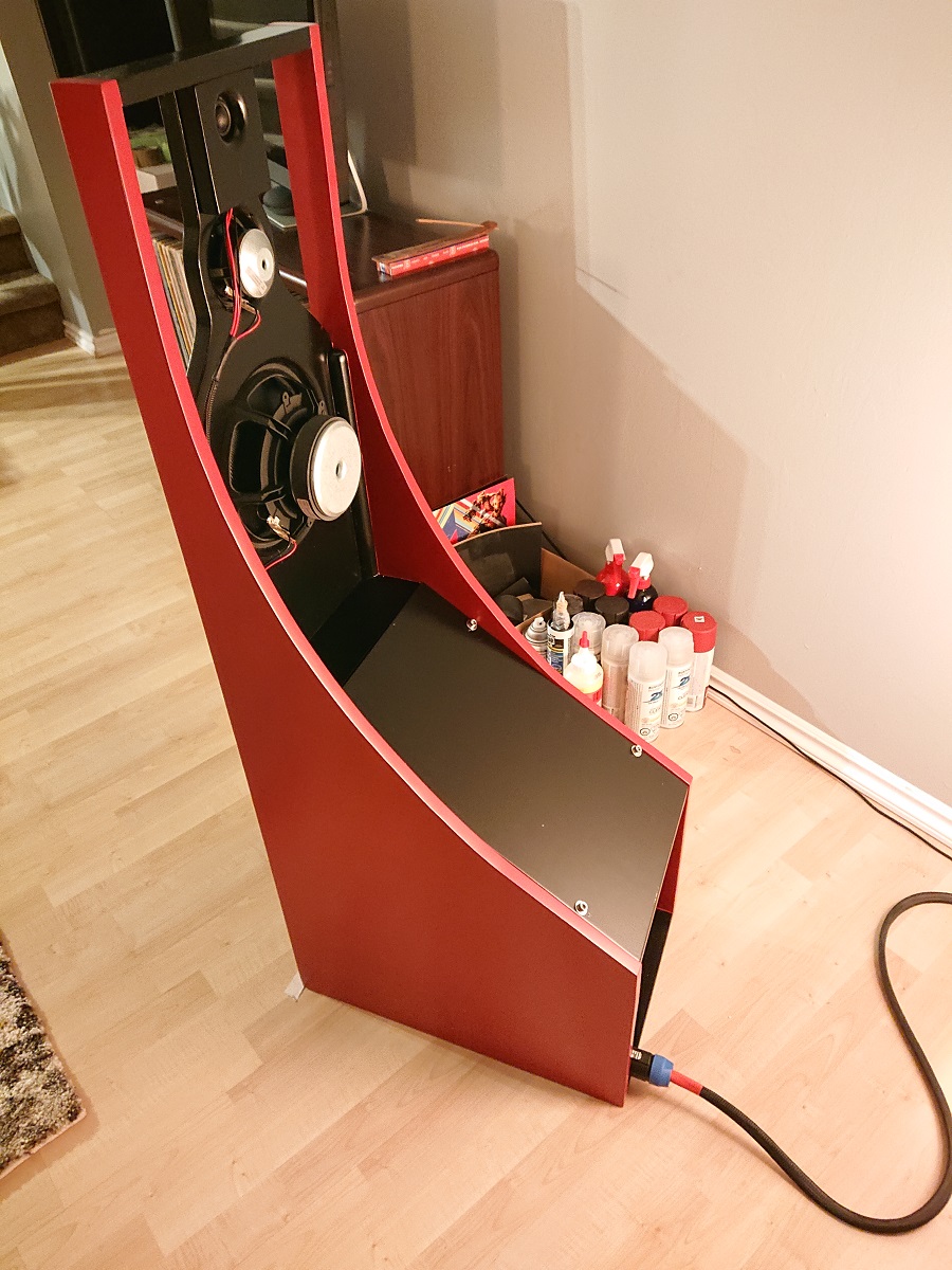

Old thread bump again but I figured I can't start diy shenanigans and not at least follow through once the job is done!
Finished! Not 100% as per the plans with the edges of the main baffle not being rounded properly and I didn't screw the access panel into position but rather used stainless cap screws so they could be removed without damage. A big thanks to John for answering every question I had along the way. It was a hell of a lot more work than I anticipated but I learned a lot and am glad I took on his crazy project. This was my first woodworking project in about 15 years (high school shop class) so every step of the way was a learning experience. Just about every piece of the puzzle, tool and finishing process used was a first.
I made a ton of mistakes along the way and had quite a few disheartening moments. One especially was when the router jumped trying to do a final round over on the main baffle only to scrap about 15 hours of work. Perseverance (stubbornness) came through and I carried on. The paint was also a nightmare from day one but at the end turned out half decent despite the amateur mistakes. I've never taken on anything like this before so it was an eye opener.
The most important thing I learned along the way was to throw out any timelines or expectations. Setting dates for when you think you'll make progress only creates pressure and robs the fun out of a journey towards something you can be proud of. Through this it's given me confidence to start making furniture and continue driving my neighbours batty with not only the sweet music these produce but the tools in my garage.
Listening impressions are still too early to weigh in on too much as I finished these last night. They're quite similar to my magnepan 1.7's but with a little more weight and ease.
The community here is wonderful and I appreciate all the posts you ingenious maniacs make daily.
