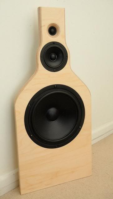

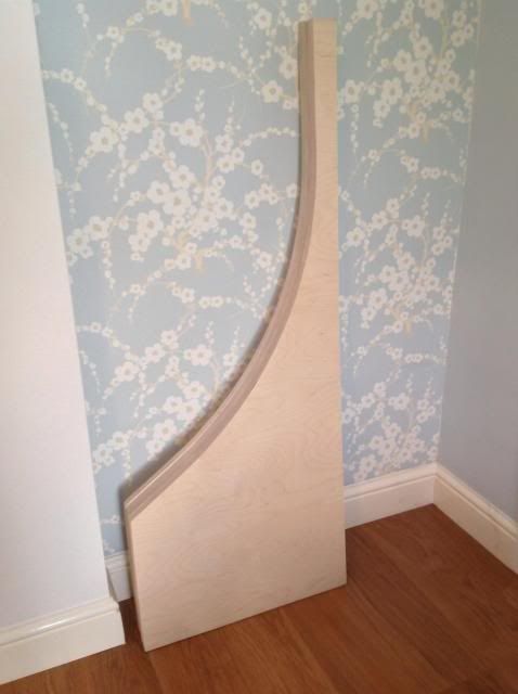

Getting there, the main baffles are done, side panels are done, just need to cut the panels for the woofer cabinet then I can start the assembly process.
If someone has built those around Denver area and willing to show them, please send me PM. Thank you!
