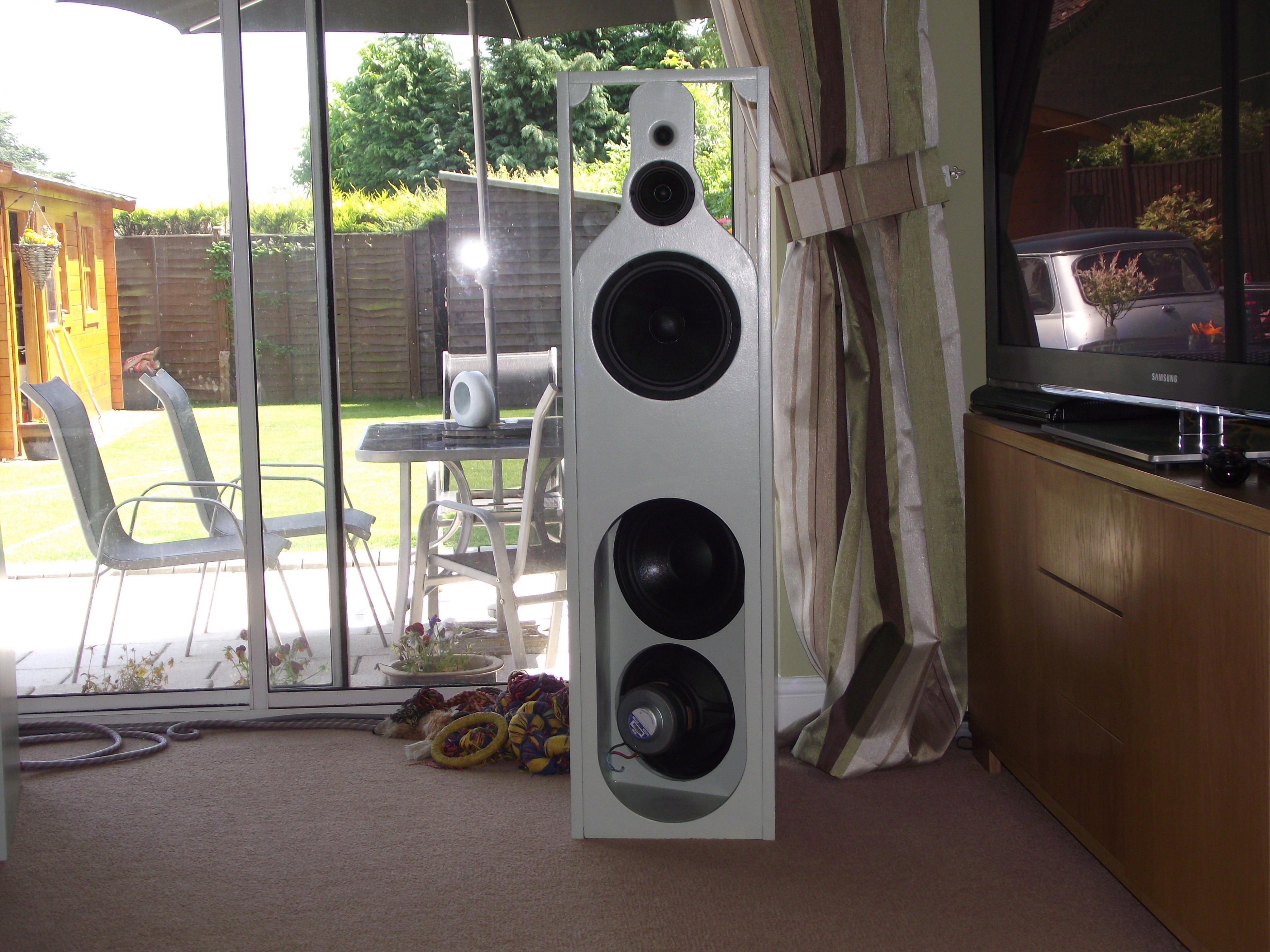

Here are the main baffles built ready for painting, now onto the woofer cabinet.
Very nice. You are joining a group of builder around the world, USA, Europe, Middle East, Far East, Australia, Africa. No one in South America yet. 🙁
How many builders in the UK? I know of one other.
The main baffles took 4hrs start to finish over two days.

The mini is metalic silver,the nao notes are olive green (international cupboard paint) applied with small roller,it is possible to rub paint back between coats with wet and dry,would work well with mdf.I was in too much of a hurry to get them playing that cosmetics suffered slightly.
Very pleased with the sound of my speakers,cant really get them far enough away from the rear wall,due to the size of the room so i am using dirac room correction and to my ears the sound is the best i have had so far.
It looks like you have a glass sliding door behind the speakers with drapes. I would close the drapes when listening to add a little rear wave damping.
