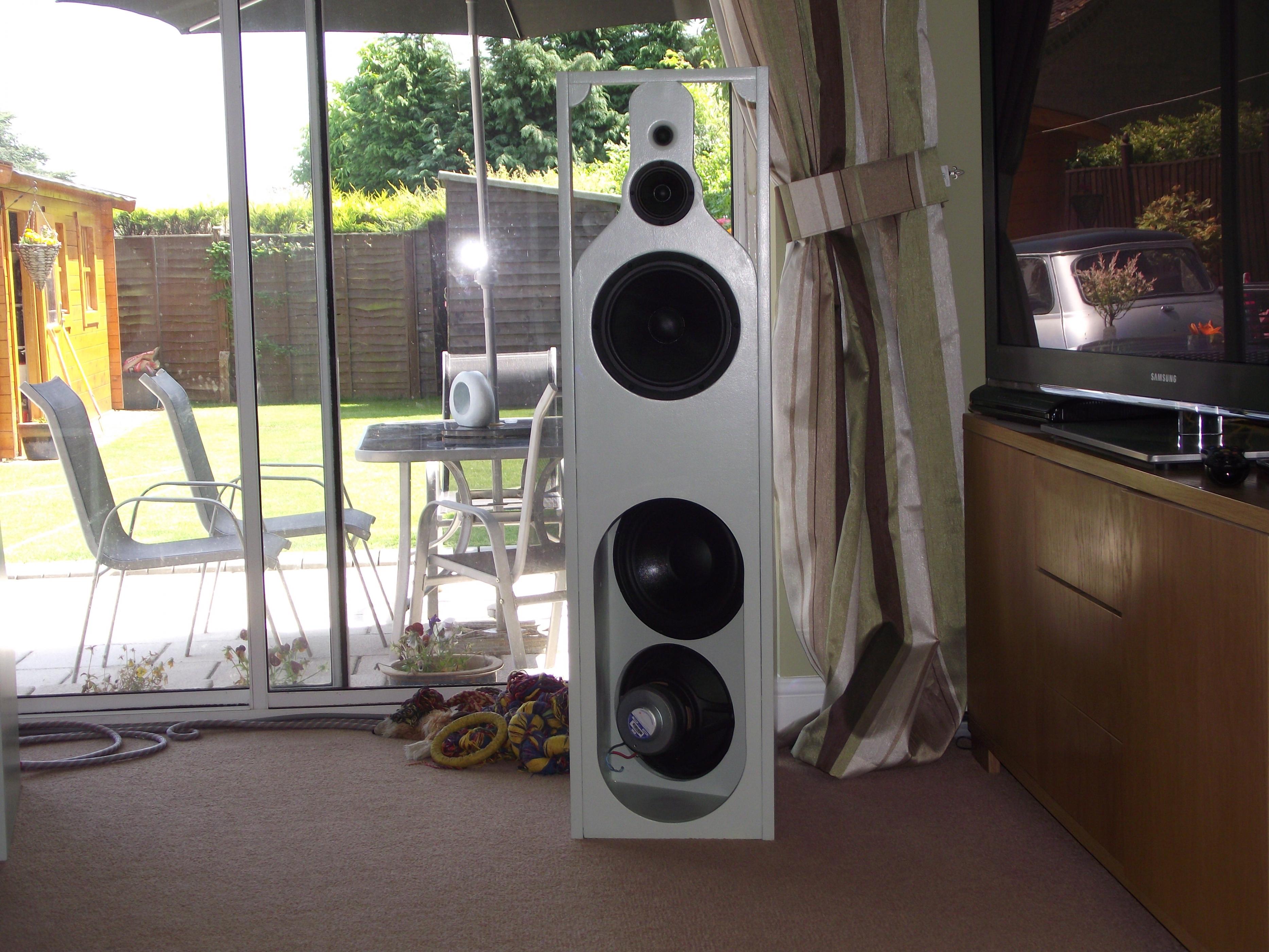

DSCF0521.jpg heres a picture of my nao note 2rs speakers very happy with them.
Very nice, will you be building the grills?
I was going to be boring and paint them satin black.🙄
I will have to put grills on mign as I have some young fingers in the household.
How do they sound, what amps are you using? I have a 6 channel Rotel amp and a 6 channel Cloud CX-A6 amp all ready and waiting.
The Rotel I am using has 30watts/channel and the Cloud has 85watts/channel, I intend to drive each of the woofers (XLS-830452) with it's own amp so will use 10 channels altogether.
