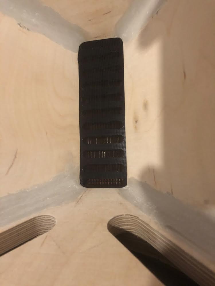

Yes, you mean like this? The TPL150 in straight wall horn works great. The problem is getting the mid injection port to go high enough to cross. The Heil seems to have the advantage here in going down to 600Hz even.

Cool!! How wide was that horn? Got a link?
Interesting to see the plywood thickness and the sharp edges of the slots. Would have thought they would diffract significantly and would be rounded.
Would the smaller diameter 3FE22 help go higher enough to cross?
