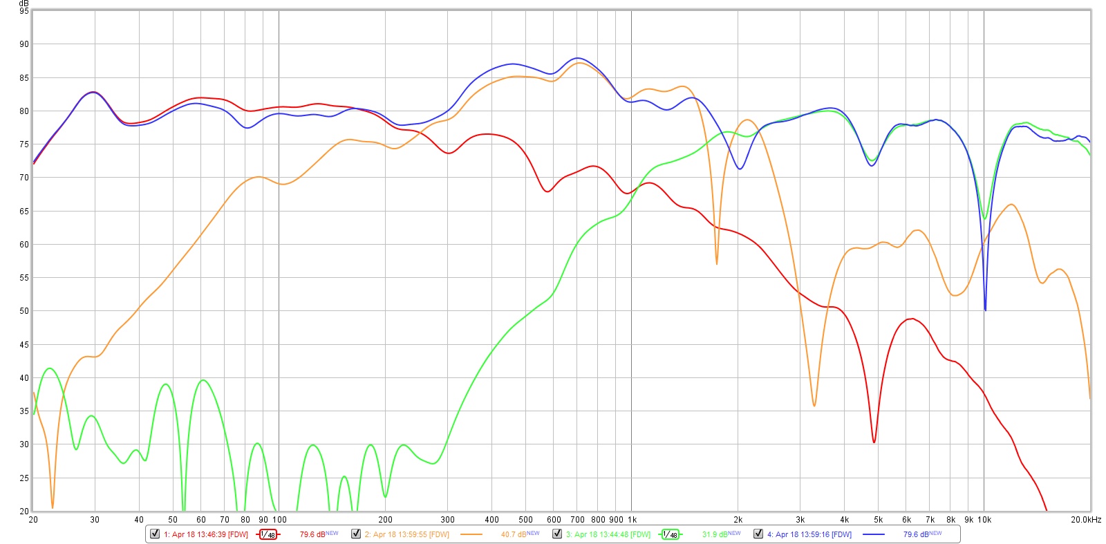

What is the highest continuous smooth mid-driver bandwidth anyone has achieved (commercial Danley speakers included)?
Is this Patrick Bateman's SOA?

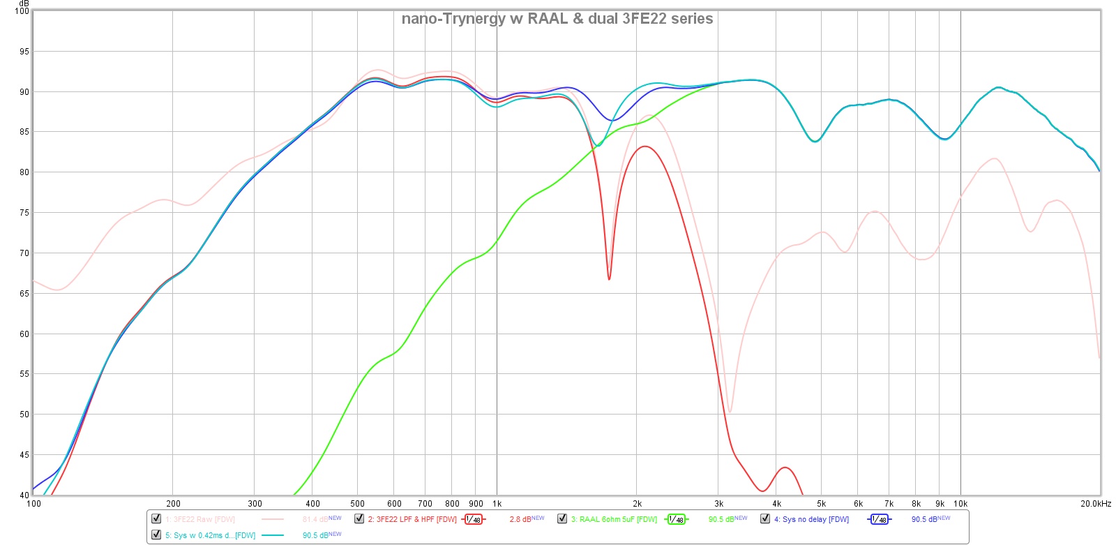

Here is mine, I guess very similar limitations above 1.5khz, I think mine is a bit better:

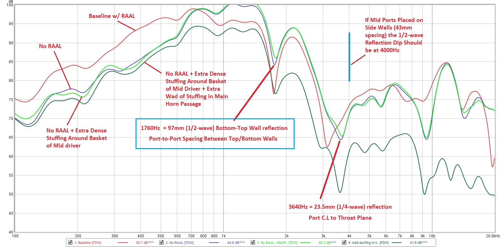

Here is a study of the effect of not having a membrane at the throat to reflect, and also various additions of fiberglass stuffing around the driver basket to reduce back-cone reflections, and also more stuffing in the horn passage. The main dip at 1.76kHz was unaffected and corresponds exactly to a wall-to-wall (1/2-wave) cancellation dip for a 97mm wall-to-wall spacing at where the ports are located. The port to throat plane cancellation dip corresponds exacty to a 23mm distance from the port CL to the throat plane. With or without a tweeter membrane, there is still a discontinuity there and that dip is at 3.7KHz.
You can see that removal of the RAAL moved the 3200Hz reflection to 3700Hz - the only effect really and the 1700Hz dip had no effect, so I don't think the 1700Hz has anything to do with the tweeter reflection.
So I think perhaps the solution would be to put the mid drivers on the side walls spaced 43mm apart, this will move that 1/2-wave cancellation dip to 4khz and it would combine with the 3,7kHz to form a large natural dip for the XO frequency.
The measurement dips in frequency match precisely the physical spacings measured with a ruler. There is nothing to be gained with a better rear chamber. What needs to happen is the mid driver needs to go to the sidewall expansion. But here, will the vertical top-to-bottom secondary reflection still have an impact?

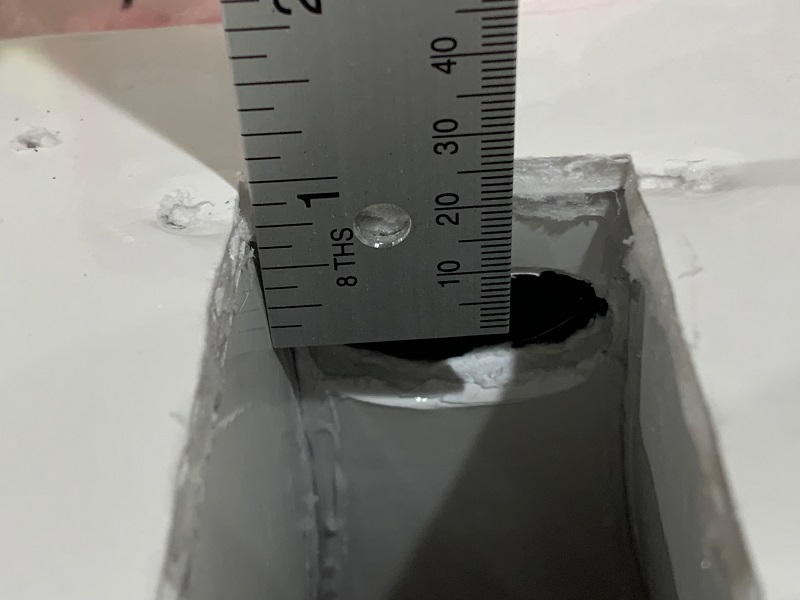

the distance between the center point of the midrange port to the ribbon (or to whatever is behind it) looks to be a **lot** more than 24mm...
Optical illusion? Here is a closeup photo of the throat and mid injection port. That's a Starrett aluminum ruler angled along the wall - you can see it is about 25mm-26mm. Taking account for the cosine(18deg) x 25mm = 23.8mm axial distance.

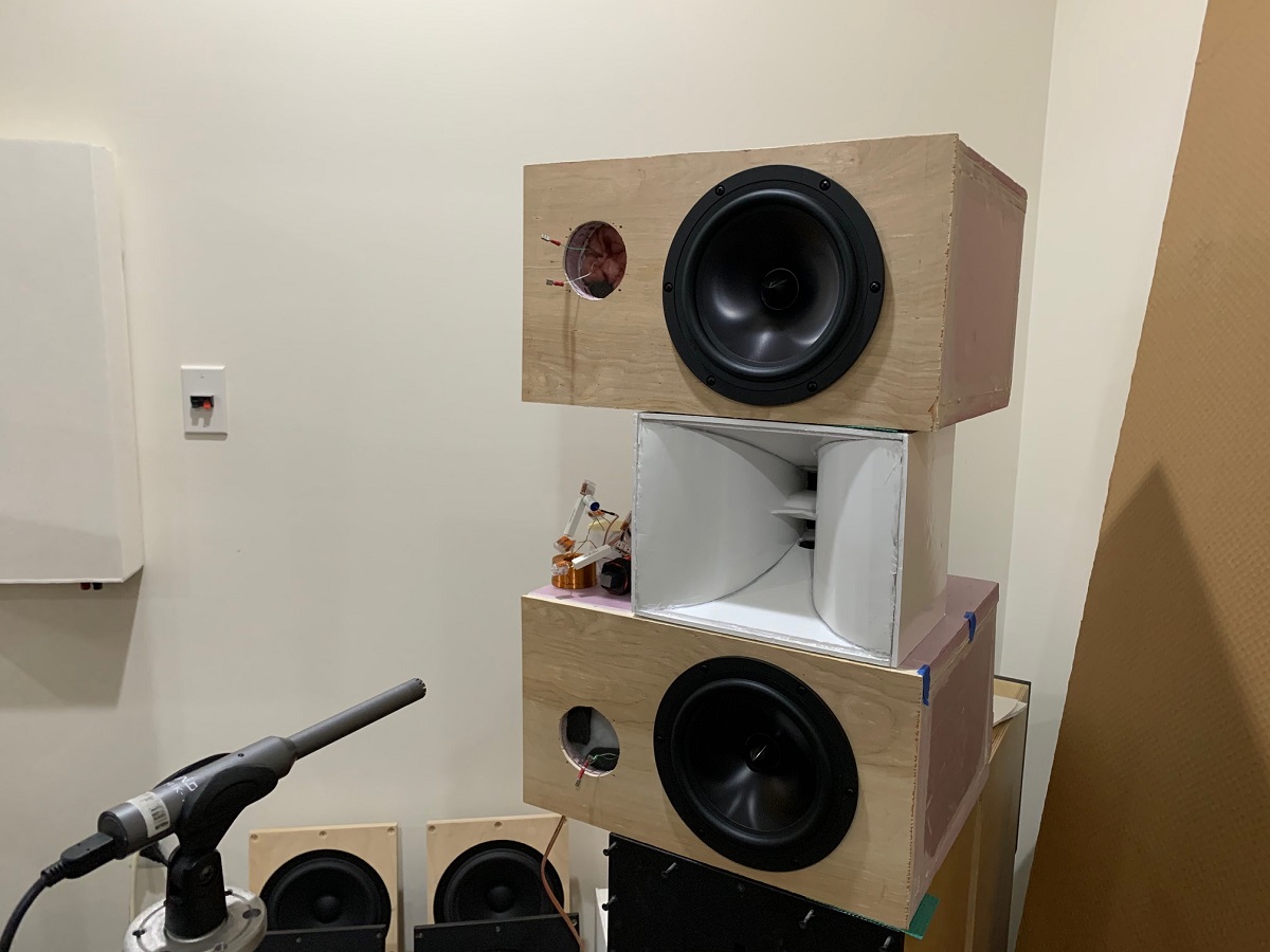

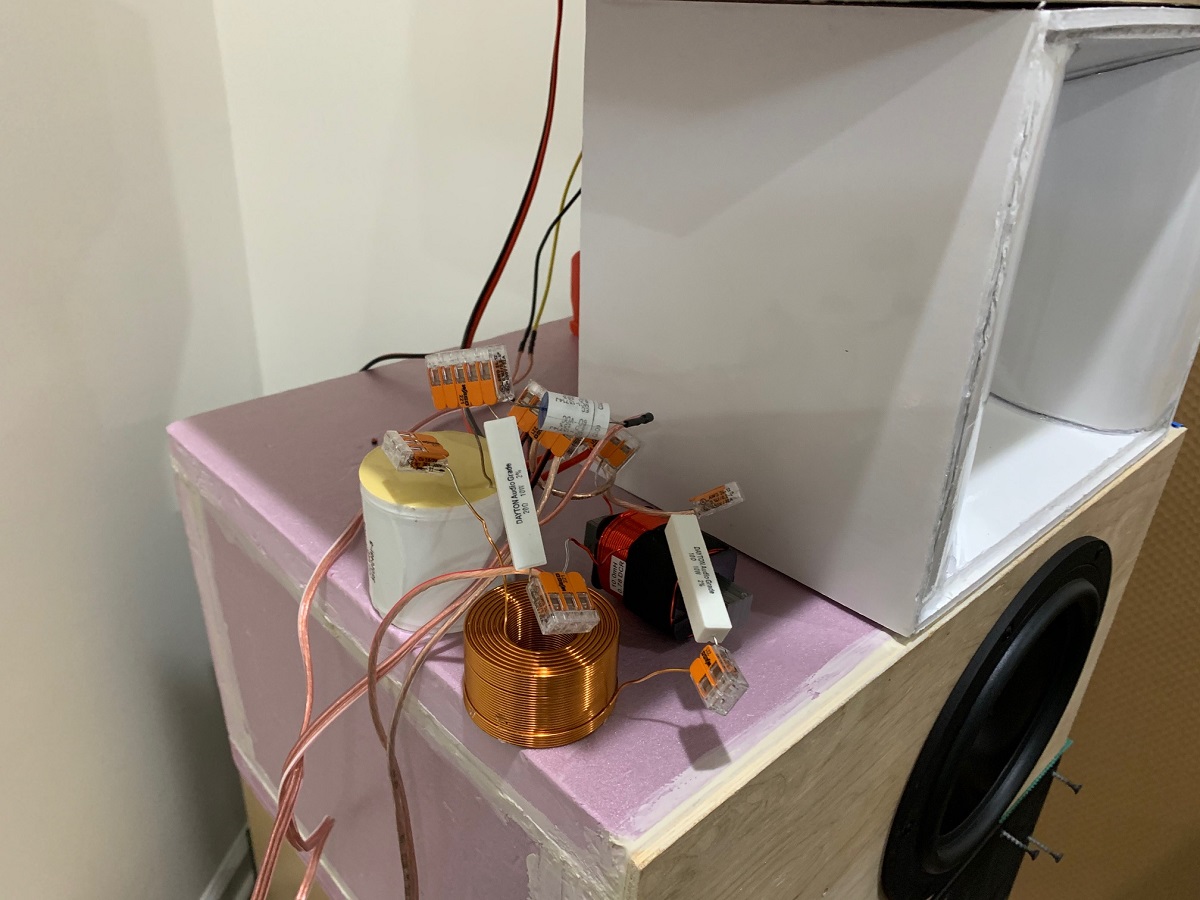

I tried a few more things:
1. Added a foam core splitter plate at the throat to sort of isloate the two mid ports and break up the throat resonance. There is still a 10mm gap behind the RAAL mesh screen for sound to pass through. This did not change the 1.7kHz dip at all.
2. Added two sealed RS225-8 woofers in parallel on top and bottom with a sinple 10mH iron core coil. The added bass makes the sound much more pleasant to listen to.
3. Threw together a very simple XO by eye using rule of thumb values and since I have a dedicated XO dev kit with all values of inductors, capacitors, and resistors, and a bag full of Wago 211 spring clip connectors, it was easy and quick.
Listening to it sounds quite good but there is a big 500Hz to 700Hz hump that needs to be attenuated. The transietn nature / time alignment sounds pretty good though.
Crossover is all postive polarity first order electrical, on RAAL it is 2nd order electrical, 3rd order acoustic. The RS225 sealed is reaching down to 30Hz for some reason - maybe because the speaker is sort of in a corner.
