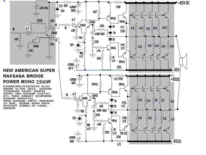

I just looked at this for the first time. You're using TIP41 and TIP42 as drivers. The transistors are rated for 40 Volts and you're running 130 Volts. How do you expect this story to end? Even the 'C' suffix is only rated for 100 and we still have that pesky 130 Volt supply. Back to the drawing board.

It is sad how rapidly cleverness overcomes rationaal. The amp is bridged and provided that the number of devices was selected for SOA and the power supply is capable then this configuration will provide 62Vrms into 4 ohm.
I do not know of anyone who listens to continuous single tone sine waves into pure resistors so 1000 watt rms is a figment of the imagination in any case.
One rather must assume that it is music they listen too driving speakers and the peak power delivered by the amplifier would most definitely reach 1000 watt into a nominal 8 ohms. Tom's maths shows it all, but neglected that it is necessary is to double the voltage swing in bridge mode.

Kindly explain to me how under operational condition there would be 130V across these transistors, unless perhaps its compliment as well as the two series 220 ohm resistors are short circuit while itself does not conduct at all which is only valid for a catastrophic failure.I just looked at this for the first time. You're using TIP41 and TIP42 as drivers. The transistors are rated for 40 Volts and you're running 130 Volts. How do you expect this story to end? Even the 'C' suffix is only rated for 100 and we still have that pesky 130 Volt supply. Back to the drawing board.

It is not designed, but modified. Modification procedure is most dominated by trial and listen
Decent sound quality and simple to built than leach variant or blameless.
Many amp. kits from Indonesia claimed more power than it's should be. They can not distinguish about RMS power and PMPO power or they did not care. I doubt they even measure their designs. It is shame.

if you really want to know how much power an amp of your making can dish out, get an 8ohm/ 500watt power resistor as dummy load, a signal generator, and an oscilloscope to test your amp.
increase the input until the onset of clipping observed on the scope and back off a bit until a clean sine wave is obtained, then read your output voltage...
into an 8 ohm load you can compute for the power....
would be interesting to see if your amp can survive this simple test...😉
When it sits idling there will only be the rail Voltage on any transistor but if you drive it to clipping, the positive transistors will have the full 130 on the negative signal peaks and the negative transistors will have the full 130 Volts on the positive peaks. If you don't understand that you're not ready to be experimenting with high power amps. Put a scope on it and see for yourself.
If you're not going to drive to the rails now and again, what's the point of the high Voltage?

And what will be the voltage across the 220 ohm resistor. more or less than Vce SAT?When it sits idling there will only be the rail Voltage on any transistor but if you drive it to clipping, the positive transistors will have the full 130 on the negative signal peaks and the negative transistors will have the full 130 Volts on the positive peaks. If you don't understand that you're not ready to be experimenting with high power amps. Put a scope on it and see for yourself.

Yes. Sorry. I did not notice or think about bridged configuration, for the calculations.
Yes, looks like it is operating safely because of 220 ohm resistors, and resulting smooth round clip also with this. Although the current may higher when clip, tip41/42 is to220 package and survive VAS overload current through 220ohm, and limited time to 470uF energy stock.

C945 inputs and Sanken OPS. That 220ohm VAS supply originally 820ohm and supplied with +/-42VDC. At the first launch, this amp is instantly famous but rather dissapear again.

for the amplifier to produce 2500 watts, your power transformer should be a 5kva one, weighing in at least 30kg....assuming the output trannies can survive testing at that power level....

The amp won't reach 1000W. It feels loud on bass, may be its low damping due to lack of ccurrent, increasing its loudness.
