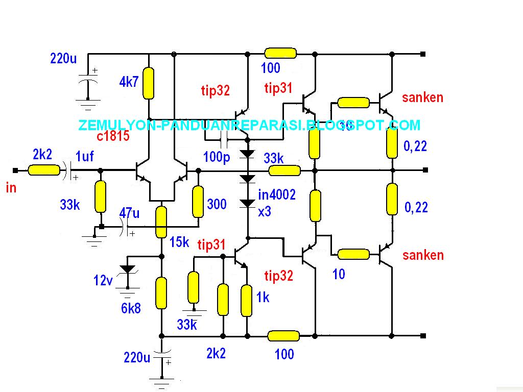

There are different tradition in the country, single pair tip3055/2955 is 100watt, single pair 2n3055/mj2955 is 150W single pair sanken MT200 is 200W, then 4pair that MJL should be 4x150W or 600W.
Also that TIP won't work at high voltages. I found this sch
http://s19.postimg.org/jk0y7uf5f/Namec_sch.png
look like pioner 010, i think it's a same PA...or something plagiat lol...There are different tradition in the country, single pair tip3055/2955 is 100watt, single pair 2n3055/mj2955 is 150W single pair sanken MT200 is 200W, then 4pair that MJL should be 4x150W or 600W.
how to get out 1000wat?
no draw bias.
45Vac 1000wat how do you calculate it?
45 Volts AC RMS gives 63.64 Volts Peak.
Subtract 3 Volts for worst-case rectifier drop. Gives 60.64 Volts peak.
Assume 6 Volts (just a guess) for minimum voltage between power rail and output, Vclip, across amplifier.
So peak rail voltage, Vrailpk, is assumed to be 60.64 Volts.
You cannot get 1000 Watts RMS into 2 Ohms or more, with that rail voltage.
But you could get 1000 Watts RMS into 1 Ohm:
Voutpk = √(2(P_rms)(Rload))
For 1000 W RMS into 1 Ohm:
Voutpk = √(2(1000)(1)) = 44.72 Volts Peak
Vout_RMS = 31.62 Volts
The minimum reservoir capacitance would be:
Cmin (in uF) = 1000000(Vpk/(Rload(Vrail-Vclip-Vpk)))( (1/(2 fmains)) + (0.02/Voltage_Rating) )
Cmin (in uF) = 1000000(44.72/(1(60.64-6-44.72)))( (1/(2x50)) + (0.02/63) )
Cmin = 46520 uF
I would recommend using qty 10 x 4700 uF, at a minimum.
If you used 100000 uF, then the max rated RMS output power would be 1226 Watts, because the max clipping voltage would be lower, so the rated max peak output voltage could be higher.
For higher-impedance speakers:
Voutpk for 1000W RMS into 8 Ohms would be 126.4 V peak. You would have to add Vripple, Vclip, and Vdiodes to that, to get the needed transformer output voltage. The peak current would be 15.8 amps. So maybe add 15 Volts, giving 141 V pk, or 100 V RMS transformer output. The good news is that it would only need about 22000 uF per rail.
Voutpk for 1000W RMS into 4 Ohms would be 89.4 V peak. You would have to add Vripple, Vclip, and Vdiodes to that, to get the needed transformer output voltage. The peak output current would be 22.4 amps. So maybe add 15 Volts, giving 104.4 V pk, or 74 V RMS transformer output. The good news is that it would only need about 25200 uF per rail (but 47000 uF would get the ripple down to 5%).

1000 WATT PEAK or 1000 WATT RMS 😕 ? I don't think it would be able to result 1000 WATT RMS unless --> the loudspeaker is "1-ohms 😱 " with at about 31.5V RMS output (if DC supply at about 63V DC).

I found that VAS current mirror will result impedance at about 19.5 kilo Ohms ~ 20 kilo Ohms. Implement TIP41/TIP42 is so overkill for VAS & current source of VAS with such kilo-ohms impedance.
Now you raise the big questions like "how much audio power can I get using obsolescent, low voltage, industrial power transistors?" This design is audio at its worst, where parts are selected from just a few widely available but most important - very cheap industrial transistors.
TIP 41 has 100V Vceo(max) but BD139 only 80V, so what happens ? The designer selects the crap power transistor for the VAS because it has higher rating, but that says nothing about linearity as you exceed the basic TIP 41 40V SOA. This is not good thinking - it might be better as a motor drive rather than audio amplifier, even if it does work.
40 years ago, I guess it might have been worth using in poor areas but it won't hold together approaching its ratings without extensive protection circuitry or a lot of repairs - a disaster in the making and unless you like PA with a "certain" sound quality, the public will be far from impressed.
