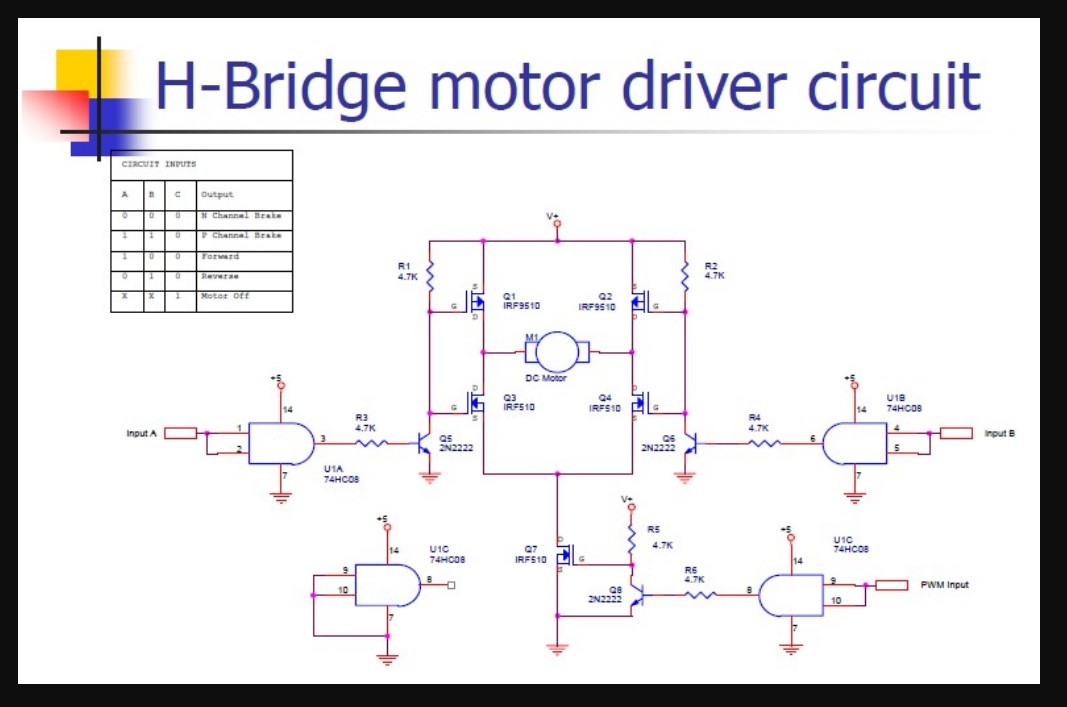

Most such controls have the motor connected to what is called an 'H Bridge Driver' which is simply a circuit that allows the motor to be supplied with either polarity of voltage in response to a logic drive signal.
First make sure the remote is transmitting OK... use a digital camera to view the IR LED.
Next up would be to determine the drive arrangement (the H Bridge) and locate the appropriate ports from the uProcessor/logic board and check with a scope (or even a DVM looking for 'change' as a key is pressed).
Start simple with the remote before going deeper... and has this worked in the past? and is the remote known to be the correct model for the amp?
This example uses FET's although most just use bjt devices.

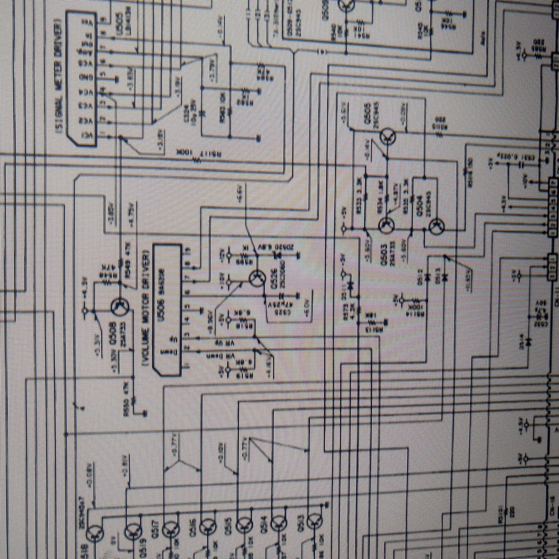

I found volume control driver on logic board(u506)
And q526 transistor. Which looks like the transistor doing voltage switching.
Hm. Might swap logic board now) would not be a big deal but I actually use remote quite often.
I hope it's q526 transistor.

The diagram isn't really clear enough to make out fully but yes, pins 2 and 3 look to be the logic inputs. Just look for change in voltage as you hold the remote keys down.
Q526 looks to be a simple regulator. Can't make the voltages for sure but it looks like 6 volts on the zener and you should have nearly that on the emitter of the transistor feeding the chip. If those voltages are OK then its not the transistor... but check them as you press the remote key.
