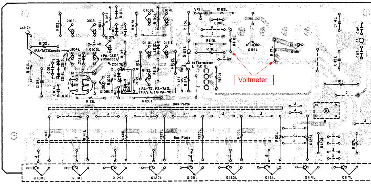

Yes its technically working now but is definately hotter than the same transistors on other side. They are not super hot like they were-they are touchable now but the other side is only warm. Thinking running super hot for awhile might have degraded them and although as BSST suggested it may not be the issue I would just like to take them out of the equation because if they did fail it might be catastrophic. I had looked at 2sa1837/2sc4793 before but didnt choose due to lower collector current. The 2sa1668/2sc4382 seem to meet the specs better I think so may give them a try. Thanks for the suggestions and pdfs.Why would you change 2SA1306/2SC3298 if they're working OK ?

I think it's wise to have the new transistors in reserve for repair, but if heat is the issue, I recommend taking voltage measurements across all those emitter resistors, both in the problem channel and the "good" channel for reference. I recommend tabulating in a spreadsheet and believe the side-by-side data might be insightful.

Do what BSST suggested first. Btw, when you pulled out the original 2SA1306/2SC3298, did you do a quick diode test between the leads ? Heck, don't say you didn't ! gto127 you're not helping us. This will end up in a disaster mate. You were already close to it. Probably the Almighty gave you a second chance ! 😉 🙂

I did do a diode test- must have been breaking down under higher voltage.*bump
