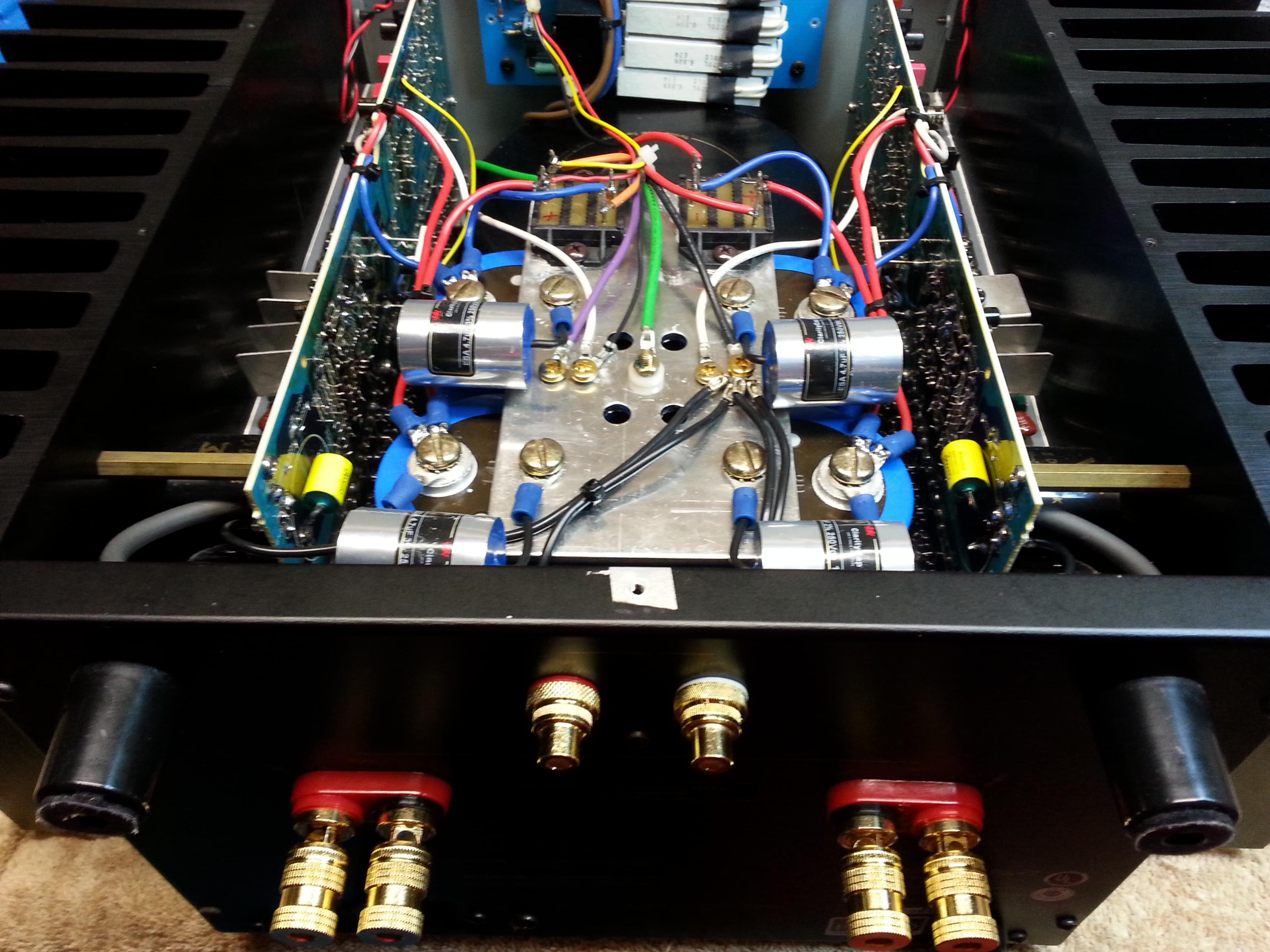

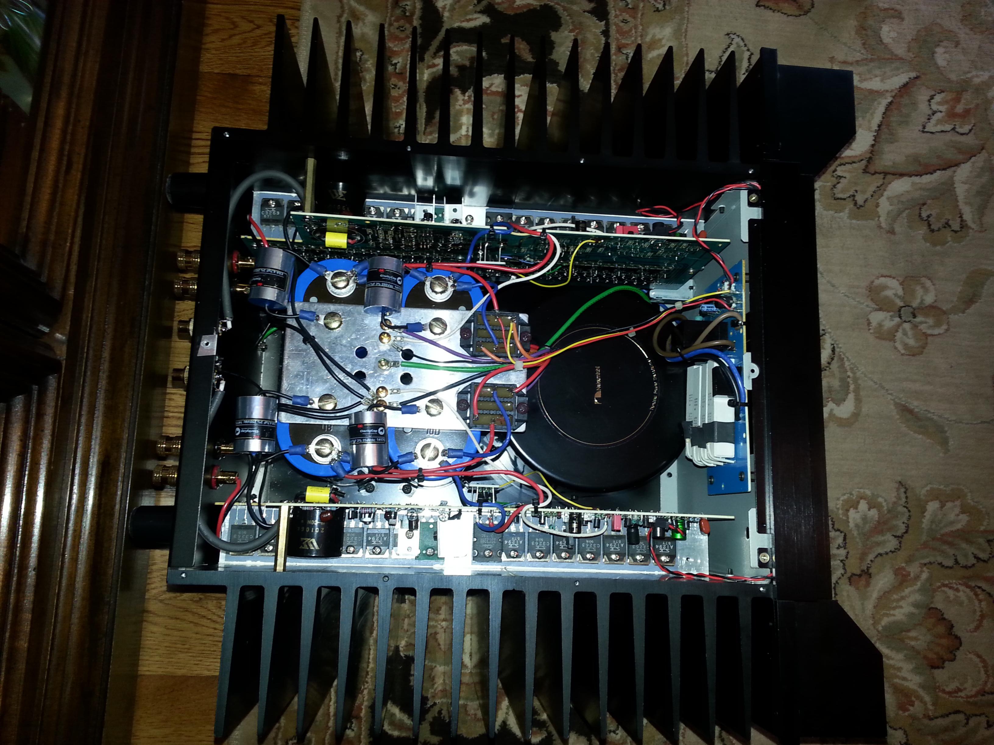

I posted this on the solid state PA 5 forum:
Greetings!
I have been rebuilding a PA 7. It has been rewarding but frustrating since the info is scattered about. I am considering starting a PA 7 update page so that we can bring our collective knowledge together. I totally missed this PA 5 page and for a long time didn't have some key information.
Regarding the main cans, I was not completly satisfied with the sound even after recaping the boards with wima, muse, and cerifine caps. The amp still sounded rather closed in with soft bass and poor high end extension.
I have recaped many vintage recievers and have heard many of them sound really sub-par with the old cans. It is amazing what a difference they can make! Sometimes the old ones will reform and sound really good. I am using a HK 930 that sounds great with the origional cans! Often though, they will sound awful at first listen, really dynamicly constipated. Try turning up the volume and it's like running into a wall. Then after a few days the sound really loosens up. It seemed the same thing was going on with the NAK.
Replacement cap options are rather limited. Specs are: 33kuf @ 100v, 2.5in (64mm) dia, 6"h If you look at what's available, the Nicicons and most others are 3" dia. They will NOT fit in the PA 7! That leaves Rubicon Digikey: Not stocked minimum order of 10. $59.71 each. If someone can find them stocked Please let me know!
I ended up going with the TCI caps from an ebay seller. Very little info on them. They are US made and appear to be very rugged. TCI makes industrial power products and these are apearantly surplus. 2pcs TCI 100V 33000uF Computer Grade 105C Bus Capacitors New | eBay Less than $150 for 4. I took the plunge (out of options at this point) and have been very satisfied. You have to drill out the holes on the buss plate and use larger crimped rings since the screws are HUGE. The improvement in sound is really substantial. Much more linear. Tighter bass, better dynamics, much better on the highs.
Hope this helps.
Also, I just added Clairty caps 4.7uf @ 250v for bypass. I still need to change the bias pots and the 200v fb caps. But right now I am totally thrilled with the sound on my Newform RS 645's.
Here are a couple of pictures.

The IXYS bridges I got from PCX. I used VBE 26-12 NO7 which is rated at 32A and 1200V. This is probably way overkill since with the soft start circuit they are never stressed, but the price is not much different from the smaller ones so why not.
I can't say that it made much difference with the old cans. I think it is more like icing on the cake. If the cake is old and stale the best icing in the world isn't going to help much!
Which brings us back to those big cans. What condition they are in depends on a lot of factors. Was the amp used regularly or in storage for years? Was it kept in some hot attic or damp basement or unheated garage? My amp had not been used in years so maybe that is why I needed to change them. YMMV.
I do know that I tried bypassing them with .47uf Wima's (the only thing that I had 4 that matched) and was not happy with the results. The sound became bright and edgy on top while still being soft and congested in the rest of the range. I ended up taking them out. What was happening was when you put a very small value low ESR cap in paralell with an extremely large high ESR cap you are making a filter. The bypass only helps on the high frequencies leaving lower ones still straining to get current.
So what I am saying is if your cans are in OK shape you may be able to get away with bypasses if they are large enough to affect most of the frequency range. If the amp still sounds overly soft and sluggish with the bypasses then you should replace the cans.
