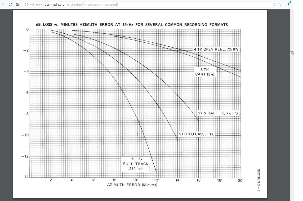

Thanks for reply. I actually have the azimuth alignment tape for high freq and wanted to get it as close as possible with a track(height) alignment tape. The tape deck was severely misaligned by previous owner so badly that it would chew the tape. I wouldn't normally bother with track alignment if not for that. Got it close but still just don't sound as well as it should.
