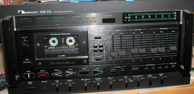

I'm having some problems with my cassette deck and I was wondering if it's something that I can fix or if it's out of reach without the right equipment.
When I go into the auto calibration mode the auto azimuth alignment unit seems to run out of its limits and starts to click.
From what I can see, the the auto azimuth alignment unit has its own motor to swing the "pendulum" through its range until it senses perfect azimuth.
I can only guess that the motor is capable of reversing? It seems as though my unit is wanting to go in only one direction until it runs out of its limits.
Anyone willing to take a stab at it?

As you can see, it is sitting far left of center:
Well, a second try ...
I`ve written a long explanation of how the azimuth adjustment system works but somehow I`ve lost it. So a short version now.
I think the failure is in the auto azimuth motor driver. This is a bidirectional motor and it needs (+) for the one direction and (+) for the other. The driver decides this reading the potentiometer which is in the black box to know where the position is and also it takes signals from the phase comparator. This is a loop which stops when the azimuth is correct and there is now phase difference. So, there are 2 matched, complimentary transistors there. 2SD471 and 2SB564, I think the originals that Nakamichi used are from NEC. One of them is bad. Check them and replace them if required. These 2 are a bit hard to find but not impossible.
By the way the Dragon has them also for its NAAC. So, this is a 50 Cent job, do this. Good luck. Best regards ...

Whenever Play is pressed (in record mode including) the meter display are always at max without regards for pot or input settings. They go off only in stanby (Stop).

Well, the Nakamichi 1000ZXL is a very complex machine. It is hard to say where the problem really is. I have a service manual only for the 1000ZXL Limited Edition which doesn`t contain any adjustment procedures. If I were you I, would start with the adjustment procedures first. May be you are lucky and your deck is just out of tunung and you don`t need further to troubleshoot. Generally spoken the level meter consists of two chips which control the beginning and the end part of the LED display. The 1000ZXL Limited has two TC4022BP from Toshiba, The Dragon has two (TC5081P also from Toshiba). The 1000ZXL Limited has 2 boards which control the LED display. FL Indicator P.C.B. "A" and FL Indicator P.C.B. "B". The two chips are on the "B" board, on the "A" board there is a pot to take an adjustment. Generally there is an adjustment procedure for the LED display. May be if I take a look at your service manual I can tell you whether and if there to adjust. Iif you can not adjust this then you have to make a little troubleshooting. Indeed, the 1000ZXL is a very complex mashine and you have a very nice one as I see. Service manual is a must. The troubleshooting if required then includes checking the input voltages, signals, and may be some components. Perhaps it is also important to know when and how all this with the LED display began.

The unit worked fine originally, then I put it to rest for 3 years; when I first switched it on after that period, something blew in a PS and I had to replace one transistor (in PS). That brought the unit back to normal operation again, except for a meter, which always stays at maximum, whenever inb play mode.
I have service manual with adjusting procedure/troubleshooting guide, but I don't recall it says anything about that type of behaviour. The unit is indeed very complex, and I was postponing that repair for more than a year now.

Hm ... this makes the things somewhat different. Again, I`m looking at a 1000ZXL Limited Edition Service Manual and shematic may differ somewhat ... Nevertheless i would think a little bit in order to help you.
Well, it seems that when something blew in the power supply not only this transistor was blown but also some other part. You`ll have to make a check.
As I told you in the previous mail, the led display consists of two boards. The second one "FL Indicator P.C.B. B" is directly connected to the "Power Supply P.C.B"through the connector "CN-37" wich has 5 pins:
1. AC
2. AC
3. GND
4. -39V
5. +5V
Pin 1. and 2. (AC) are going directly to the "Fuse P.C.B." and are fused with F404 and F405 (both are 1A 250V). So, check these two fuses first. Be aware of the safety precautions. If the fuses are blown replace them only with the specified ones.
So Pin 3. is ground, check that too and also check the voltages of Pin 4. and 5.
If the fuses are ok, chesk the voltages at these pins and the ground. If the voltages and the ground are ok and the display is still weird, the problem is somewhere on the one of the both display boards. Or on both. Then you will have to check the voltages on the boards. Do this and then we should know more.
Good luck. And don`t forget ... Safety first. 🙂

It's been a while, but thanks for your help with my problem. I took my cassette deck to my local repair shop before any answers were posted to this forum.
They found one plastic gear that adjusts the tape head to be broken. I'm not sure if this contributed to the auto azimuth alignment problem.
Next they found the push button that is depressed to start the auto calibration mode to be sticking. Again, it's not sure if this caused the run on with the auto azimuth either.
The repair inspection stopped at that point because even though they were a Nakamichi repair shop they didn't have the service manual, the alignment tapes or any parts to fix the gear problem!!!
I spoke with Stephen Sank of Albuquerque NM. His shop has the alignment tapes, the parts, the service manual, and quite a bit of experience when it comes to this machine. I'll print this thread and enclose it with the package I'm sending him.
I'll come back to this thread to report what the actual cause of the problem was with this machine and what was done to get it back up to snuff.

The broken nylon screw must be replaced.
Then the azimuth motor gear must be turnde by hand apx in the middle .
Now adjust the nylon screw by eye apx. to the middle and try the calibration .
Maybe you have luck .
I have the complete manual of the 1000 ZXL .
Its very complex and without the required tools your chance is small .
