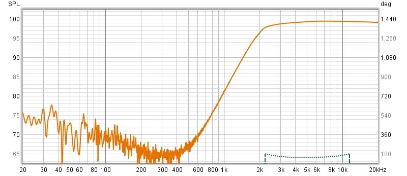

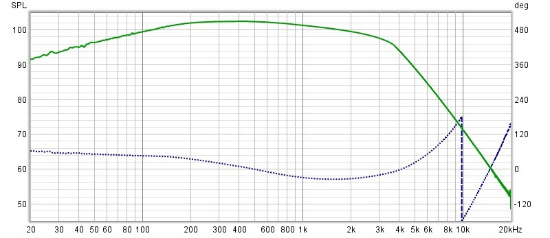

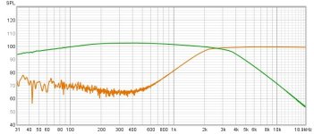

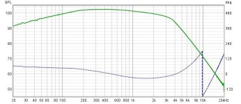

Took some measurements with REW.
There is a noticeable drop in the LF - 6db down at 40Hz which is a surprise. Might this be due to capacitors being out of spec?
The distortion measurements are also poor - might be the 30year old Tantalum coupling capacitors? I'm thinking about replacing them with Nichicon Muse or Elna Cerafine polarised caps.
Crossover frequency is correct ~ 2.5k.
