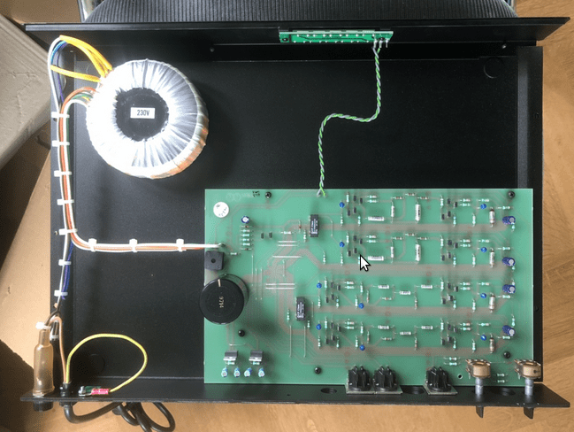

I recently won an IXO crossover and decided to check on what I thought was a loose Din socket.
On opening it, I noticed that :-
  • The 18db/oct filters used Zetex (formerly Ferranti) ZTX transistors - not an IC in sight (a refreshing change not to see NE5523/34 opamps)
  • The LF & HF 50k level controls are wired unusually - wiper to the input sockets with a 4k7 series resistor to prevent a dead short of the preamp output on minimum. (20k on max)
  • The single rail power supply uses a LM317 set to 24v - one for each channel.
  • The input, output and interstage coupling capacitors are Tantalum. 10uf/35v
Now I don't remember ever seeing Tants used for this purpose. Usually a standard polarised electrolytic would be used on single rail designs.
I have to say the crossover has made a significant improvement to my 35yr old SBLs. (Quad 306 driving the bass/mids and derated Krell KSA50 clone for the Scanspeak tweeters.)
I found myself listening for 4hours yesterday evening, about twice as long as I usually listen so I am not planning any "upgrades" to the IXO.
As far as I recall, in Cyril Bateman's measurements, they distort a bit more than aluminium electrolytics.
https://linearaudio.nl/cyril-batemans-capacitor-sound-articles
They can handle less reverse voltage, and if I'm not mistaken, they have less effective series resistance (hence less thermal noise) and less leakage than aluminium electrolytics. The distortion can still be negligible if the signal voltage across them is kept small enough.
I used to avoid tantalum like the plague because of it being a conflict mineral. That's less of an issue now, as nowadays there are many manufacturers stating that they did their best to obtain the tantalum from legitimate sources.
Problem with tantalum caps in audio is that they are unknown to many and still suffer from their tainted past. The drop type is exactly the type that caused tantalum caps bad reputation due to their unreliable character and unreliable sources in war torn countries. The Bateman results are of drop type or "bead" type tantalum caps. Recent tantalum polymer caps are of very high quality also in audio (but not popular as they are simply very expensive). Pro/medical/military equipment is full of them as today they are excellent* parts.
Replacing old drop types is advisable certainly when they are used directly on power rails. They have a habit of burning/exploding during/after a useful life. If you want to avoid that risk then only replace for tantalum polymer or niobium types by the known brands. Avoid the drop type, there exist "normal" versions.
*Open your smart phone and see what is used there.

Most of what has been said above echoes what I have been able to find online.
I have concluded that:-
The rating should be well above the design voltage - so in the IXO, 35v Tants with 12v across them.
Limited to low signal levels i.e line level - about 1v RMS max.
Expect possibly slightly higher distortion, but lower noise than electrolytics.
Very little aging.
Low leakage.
One assumes Naim spent a considerable amount of time trying various types and brands of coupling caps (as well as the filter ones which look like polystyrene.)
With the difference (again) that todays polymer tantalums don't have inherited the negative aspects of their ancestors. Every repair guy/girl has replaced burnt out drop type tantalum caps and loves to hate them but apparently manufacturers like Kemet and Kyocera AVX instructed their employees to develop better products in the last 40 years or so.
Expect better properties, not worse. Try out, measure, verify, listen, write µF and Volt. There will be a different sound character though as the old ones had eh... quite specific shortcomings.
