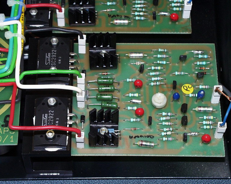

Nap140 actually has some bugs that need to be corrected.
I do not recommend that DIY have the same structure as the original machine.

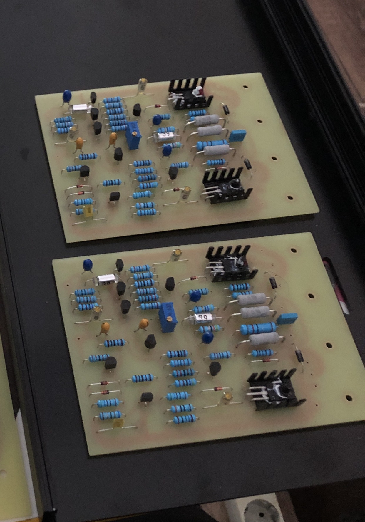

His VBE bias triode needs to be installed on the radiator. Ensure thermal stability.
Sorry, I'm not advertising. I just found the pictures I took before.
Used to tell you that you need to modify it like this.

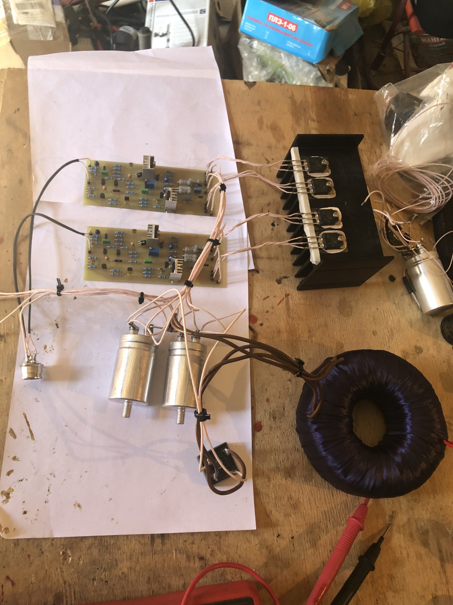

Thanks. But then it's not the original design but an "improved" version. That would mean that al the original boards out there never did or do function correct. I don't believe that. I have the original boards. I am aware of the VBE bias an therminal stabilisation of the small closed chassis in the design Naim did.
I wil try to stay as close as posible by that specs of chassis and heatsink surface.
If you build original amp you not need relocate VBE bias triode because all work with internal case amp temperatureNap140 actually has some bugs that need to be corrected.

but if you build not original design some like Chinese you right because Chinese boards is not adaptive to use vbe bias triode without radiator )

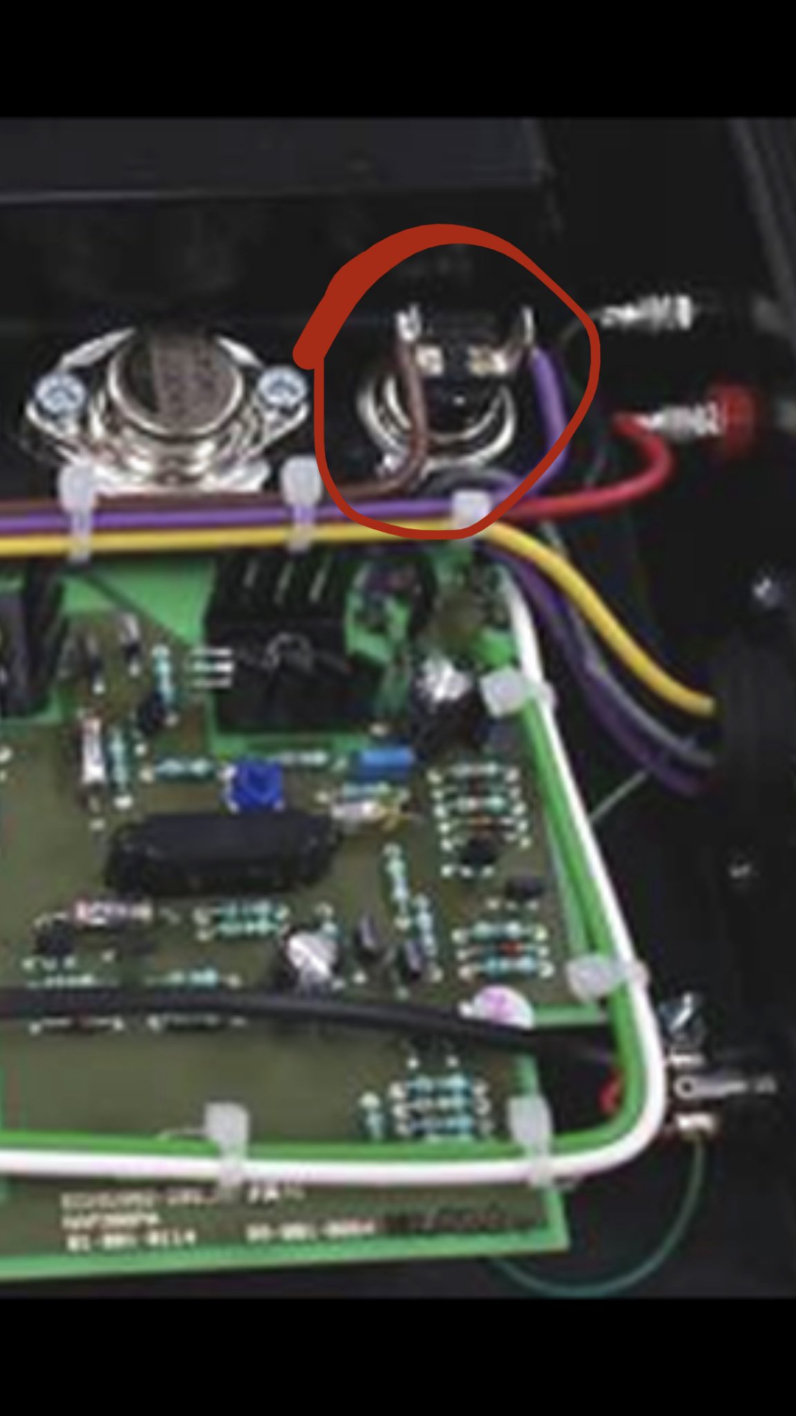

also if you very scary about overheating just add thermal fuse like on photo in attachment
p.s need use original parts and boards )

I testing the original boards and you do not need relocate vbe bias triode to radiator
All work fine and not warm )

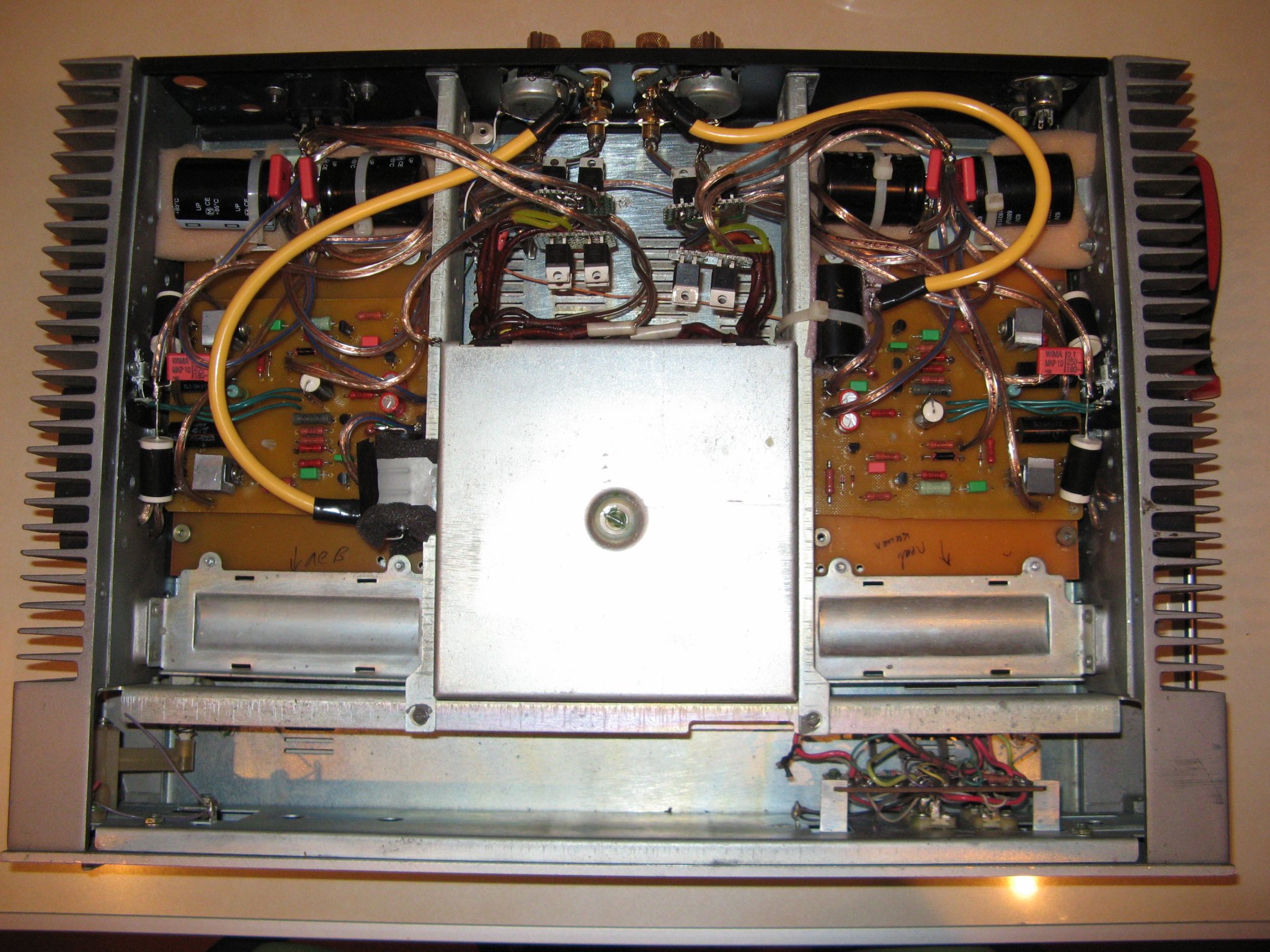

It does need a small, sealed box for early Naim models to regulate bias optimally and even then, bias doesn't settle for some models, for up to 1/2 hour from turn-on in cool conditions. Strictly speaking, that actually does translate to "do not function correctly", at least until the whole amplifier device has warmed up to a normal operating temperature range where bias is set....... That would mean that al the original boards out there never did or do function correct. I don't believe that. I have the original boards. I am aware of the VBE bias an therminal stabilisation of the small closed chassis in the design Naim did.
Even so, the long thermal lag assumes that program levels are fairly constant and there is no need for a rapid response to significant changes in output level. That is somewhat risky but certainly in line with other quirky aspects of Naim's early products. The comments LJM is passing on though, are about his design mods which do a more dependable job of compensating for the thermal lag problem with this particular modified clone design of his.
I'm glad that someone can finally agree with my suggestion.It does need a small, sealed box for early Naim models to regulate bias optimally and even then, bias doesn't settle for some models, for up to 1/2 hour from turn-on in cool conditions. Strictly speaking, that actually does translate to "do not function correctly", at least until the whole amplifier device has warmed up to a normal operating temperature range where bias is set.

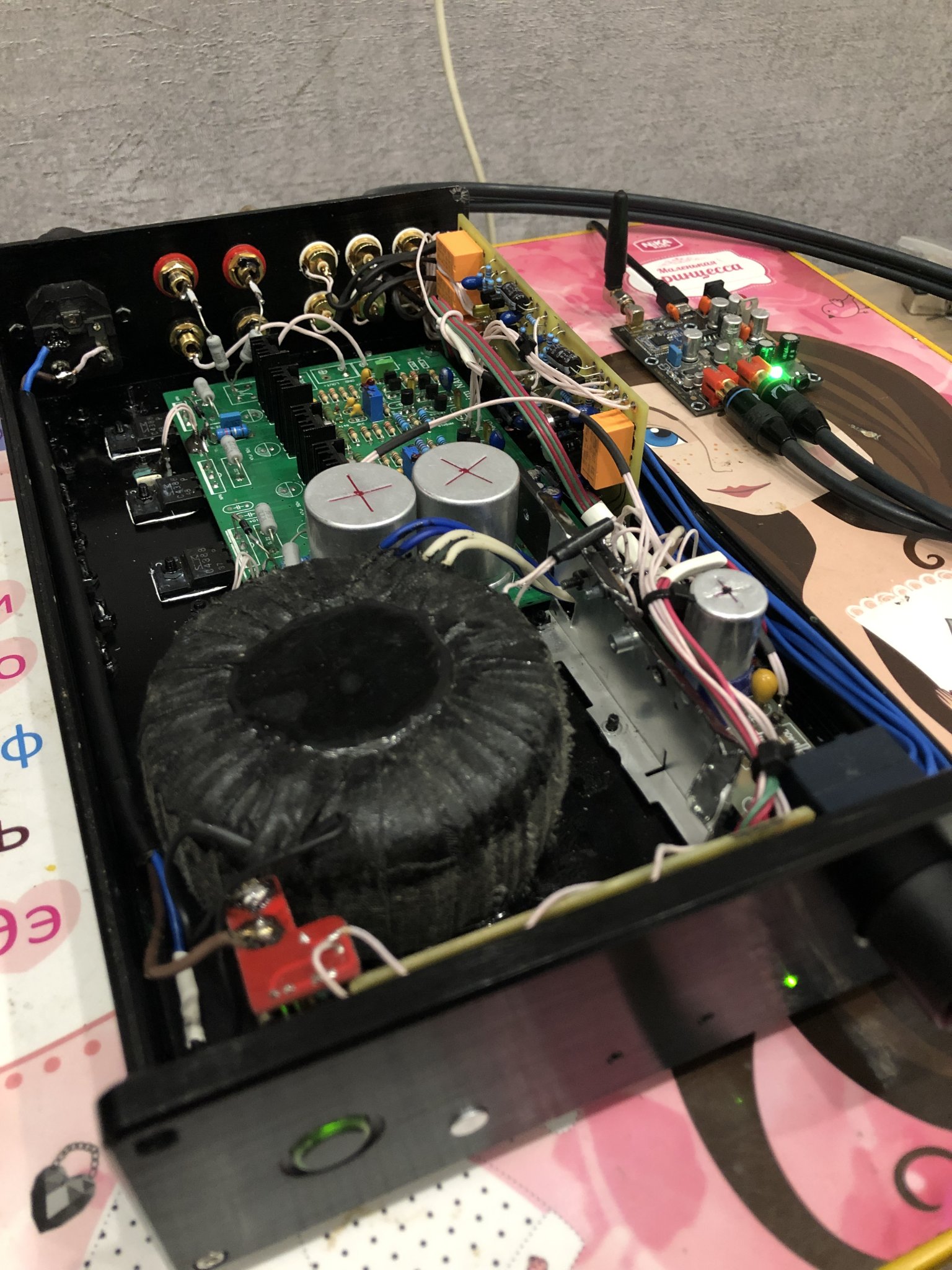

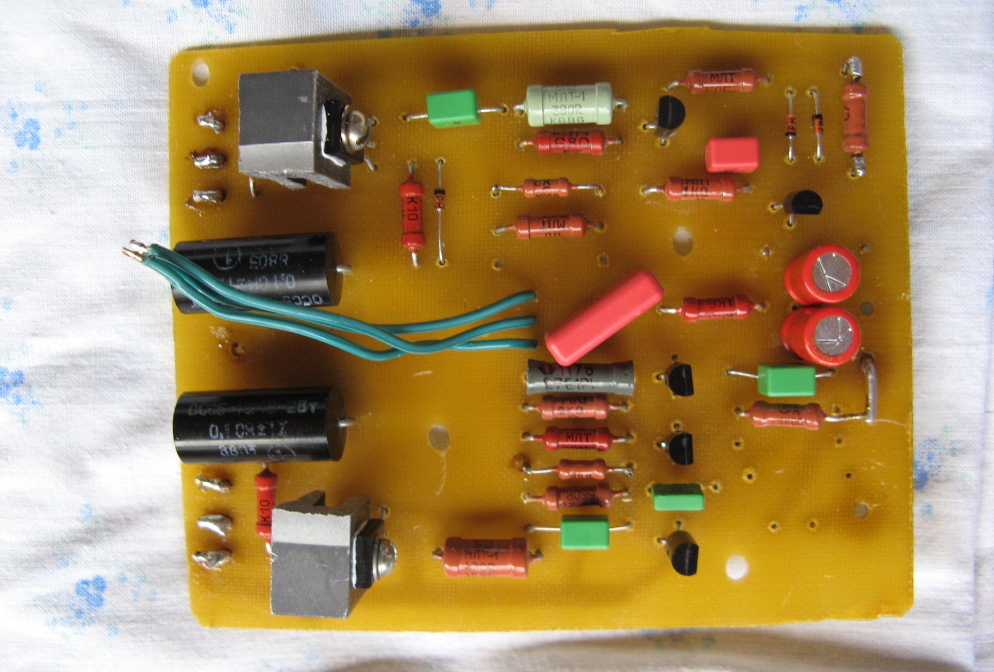

Please watch in attachment photo this setup of old NAP amp working about 10 hours and not overheating.
So in my very early clones of nap 140 in 2009 year I have same problem with overheating and I relocate VBE bias to radiator (very early clone of nap 140 )Static current less than 10mA

Green wires in attachment photo for VBE bias triode )
Oh long long time ago …)) in 2009 year I not think about anything I just clone NAP140 with audiophiles parts )) hhhhh

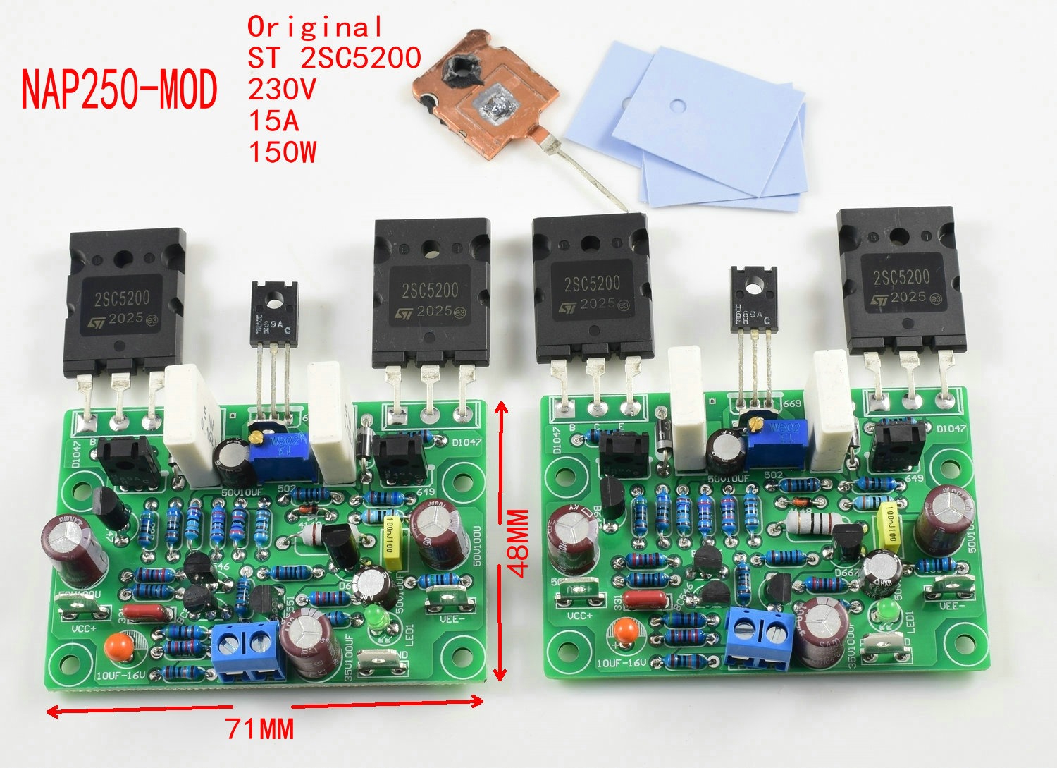

I recommend a modified version of NAP250 MOD.

I think the original design boards is better and have a over current protect circuitNO。 I do not recommend NAP140. It's not good.
#24 reference resources
But size of boards is big
