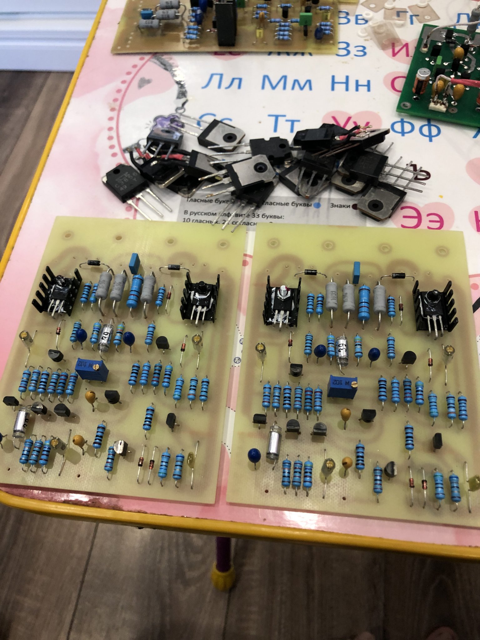

Good day

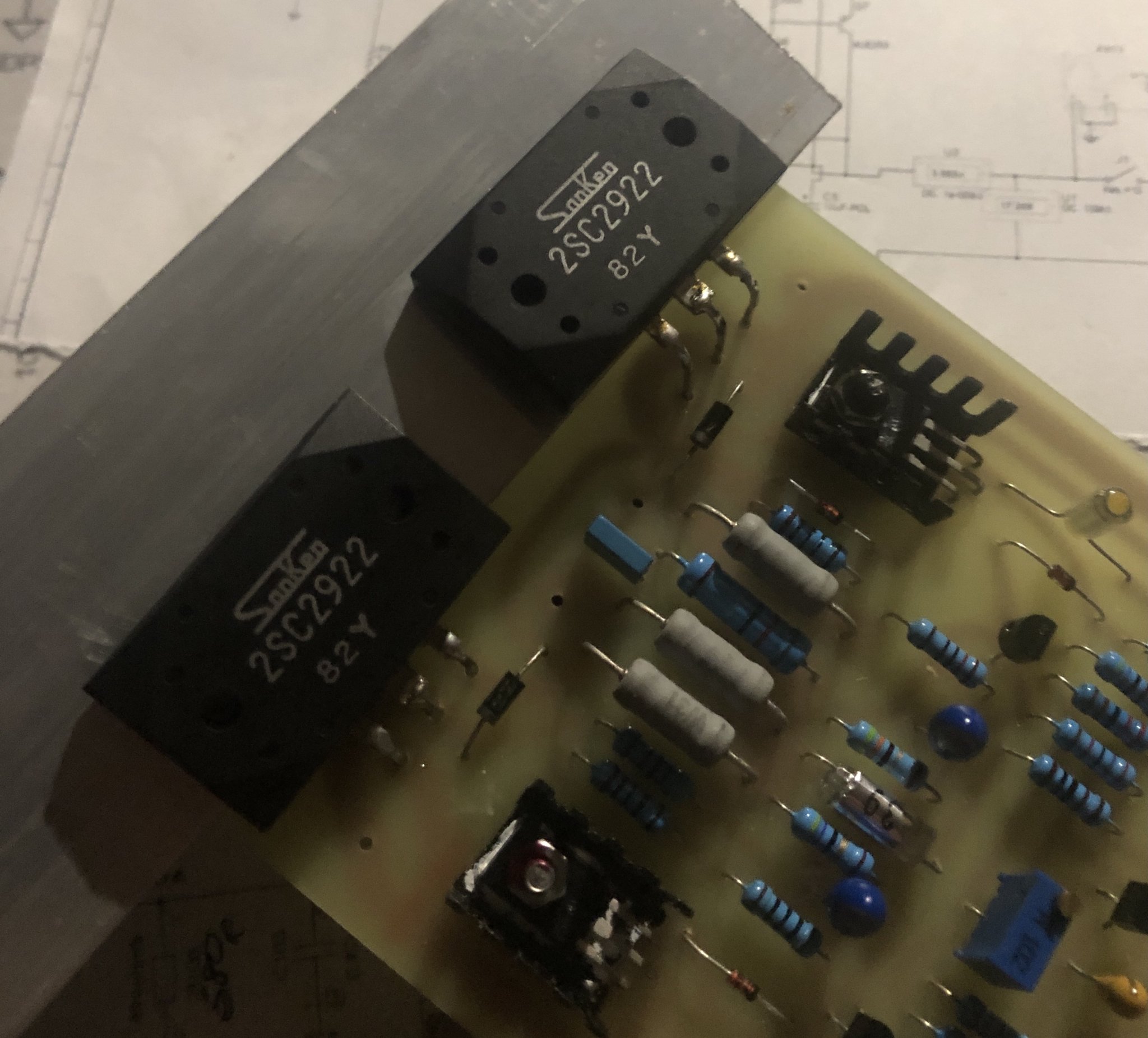

Ohh I buy the aluminium angle for heat stick
And I hope I cut right pieces for nap140 boards ..

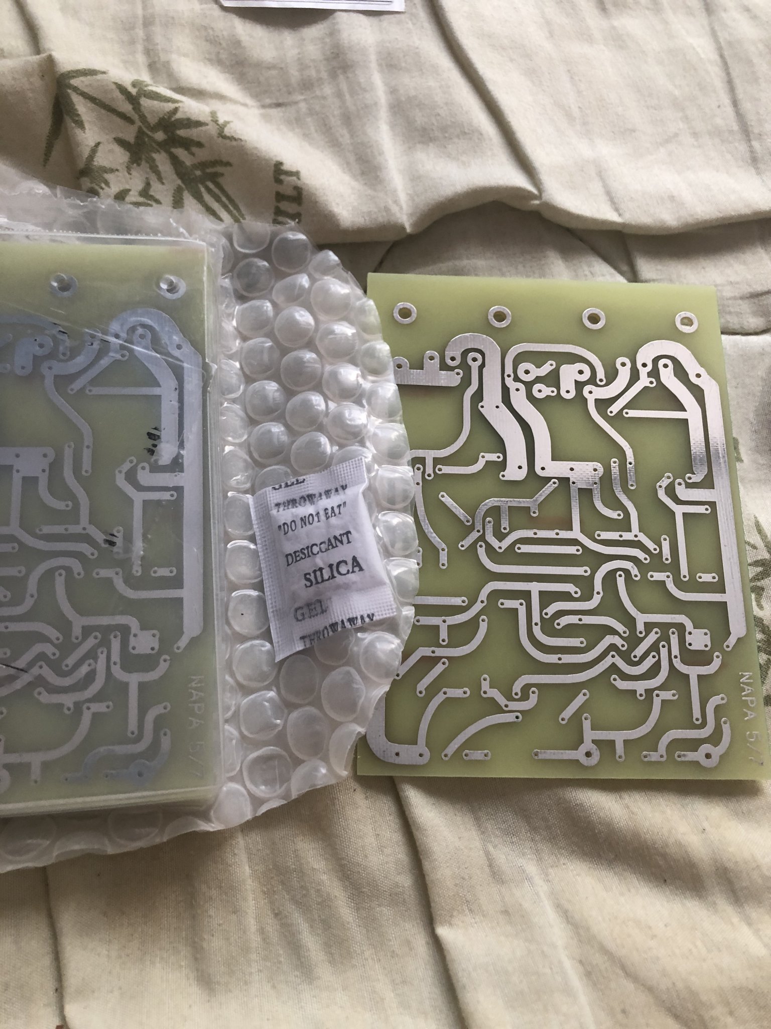

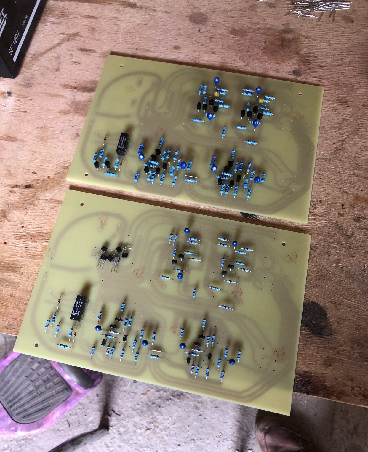

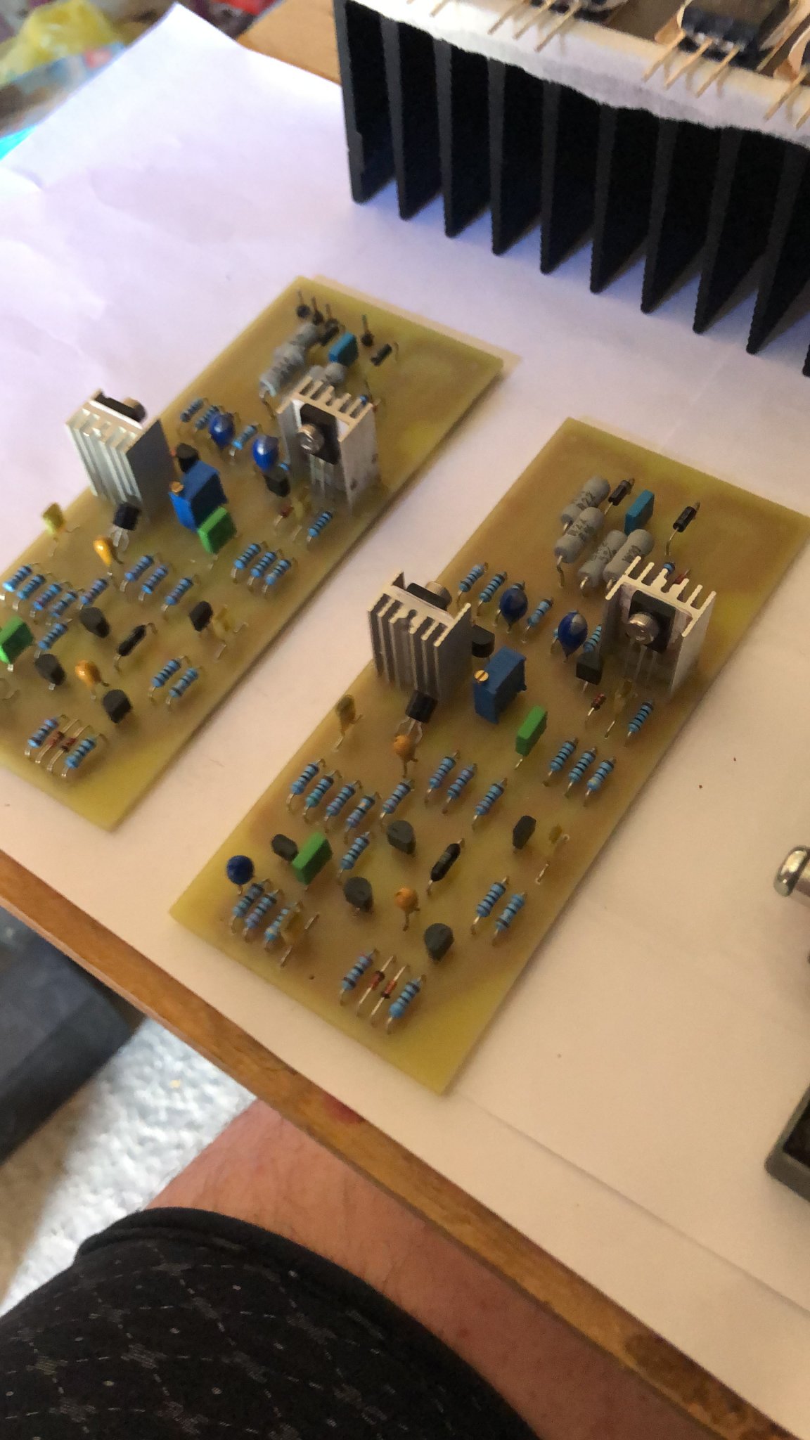

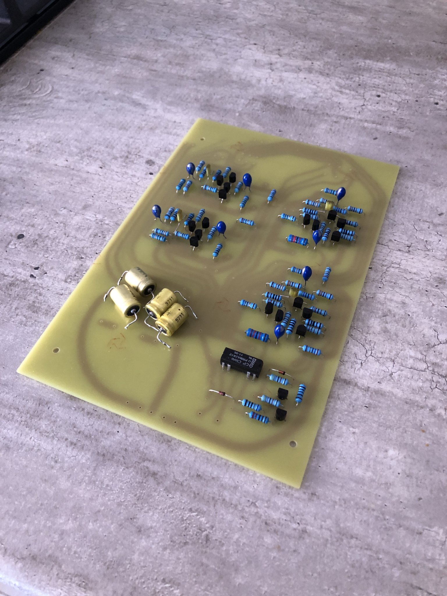

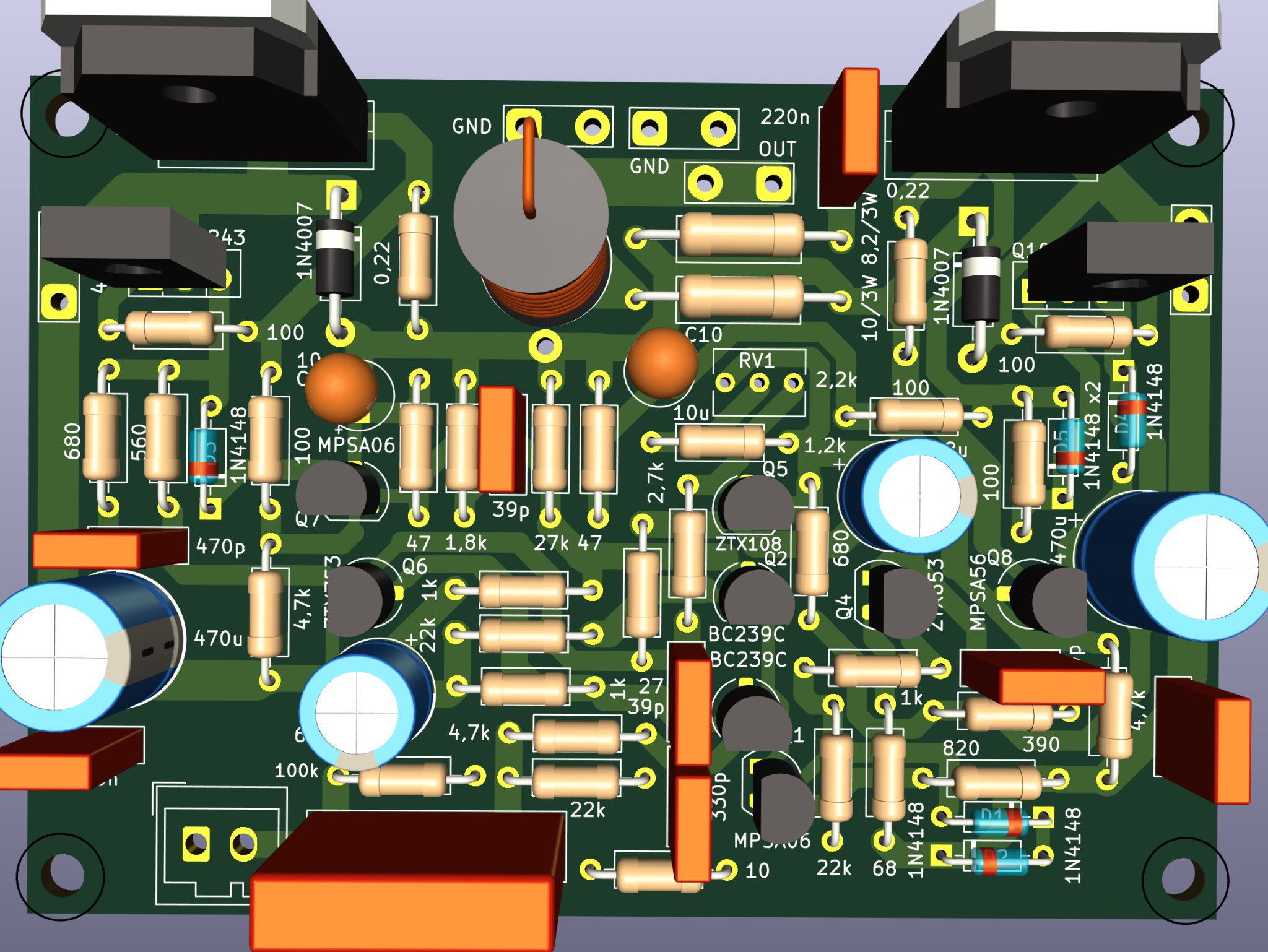

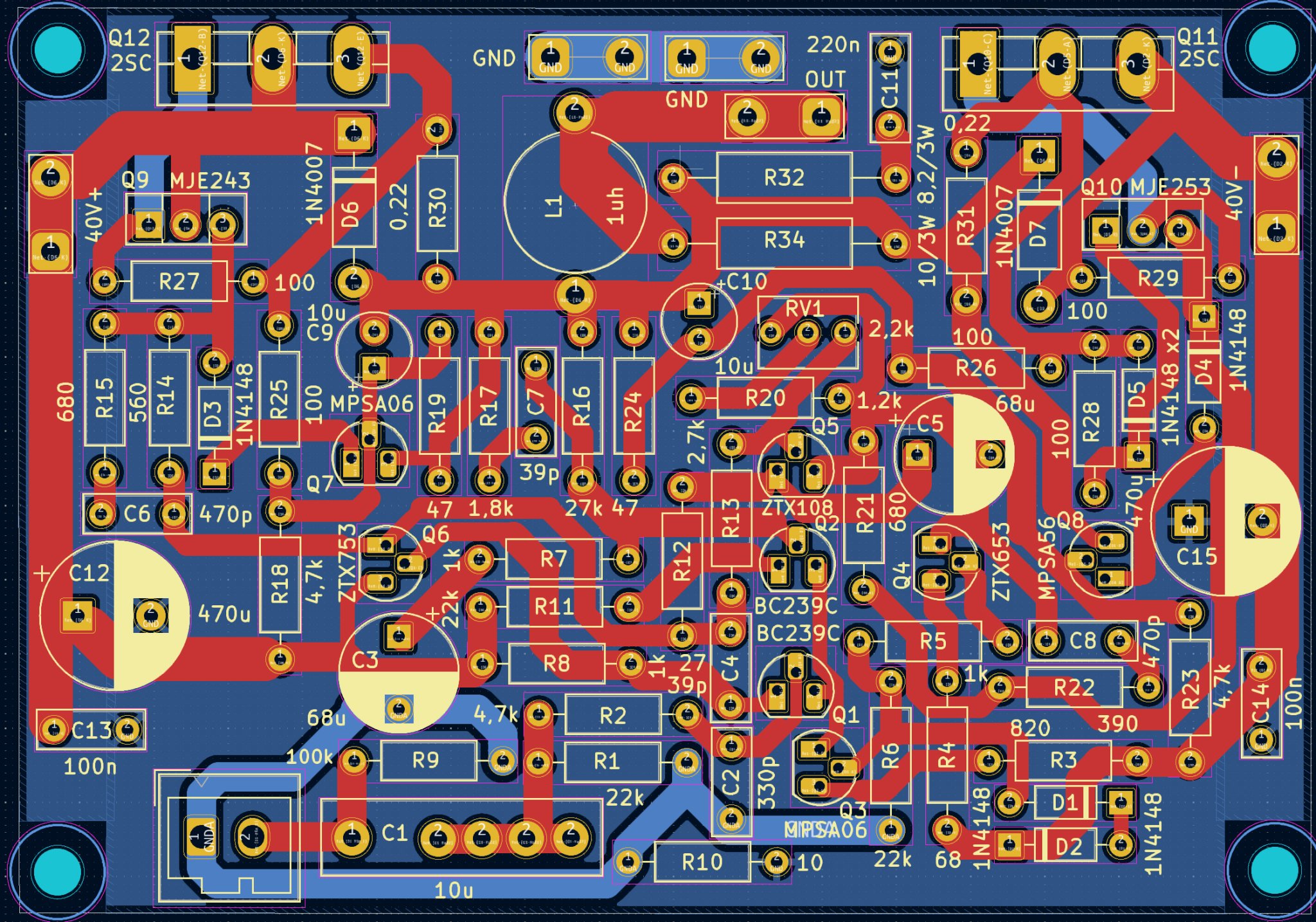

Because the original boards are so big, i made a new pcb. Dont know if it works in the moment. I had to order some components. The new size ist 88,5 mm x 62 mm.

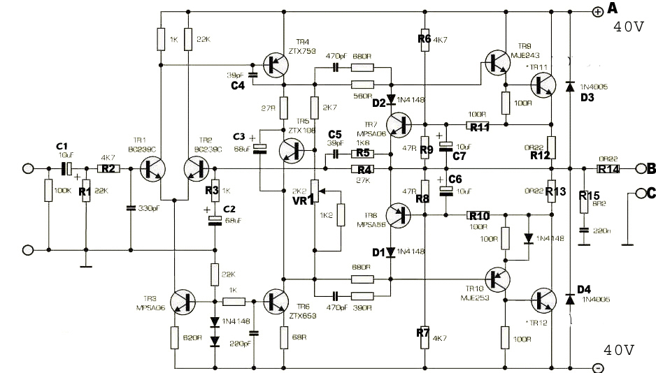

I have taken an original plan. I think i haven't read enough. If i use the the 2SC Sanken, i have to change some components, but no problem with the pcb, only the values on the board are wrong then.
Have a nice day and week
Peter
