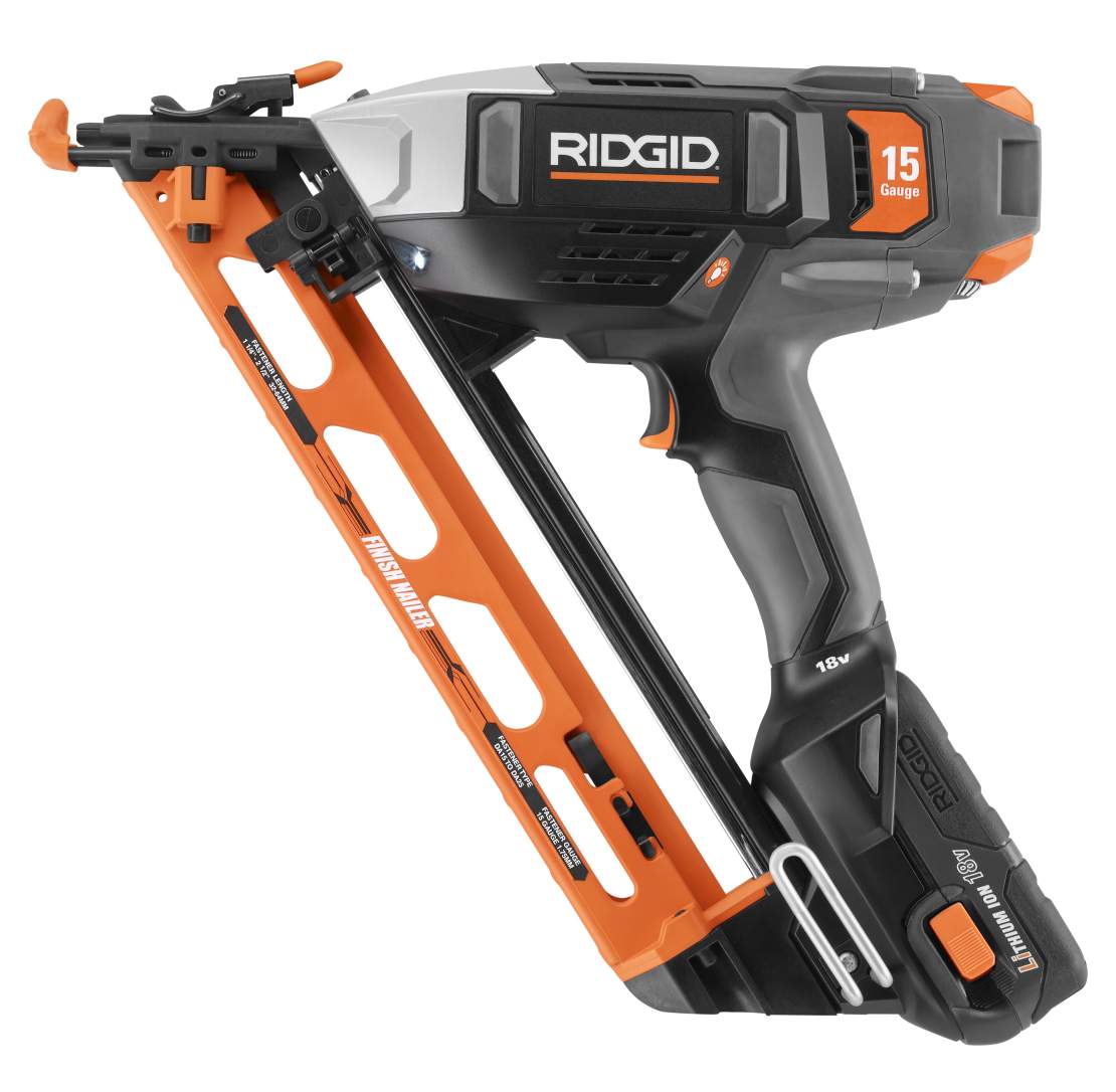

As for nailers this is my new favorite toy for job site work:
Good for when you don't want to carry around a compressor or if you don't have a compressor!
