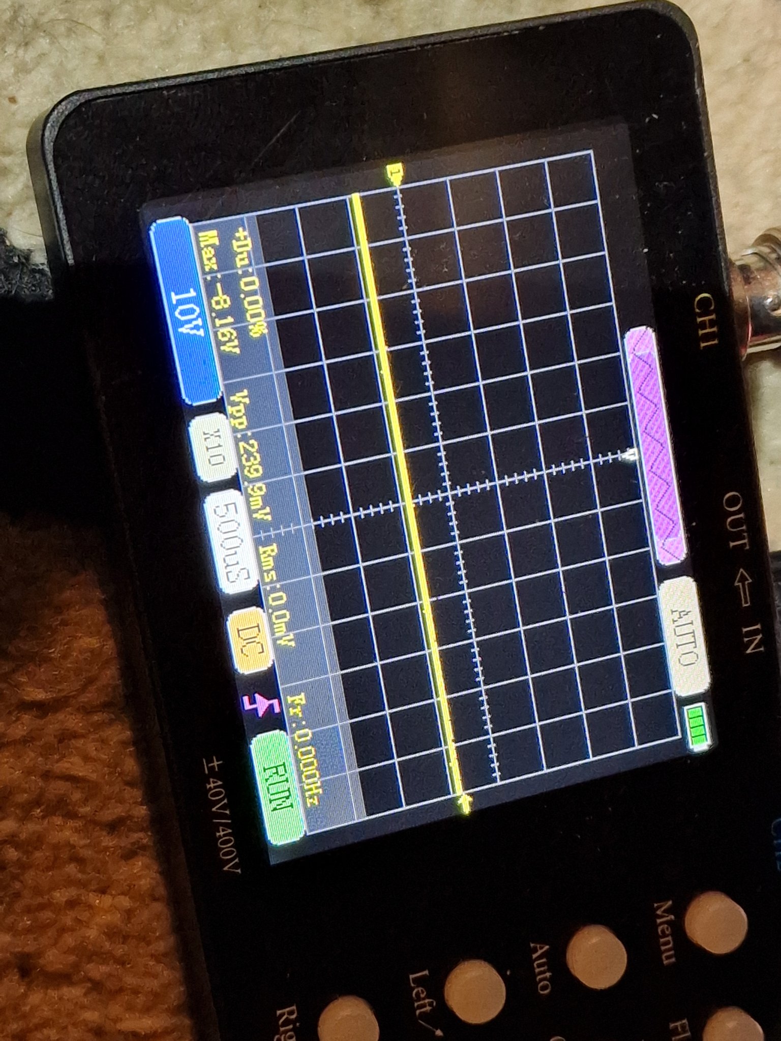

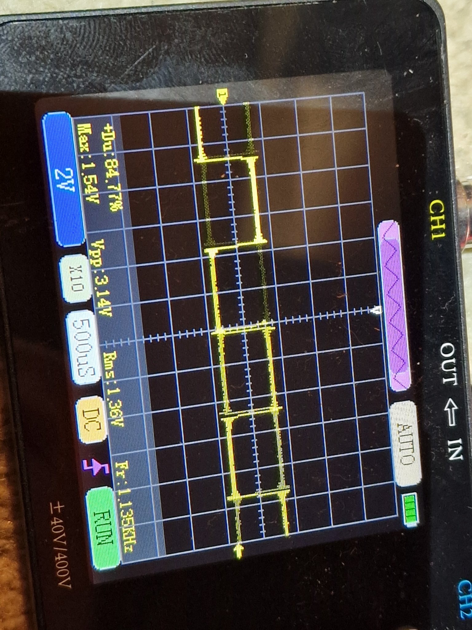

Not sure if you'll see the update, but in doing as you said, I've narrowed it down to the multichannel board.
Just not sure what to expect from this IC, I'd just assume the readings in getting are showing an issue with the m62447sp IC...
I could be wrong, but i wouldn't think the waveform would flatten and drop in strength by a few divisions. Square wave is on input pin for front left and right, the flat form is output pins

Check something for me- A really easy way to see if a stage is passing audio (on low voltage circuits only) is to use a fine point pick, held by your hand, to touch various signal points in the pathway. (Don't short between components or pins.) Your body acts like an antenna, picking up hum and injecting it into the circuit. Use the pick to touch the FR, FL, and C input signals to the front amp PCB, near R5134, R5135, and J541 or the connector pins. If the front amp is working correctly, you will hear a click or pop, and a loud hum or buzz from each speaker output as you touch it's input (Beware, it could be QUITE loud, so use very small disposable test speakers rather than your nice room speakers). If you get that for all channels, you know the front amp is working, and the problem is upstream. If it does not make this noise, you know it's the amp. You have done quite a lot to this amp, and should make sure it's still working properly.
Assuming the amp works, move upstream, injecting the signal at various places, and it will tell you where you are losing the signal.
The volume chip is digitally controlled through a serial interface. Your second picture clearly shows 1's and 0's of a digital serial connection, not an analog signal. If your front amplifier board is working according to the previous test, and you believe the problem is upstream, pick the outputs of this chip and make sure you get the buzz, and if you do, pick the inputs to the chip turning the volume control up and verify you get the signal out.

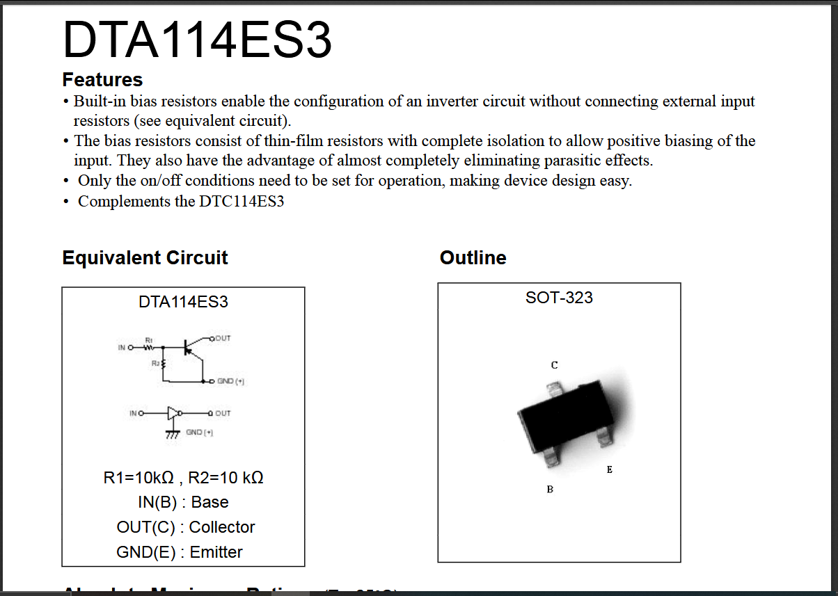

Look at Q611 and Q612, which are the NPN mute transistors for the outputs of the tone board. The collectors (c) pins are tied to the signal. The emitters (e) are tied to ground. Turning these transistor on (taking the base (b) pin more positive than the grounded emitter since they are NPN) shorts the signal to ground, muting it. The transistor driving these two transistors is Q614, which is a PNP. When Q614 is off, the -12V pulls the bases of Q611 and Q612 negative, making sure they are off. So, to mute the audio, the Front Mute signal (pin 7 of J705B) is pulled high (probably to 12V, but could be 5V) so the emitter (e) of Q614 is pulled higher than the base and the transistor turns on (since it is a PNP), pulling the collector high, which turns on Q611 and Q612.
Now, Q614 is the funky dude shown below. We're interested in what is happening at the e pin. If it's a positive voltage, then Front Mute is on and that is why you are getting no sound through the tone control. So, check that voltage, and either side of R694. If that is positive, mute is on.
The center mute works exactly the same way. Center mute (pin 9 of J705B) when high, drives Q616 (e) high (same dude as below), driving Q616 (c) high, pulling up the base of Q601, turning it on, shorting the center channel audio signal to ground and muting it.
