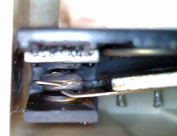

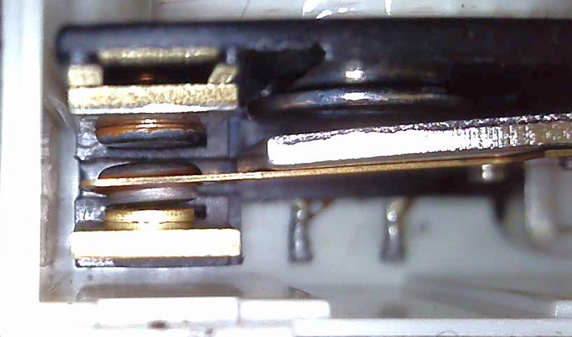

Actually, that description of what the relays are doing wasn't as clear as it could have been.
One relay is operating normally. It clicks in a few seconds after power on and immediately at power down.
The other relay was not clicking in after power on or at power off. As a result, I was seeing significant DC voltage at the speaker terminals, e.g. up to -95V at power down, before the caps drained. After tapping the relay case, I got it to click in, but not consistently. So I opened it up for inspection. The bad one is on the left (obviously). Needless to say, new relays are en route.

Are you sure you haven't a real DC offset fault here?
The relays can not operate separately, if one is energised then so is the other.
Not clicking audibly could be because the contacts are frazzled but electrically it is wanting to close. Actually even the lower part of that relay looks in bad shape, the arm holding the contact.
Ok, I visually observed the relay contacts, while monitoring the DC at the speaker terminals.
A few seconds after power on, both energize. At power off, both de-energize. I think you're right that I wasn't hearing the click because of how deformed the bad one is. In addition to what's shown in the photo, the plastic area above the contact is blackened from the arcing.

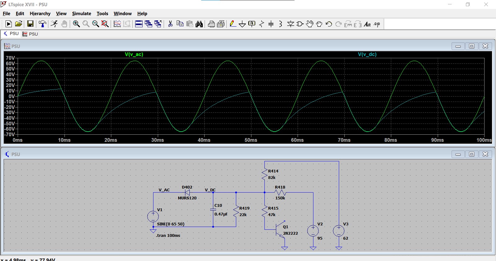

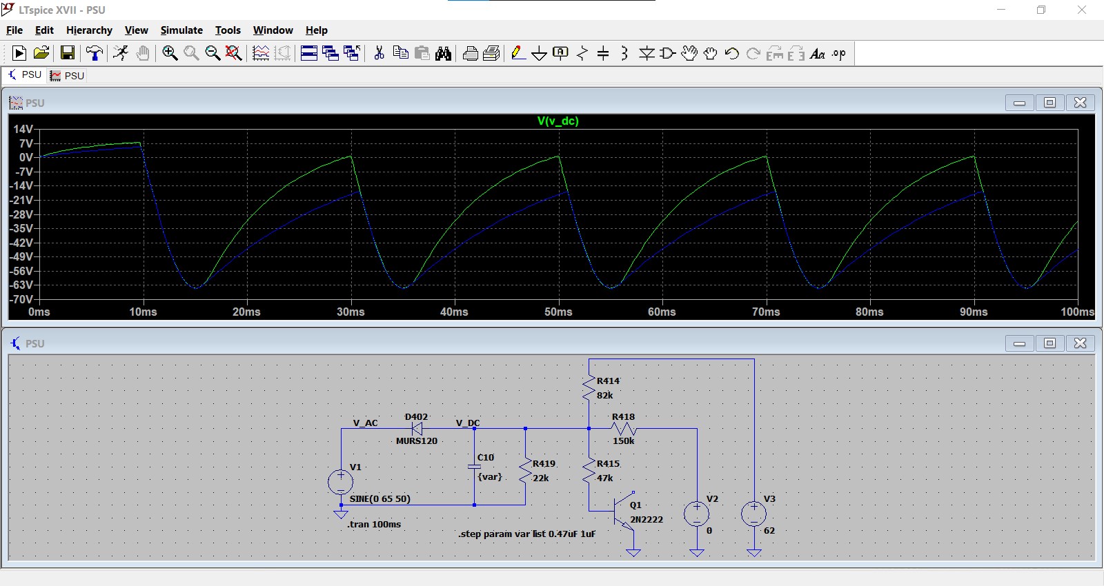

Lets look at it like this.

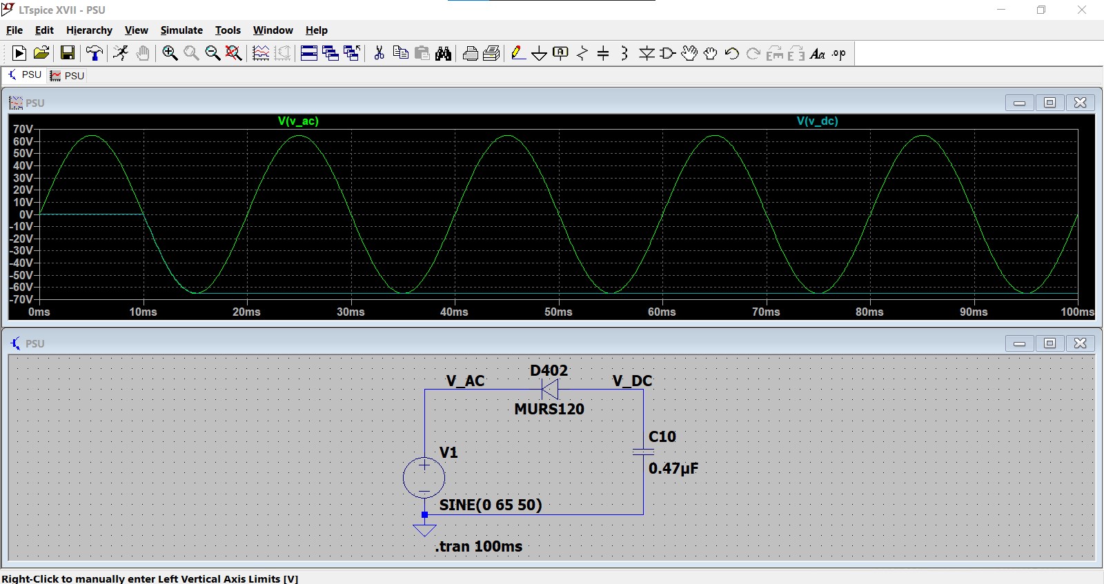

1/ You have 46 volts AC from the transformer. That means a sine wave of 46 volts RMS or alternatively a 65 volt peak (130 volt peak to peak) voltage. Image 1 shows this voltage. The diode conducts on the first negative half cycle and charges the cap to the peak (negative) voltage.

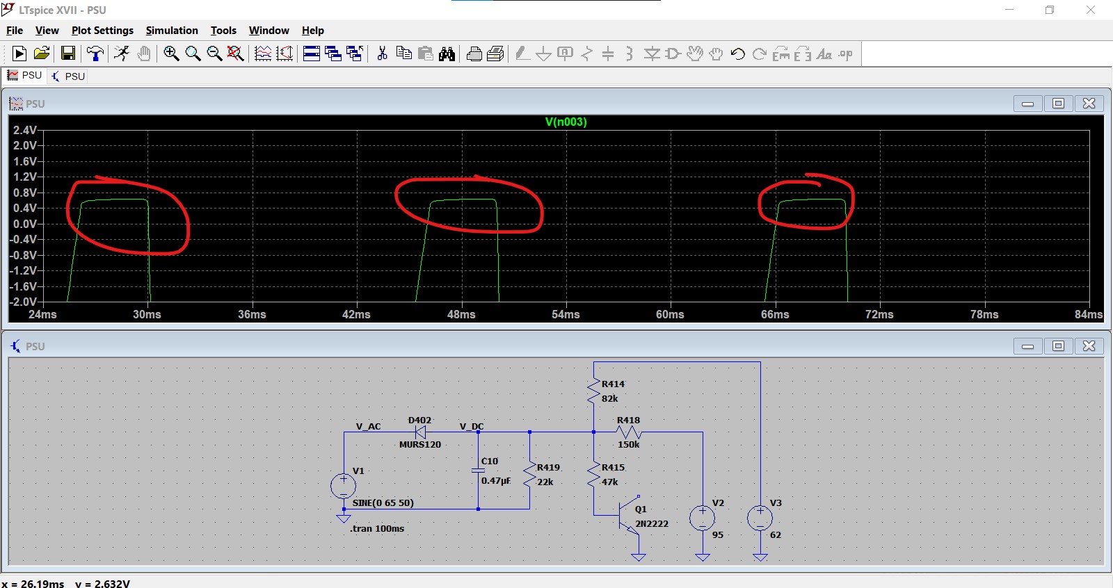

2/ The cap is loaded down by various resistors. Image 2. Q403 is a bit of a balancing act with R414 feeding in +62 volts from the main rail.
So this shows how the voltage would be on a scope.

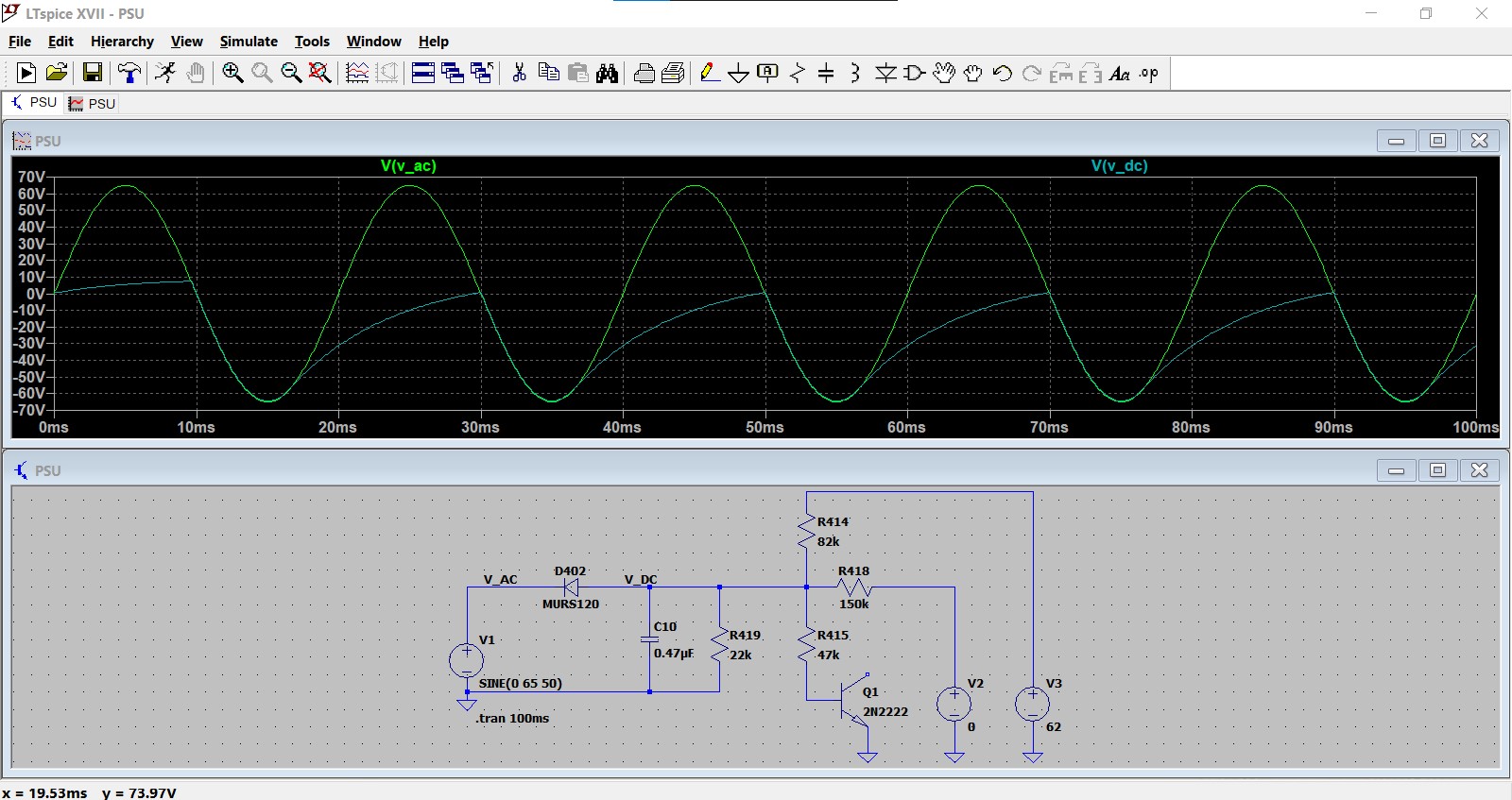

3/ R418 and pin 1 of the chip. Those overcurrent transistors in the power amps can only apply 95 volts via the 180k's into pin 1. The chip would clamp that but lets be silly and apply 95 volts. Image 3

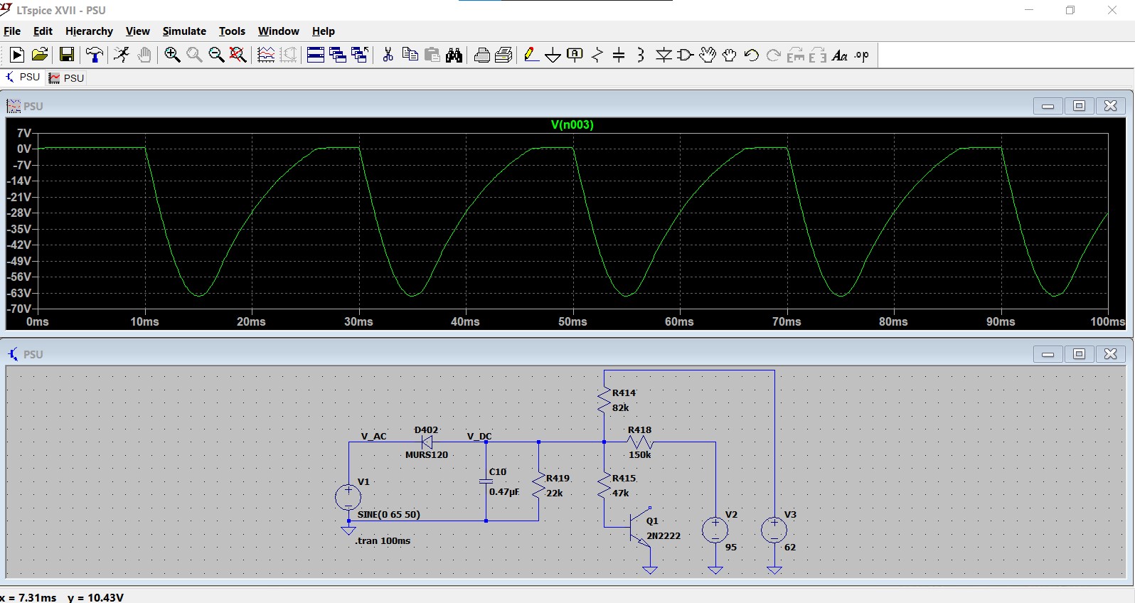

The effect of this is subtle. The transistor Q403 is now brought into conduction. Image 4 and 5.
The base /emitter volts is now pushed into conduction clamping at around 650 millivolts. That would light the LED it drives.
None of which explains the difference you are seeing between the two amps 🙂 You would have to use the scope to look at the waveforms and compare and see why it is as it is.

Thanks for taking the time to put together that Spice model.

The scope should definitely show what is happening. The diode has to produce a half wave pulse equal to the peak of the incoming AC. The cap has to smooth it to pure DC, which would be -65 volts. The we add the loading... and see where it all falls apart.
Let me run a 0.47uF vs 1uF for interest.

Here we go. Blue is the 1uF
Ok, thanks for modeling this.
