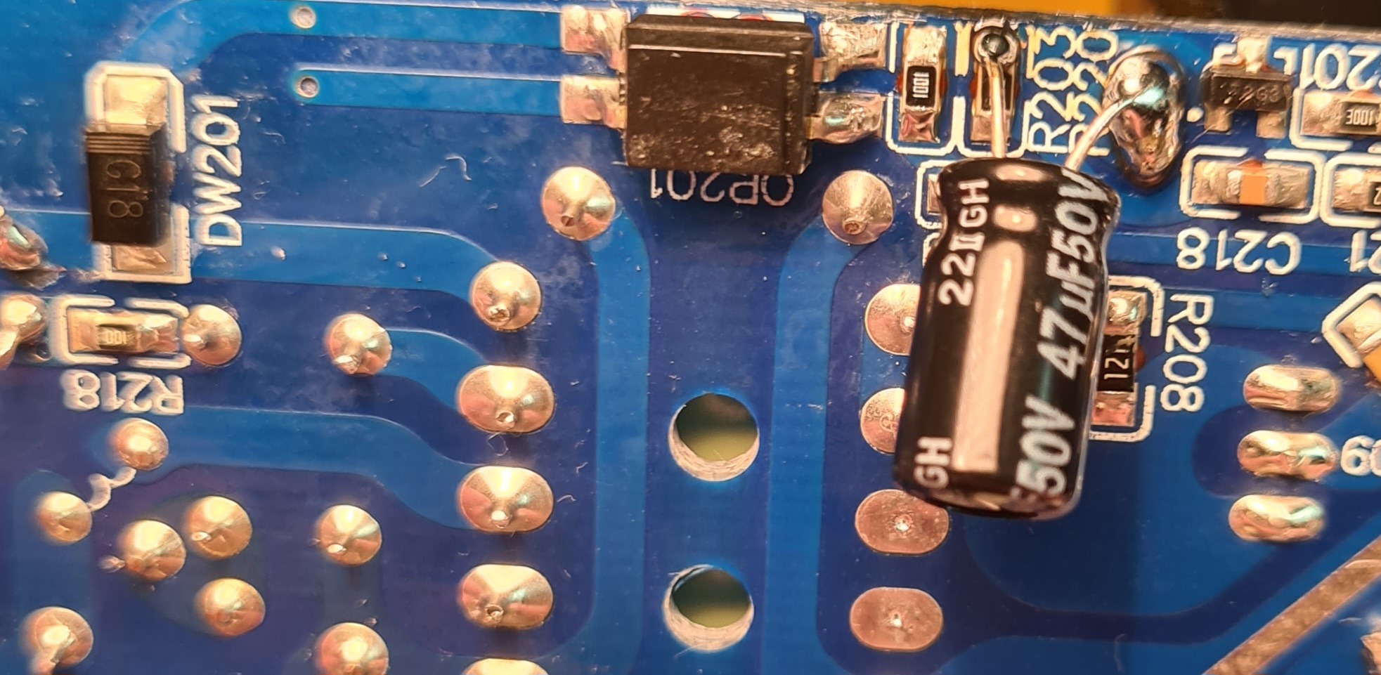

This is the simple soulution for the power on failing/black screen issue. The value of the capacitor is crucial or there may be oscilation problems. I've used a low ESR Panasonic FR series as this was the only capacitor I had at hand at this size. 47uF/50V. This will ensure enough impedance versus the TL341 at the higher frequency that will make the curcuit "sing".
Further I've seen people only removing DW201 diode with good results. Lower temperatures and no power on problems. This diode is not on the schematics either(?). I've opted to not do this.
And to add further more, the 431 will be stable when the Vca/Ica is sufficiently high. Therefor, no need for more complexity than to just add a 47uF capacitor. If we read the Texas Instrument paper on stability, they state a capacitor range lower than x and higher then y. Y being 10uF. But they have later Said that 10uF may not be enough and right on the threshold. The reason for using 47uF, is to take ageing into account.

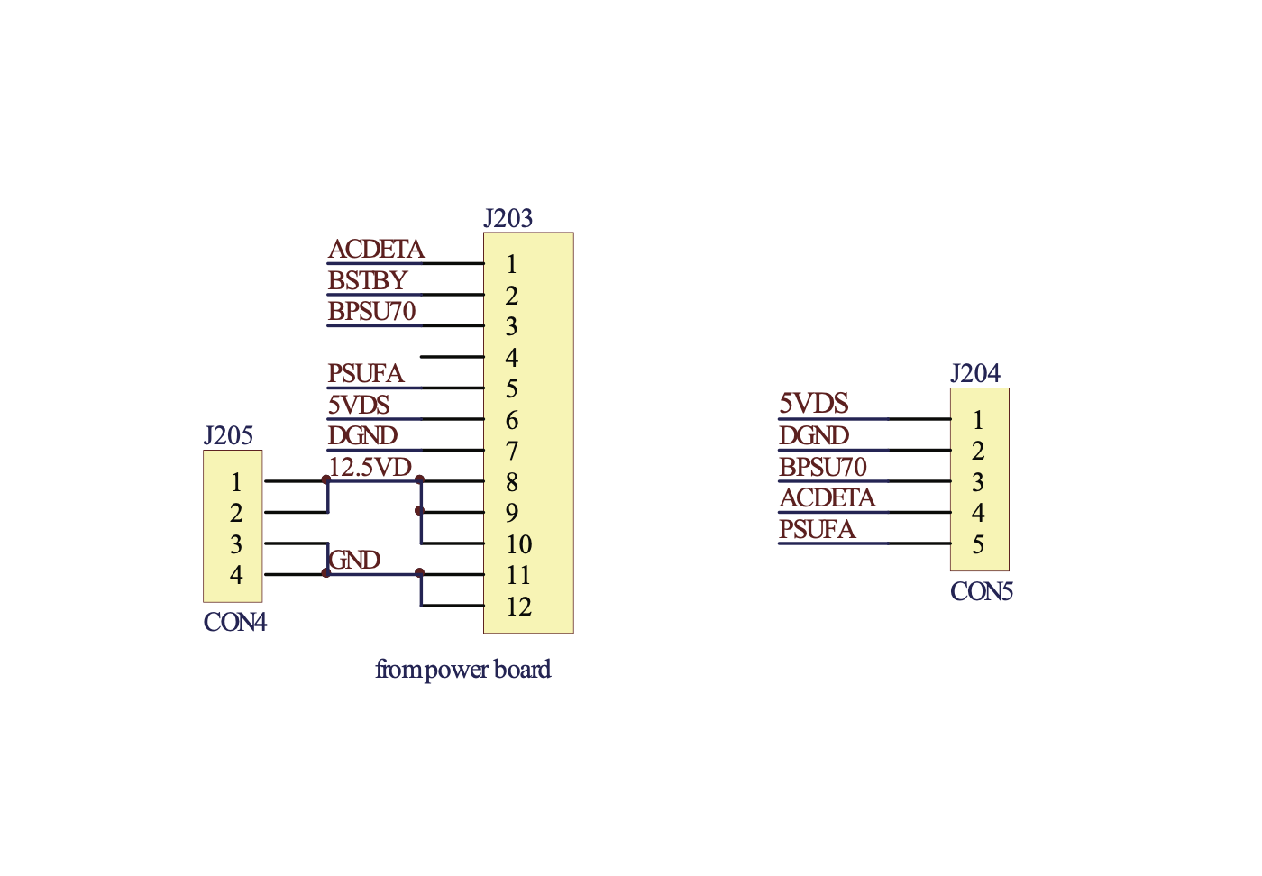

I've owned this amplifier for 11 years. It started not powering on about 7 years ago. I responded by leaving it on 24-7 which worked well until now. Unfortunately it recently it got turned off and would not restart. I've replaced all of the suggested and bulging capacitors in PSU-B to no avail. I have not yet attempted the Henk / Johnips solutions of additional capacitor.
As an alternate (much more cowboy) solution can I just use another 12.5V or 12V power supply to juice directly into the wiring for the cards that use 12.5V? Looks like just a few lines on the 12pin connector J203 and the 4 pin connector J205.

You should change all capacitors, and especially the ones close to heat sources, and not to forget the high voltage one. And please do add the capacitor as described above. This is a design flaw in my opinion.
There are two circuits almost identical. Only the one needs an additional capacitor.
