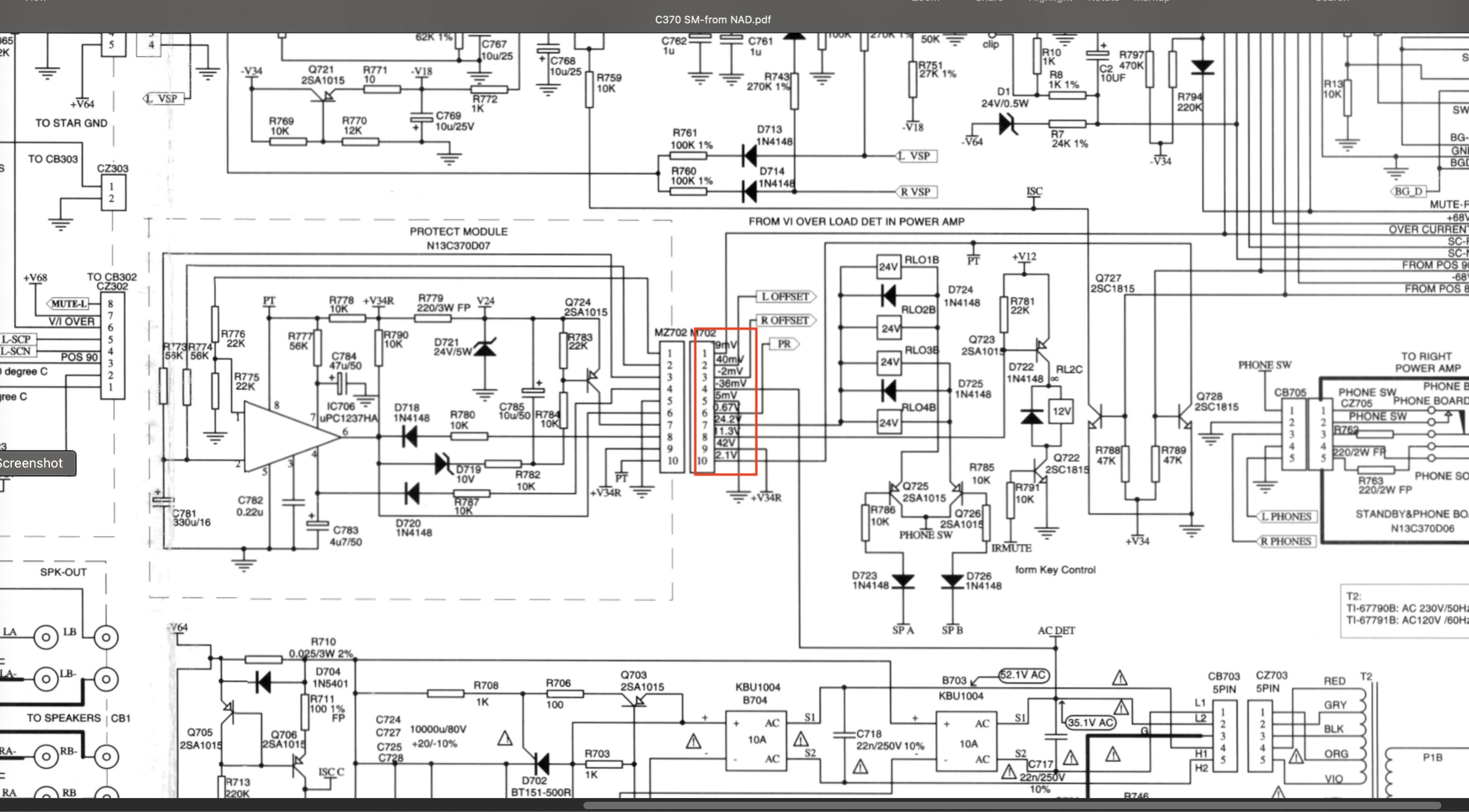

And last, should I trust service manual values at the protection circuit given that they show different values for L and R offset and some other discrepancies like "42V" on the 34V rail?

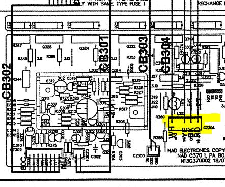

Consider disconnection power to the power amps, ie, disconnect connectors CB304(L) and CB404(R) and see if the voltages normalize, these CB's provide both power and GND, suggest use a jumper wire for the earth/GND connection just in case
Do you mean while the power umbilicals are connected to the amp boards?
As you've already done, disconnect the connectors and see if the power supply normalizes, ie, check female connectors of CB. I noticed that the connector also included a GND connection, which would be broken when the CB was unplugged. I didn't do any anaylsis of consequences of breaking this GND path, thought easiest to just jumper the GND in unlikely event...

I've taken some more measurements.
First, something I didn't mention before that may give a clue - the power light goes from orange (standby) to green (ok) and then back to orange (when protection circuit fires). At no point is the light red.
PSU -
Voltages on xformer secondaries are correct. Voltages from PSUs (after rectification and caps) are too low. I'm not sure what to make of this for two reasons:
1. The amp is actually on for just a split second at a time before protection shuts it off (I take measurements by videoing the meters in slow motion and scrolling frame by frame to get readings). Perhaps PSU doesn't have enough time to supply needed voltage?
2. There are 3 PSUs (68V rails, 64V rails, 34V rails) and they all behave the same. This leads me to believe it's not an issue with power but rather, as mentioned above, they just don't have time to provide needed voltage before protection shuts everything off.
