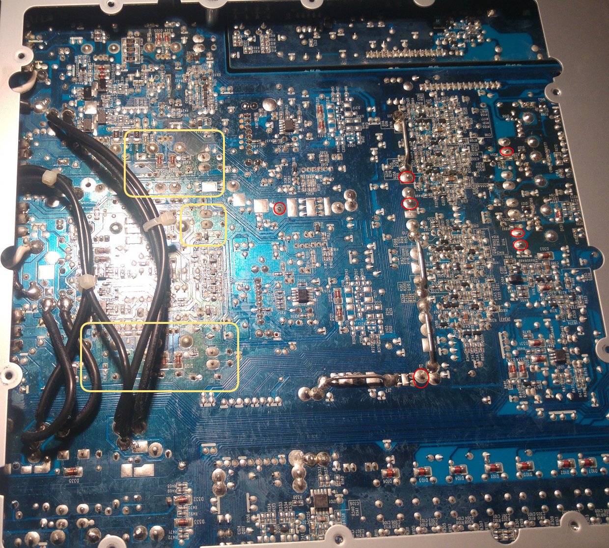

Its really SMD hell there
Wow, pretty busy on the foil side there.

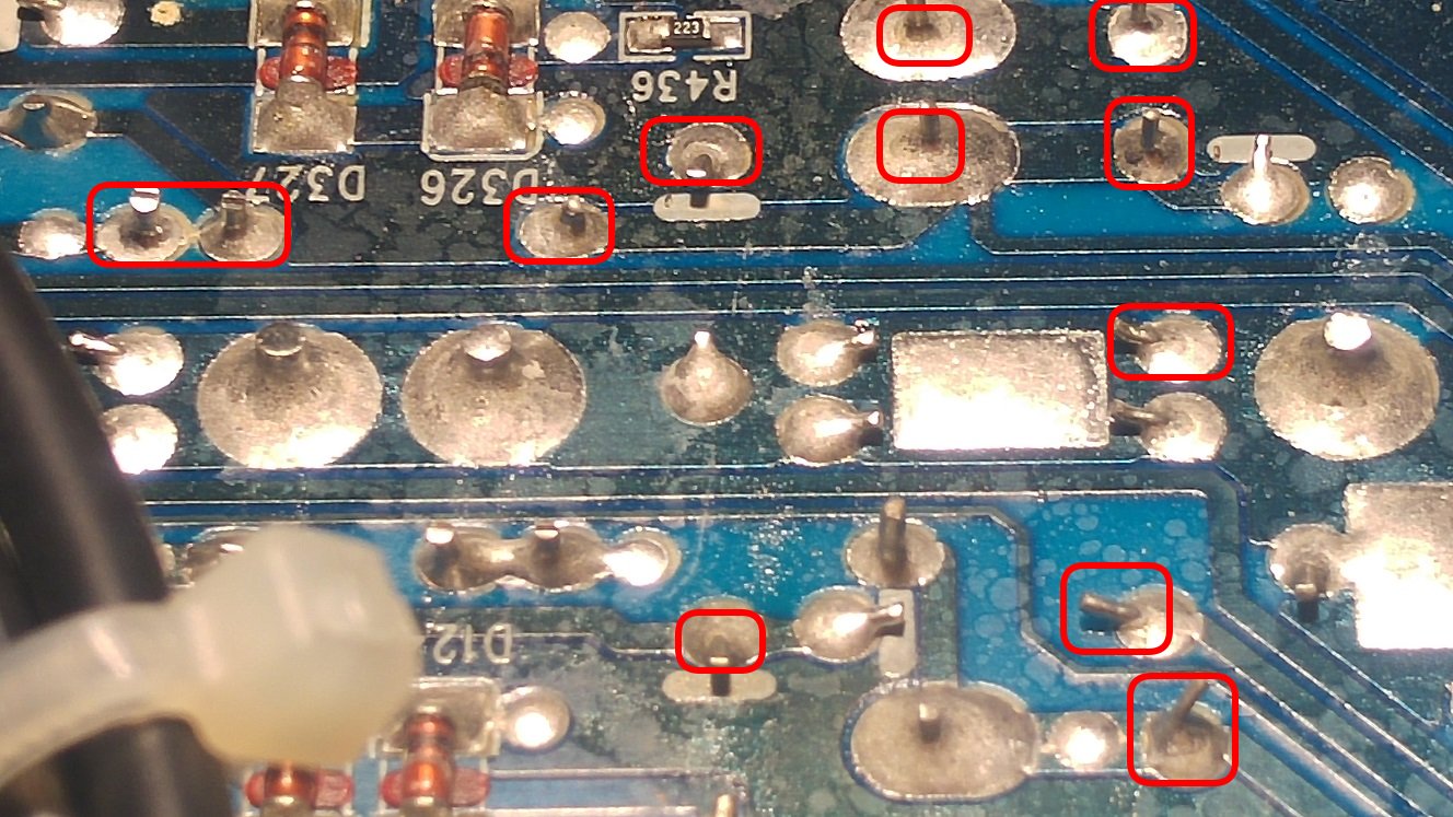

But looking at those pictures I can see suspect solder joints from the top-mounted components. Some joints (red-circled-areas) have that bulls-eye ring look.
Also you can see the discoloration (yellow-circled) areas, these components producing lots of heat can weaken joints from the hot-cold cycle. Just some
areas I'd take a close look or just reflow (or remove and reapply fresh solder).
These yellow areas are around places where Q342, Q344, Q142, Q144 are installed.
They give a lot of heat.
Hope this issue will be fixed once I replaces zener, so current through these transistors will become normal (lower).
There are a lot of joints with bulls-eye ring look. In hot places and cold places too.
I think they come from factory like that.

About the solder joints being factory, maybe. Probably a combo of poor QC and wear-n-tear on parts.
NAD didn't (still does not?) build in their own factories. They are a "design house only". So the actual physical creation/assembly of their products was contracted to companies in Asia. So QC has always been an issue, IMO. It was how to keep overall costs low making high-end equipment more affordable to the end consumer. All that being said, when the NAD designs are operating they are sounding great (proud owner of a 7125, 3155, 314, C325BEE and the mighty 310......and 5120 turntable).

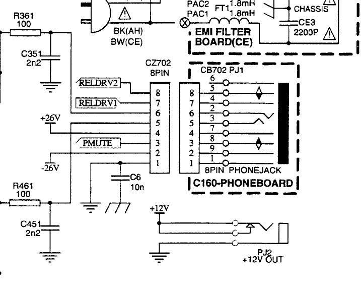

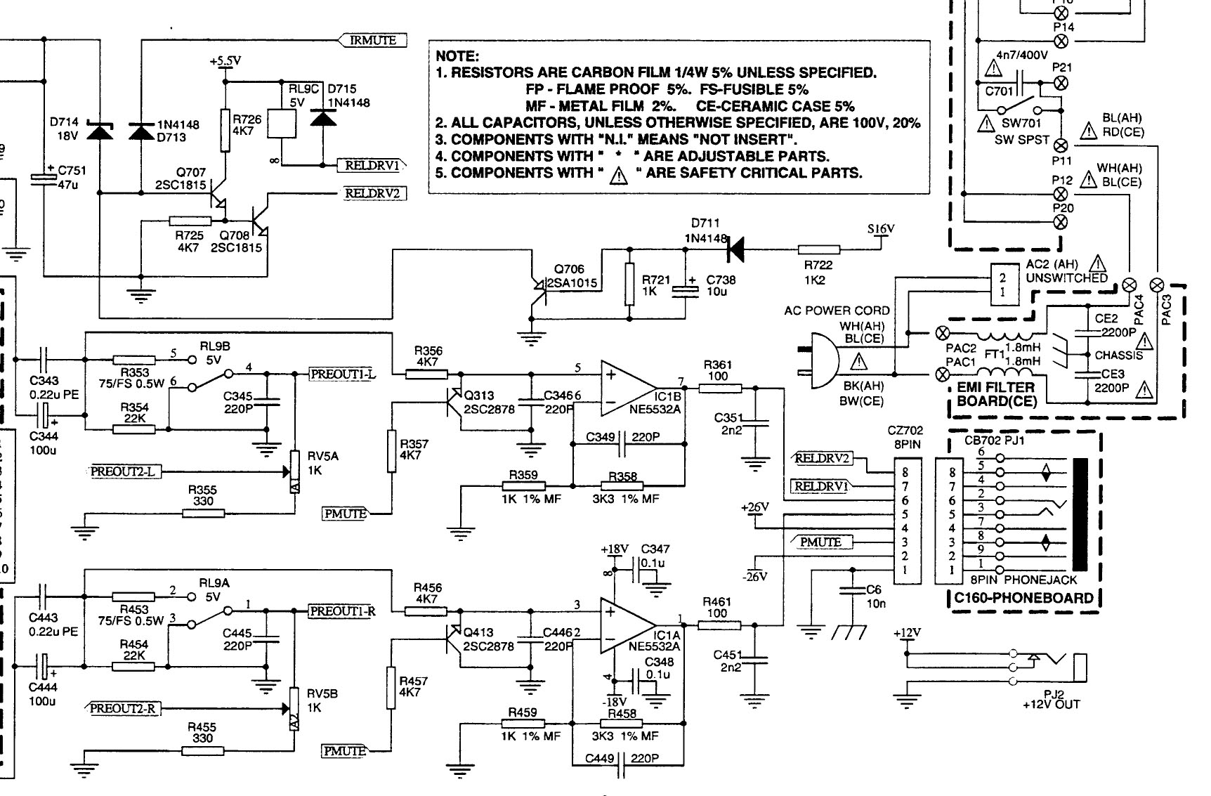

Hello,
I am a new member and I am not sure how to go about revisiting an old post or starting a new conversation so please advise me.
I was just reading the posts here as I own a NAD C160 which started misbehaving recently. My system includes one NAD C160 which feed two NAD C270 Power Amps, connected in turn to two Martin Logan SL3 electrostatic speakers.
The outputs from the C160 seem to have died (both PREOUT1 and 2). With earphones plugged in I hear sound from the test CD player. I have opened up the C160 and looked at the main board: Aside from glue around the large caps (it does not look like leakage from the caps) I don't see any obvious dmage to any component. The fact that neither the L nor the R channel have any output makes me think that the fault(s) may be with a section that addresses both channels at the same time: I am thinking of the earphones plug/board and/or the components which are used for Muting from the remote IR controller (see HeadphoneBoard and PREOUT1&2 images). I have started to measure some voltages at the earphones board: Pin 4 should read +26V (according to the schematic in the Service Manual) but it reads only +14V. I also measured the two spots marked with the Red and Green circles in the PowerSection image I include: Although at the Green spot I read about +27V, I read about +14V at the Red spot, which should read +26V.
I am not versed in amplifier electronics as I would like to be, any ideas or suggestions for where/what to measure are greatly appreciated!

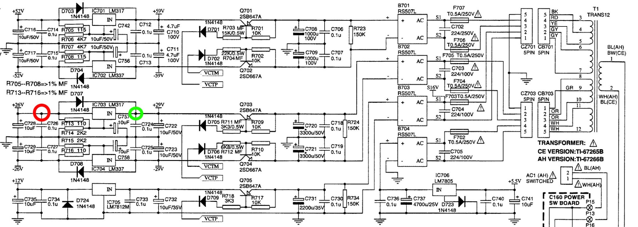

You should create a new post for this pre-amp.
Within the post you can reference some specific posts with hyper links (did you search diyaudio for references to C160 issues?).
Aside from this, being both channels are non-functional the power supply would be the best guess to be probing (which you are doing).
Additionally in the power supply circuits I would check for broken solder joints (from heat/cool cycles), possibly heat damaged resistors, small signal diode failures (1N4148). Many of these checks can be done with no power, just DMM resistance and diode checks.
But create a new post.
--Joe
--Joe
