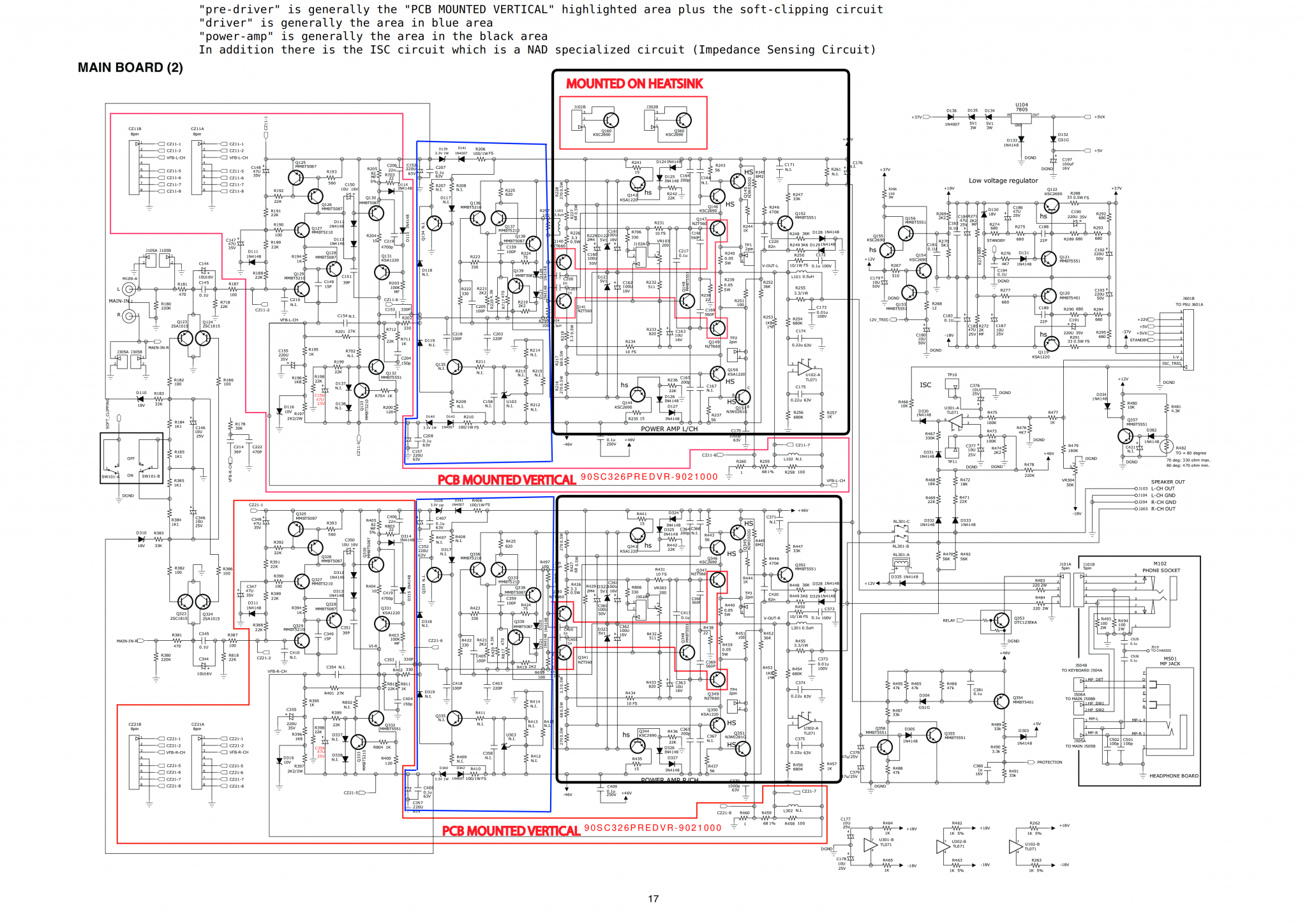

There are three pairs of transistors on each channel (as I understand).
First pars is small (SMD), second is bigger (vertical PCB mount with small personal heatsink) and then comes the biggest one (Vertical PCB mount on huge heatsink).
But I don't understand (due to lack of experience) which pair is controlled by trimpot and which is not.
Please look on attached schema.

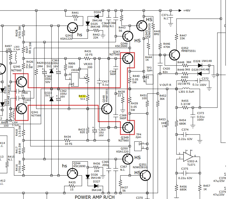

Trimpots have markings of VR103 and VR303.
I measured resistors that are installed in series with trimpots R432 and R232 and they have OK value (slightly above 500ohm, as per spec).
Also both R233 and R433 are fine.

The leaking elements were Zener diodes D322, D323, D122, D123.
After replacing them (with MMSZ5231BT1) I got full control on idle currents on both channels.
While replacing pay attention to orientation, see service manual for reference.

Well you are in the right place and you have tested the series resistors and replaced ( I take it --VR303 /VR103 ) but what about the actual "amplified diode " circuit ( a term for the BJT that adjusts the bias ) .
That --in your case is Q348 an SMD transistor , its either faulty or you have a bit of instability causing insipid HF oscillation replace C417 at the same time,that would be a start.
Its that BJT that controls the driver pair not the other way around.

I tried to go with suggestion of duncan2 and I replaced both transistor Q348 and capacitor c417.
But this change did absolutely no effect.
I have some suggestion on what happened. It can be that during the surge some high level current went through gentle transistors (Q347 and Q347 on diagram) and now they both are just not able to support low idle currents at all.
Does this suggestion has some true in it?
If yes, then maybe next step should be go and replace these transistors?

I would suggest looking at C160, C161, C162, C163 (and the C36x right channel as well). Either check'em with an ESR meter or just replace if odd-ball brands. And if 85C change to 105C temp rating.

If these e-caps are becoming faulty they start to act more like resistors than capacitors (instead of blocking DC currents they start allowing DC currents to flow).
These e-caps I pointed out are after the predriver/differential stage and in the driver and bias stages. So I do think they can and will affect the power amp devices.

Now the situation is that I can still tune one channel (can tune from 1mv and higher any value, very fine precision) and other channel can not go lower then 4mV.

I see that heat radiators of Q342, Q344, Q142, Q144 (and U104) are pretty hot. I can touch them, but can not hold the hand on them.
I would say that they are not normally hot.
Also when I look on SMD side I see some yellow burn in color in amp part.
But in preamp area I see similar yellow color too.
The heat radiators of Q346, Q350, Q146, Q350 are hardly warm.
Also the huge radiator for 4 main transistors stays pretty cold.
But when I put my face over the huge radiator I feel warm air coming through it, so I guess these main 4 are working.
But its not clear to me why to put such huge radiator on them.
Looks like from power amp section only Q342, Q344, Q142, Q144 are working very hard. And rest of transistors are pretty stale.
With all that I get pretty good sound and bass.
My guess is that there is something wrong around Q342, Q344, Q142, Q144.

And I saw that on R441 (SMD RES 15 OHM 5% 1/16W 0603) I get 0.65V, this means that through Q342 I have current of 43mA.
And this is the situation for 3 other transistors too: Q344, Q142, Q144.
In comparison to Q350 (transistors that don't get hot) - there we have 35mA.
When I played with measurements I burned R441 down some how Probably shorted it to 46V and it stopped to work (showed me infinite resistance) and sound on right channel was gone
I hopelessly tried to find such SMD resistor on scrap boards that I brought from trash, but no luck. I had only 10 ohms resistors like this.
But I found one 10 ohm radial resistor 1W and 5 ohm radial resistor 1W.
I put them in series instead of R411 Looks ugly, but works, sound at right channel is back.
But now I measure only 0.45 V on R411! Which gives me fair 3mA idle current on Q342.
Its heat radiator became cooler relatively to heat radiators of Q344, Q142, Q144 which still run with 43mA idle currents.
I don't hear any impact on sound by now, but I understand something is wrong with right channel
Will find proper SMD resistor, will see what idle current I will get with proper transistor.

I try to measure resistance in different points on both channels comparing them to get direction.
In this way I found that C361 and C362 are probably dead.
Some measurements that I did.
When amplifier is off I measure resistance on contacts of C361 is 27 Ohm and 2k ohm on switch of probes.
In contrast to left channel I measure Mega ohms and Kilo ohms values.
C361 sits in parallel with D322 diode (probably is dead/shorted too together with D323).
The idle current on right channel that I measured when amplifier is on is 47mA I guess that's why Q145 is so hot.
Definitely on a good track here, the zeners.
So is Q342 still OK after the mistaken short? Q344 too since it's part of the current flow?
Might as well check those small signal diodes (1N4148) D324, D325, D326, D327 that hold the base node at a 2X diode voltage level.
Just covering all bases.
I think both Q344 and Q342 are working (because I can hear the sound), but not clear if they completely OK. Maybe will replace them.
If I understand right, then short on Q342 just built a 0 ohms path for current to flow and skip the transistor at all.
So it should not take any damage.
I will replace :
1) Zener diodes D322, D323
2) small signal diodes D324, D325, D326, D327
3) Resistors R441, R435
4) All electrolytic capacitors C360, C361, C362, C363
Then will look if things will get to normal.
I try to understand why idle current through Q344 and Q342 is relatively high (causing them to be heated considerably.
It was high before the short and before any of my modifications.
Maybe it is like that by design?
Or maybe because some components (like small signal diodes) are worn out with time?
Will check temperatures after my replacements.
Do you have some idea on how can I lower the idle current through Q344 and Q342?
I mean some mod of replacing components to ones with different values?
Well should have asked this 1st: are your power supply voltages on target?
+/- 46V supply
+/- 37V supply
+/- 18V supply
As for why the currents are high through Q344 + Q342; the zeners + 1N4148 diode could be why. If the zeners are not holding their appropriate breakdown 5V voltage and/or the pair of 1N4148 diodes aren't dropping ~1.4V then the transistors could be conducting hard. These diodes are setting up voltage references so if they are not correct it will upset the circuit. Of course this all stems from good power supply source.
Continuing on other components, have you checked resistor values in these driver and pre-driver stages...are the resistors in spec?
Last question here ; what about DC offset? Have you measured this?
+/- 46V supply
+/- 37V supply
+/- 18V supply

I attached a pic of what I consider pre-driver, driver and poweramp stages.
I mentioned the ISC circuit, this is a NAD thing, suppose to monitor (sense) load impedance changes and adjust the power supply accordingly.
There is an adjustment for this in the manual.
As for resistors, I'd check all in poweramp and driver stages. Working from back to front (poweramp to driver). With no power you can
get "ballpark" ohmic checks in-circuit with a DMM. If some resistor really measures extremely off then you may have to un-solder one leg for an accurate reading. And I check diodes and transistors (diode check) as well.
DC offset; yes measured on the speaker terminals (no speakers attached, no input [usually selector on AUX with no connection]), all tone controls flat, volume zero and after 5 minutes warmup at least. DMM on DC millivolt setting connect to speaker terminals, measure one channel then the other.
0-50mV is good, >50mV troublesome, >100mV not good.
