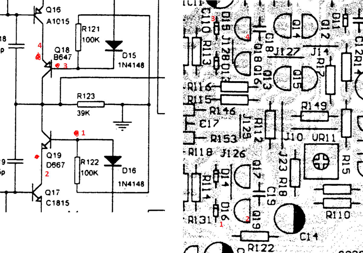

5/ I suspect there is a fair chance the problem could be with one of the transistors Q18 and Q19 or Q112 and Q113. measuring base/emitter voltages on these when the fault occurs would be worthwhile. You are measuring across the base emitter junction and looking for deviations from the expected 650mv (approx.) Typically the voltage would be significantly higher indicating a problem with that transistor.
Er, can you confirm where do I put red/black probes and which setting on the multimeter (guessing low range DC mV).
DC mV as you are looking for a 0.6v (650mV) drop across the transistor Base/Emitter junction for the transistor to be conducting.
See the attached schematic sample and (should be) the corresponding points on the PCB for Q18 and Q19 to get you started.
For Q18 Base, use D15 Cathode (striped end) and for Q19 Base, use D16 Anode (opposite end to stripe).
Shouldn't really matter which orientation for the red/black probes (yeah, I know, not best practice), you are just looking for the 0.6v at this stage.

Pretty much as avtech mentions above. Any parallel resistance will influence your result plus any slight residual voltage (from the PSU caps) can totally confuse the reading from a DVM. Also, depending on the test voltage that the meter uses you can find that various semiconductor junctions become active and again sway the result.
The base/emitter voltage seen across a normally operating transistor is determined by the physics of the materials used and that means for normal silicon devices it will be in the 600 to 800 millivolt region.
An NPN device (those with the arrow on the emitter pointing outward) will always have the base as the highest of the two, the PNP's (arrow pointing in) will have the emitter as the highest.
So to measure this you place the leads on the device itself. Be extremely careful not to short any pins as that could result in instant catastrophic failure of several components.
