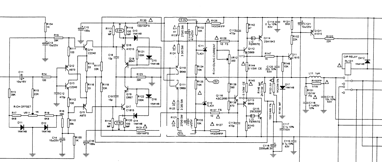

The voltages across the two Zener diodes doesn't sound correct. If you look at the circuit diagram you will see R126 and R127 connect the diodes to the two supply rails.
You should have +46 volts on one end of R126 and -46 on one end of R127. Those resistors should be easy to find as they are larger 2 watt components.

That makes the input section very likely the problem.traderbam: I measured R123 and its is 39k (well 38.7k). On powerup it does increase to 1.3V before the cutout click.
If you unplug the link on the back panel for "MAIN IN R-Channel" (I am not looking at the manual so I'm assuming there is some link connecting the pre-amp to the power amp) does the output still drift up to 1.3V? If not, then C11 is the problem.
Otherwise C116 is still a possible cause. The 10 input section transistors (which is a lot) and 4 electrolytic caps are also suspects. I just noticed VR11...hmm.
Also, please confirm that it plays music out of the R channel prior to cutting out.
If those zener readings are right then there is a bigger problem here. Obviously each zener should have 4.7V across it.The voltages across the two Zener diodes doesn't sound correct. If you look at the circuit diagram you will see R126 and R127 connect the diodes to the two supply rails.

OR the schematic is not the right one for your amp. I'm having trouble finding Q110 in your photo...
So the schematic I posted was for the NAD C320BEE rather than the C320 SM. Some differences. Here's the SM service manual link: NAD C-320 SM Service Manual download, schematics, eeprom, repair info for electronics experts
This one has 39k for R123 and shows some voltages to check.

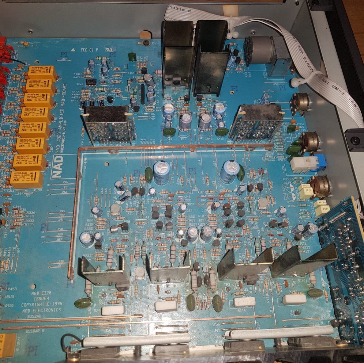

Attached image showing the diodes D11 and D12 that I measured (inside red outlined triangle). On first circuit diagram D11/D12 were listed at 4.7V, but that was for C320BEE. On circuit diagram the C320 I have, D11/D12 are labeled as 1N4148 and look like normal diode symbol, not the symbol for Zener diodes if I understand that correctly.
Yes, I think you are right. You'll see four voltages shown on the new schematic, 0.9V across two resistors, +5V and -5V. You should check these.Maybe this was to do with confusion on C320 and C320BEE?
To eliminate C116, try to measure the voltage across R149. It should be near zero at all times. If it increases over time, like the output voltage, then C116 is pants.
The reason R123 voltage is important is that is shows the input stage is not trying to correct the +1.3V error on the output by forcing a large negative voltage across R123. In other words, the input stage thinks it's supplying the right voltage...which it isn't. So either it is being fed an erroneous voltage from the output (such as if C116 is duff) or something in the input stage itself is broken.
The new circuit shows IC11 and IC12 which are programmable voltage references and these are used in place of ordinary zeners.
The important thing is that you have the plus 5 and minus 5 volts as marked on the diagram.
Something else to check. I see the input transistors are biased solely through the wiper of a preset (VR11 offset). You could try measuring the voltage at the junction of C11, R14 and R15 and seeing if it is stable or whether it varies/drifts as the fault appears.
