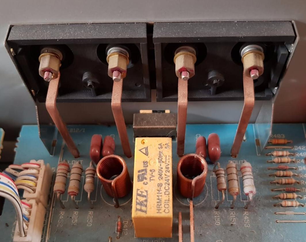

I measured the various resistors and got
  • R453 220
  • R151 10
  • R150 1.9
  • R452 220
  • R251 10
  • R250 1.0
[ It was pretty hard to measure the R150/R250 due to their placement on the board and the cables/probes I have with the multimeter. The other were a bit easier to measure. ]

attaching photo from relevant area of board with R150/R250/etc.

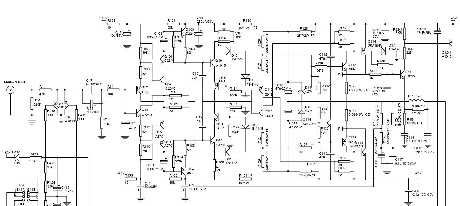

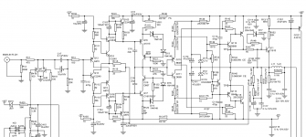

Here's the right channel power amplifier stage schematic. I'm posting this so others can more easily suggest culprits.
For a start you might want to visually inspect C116 and other electrolytic capacitors for leaking fluid on the circuit board. The electrolytic capacitors are usually metal cylinders with plastic wrappers.

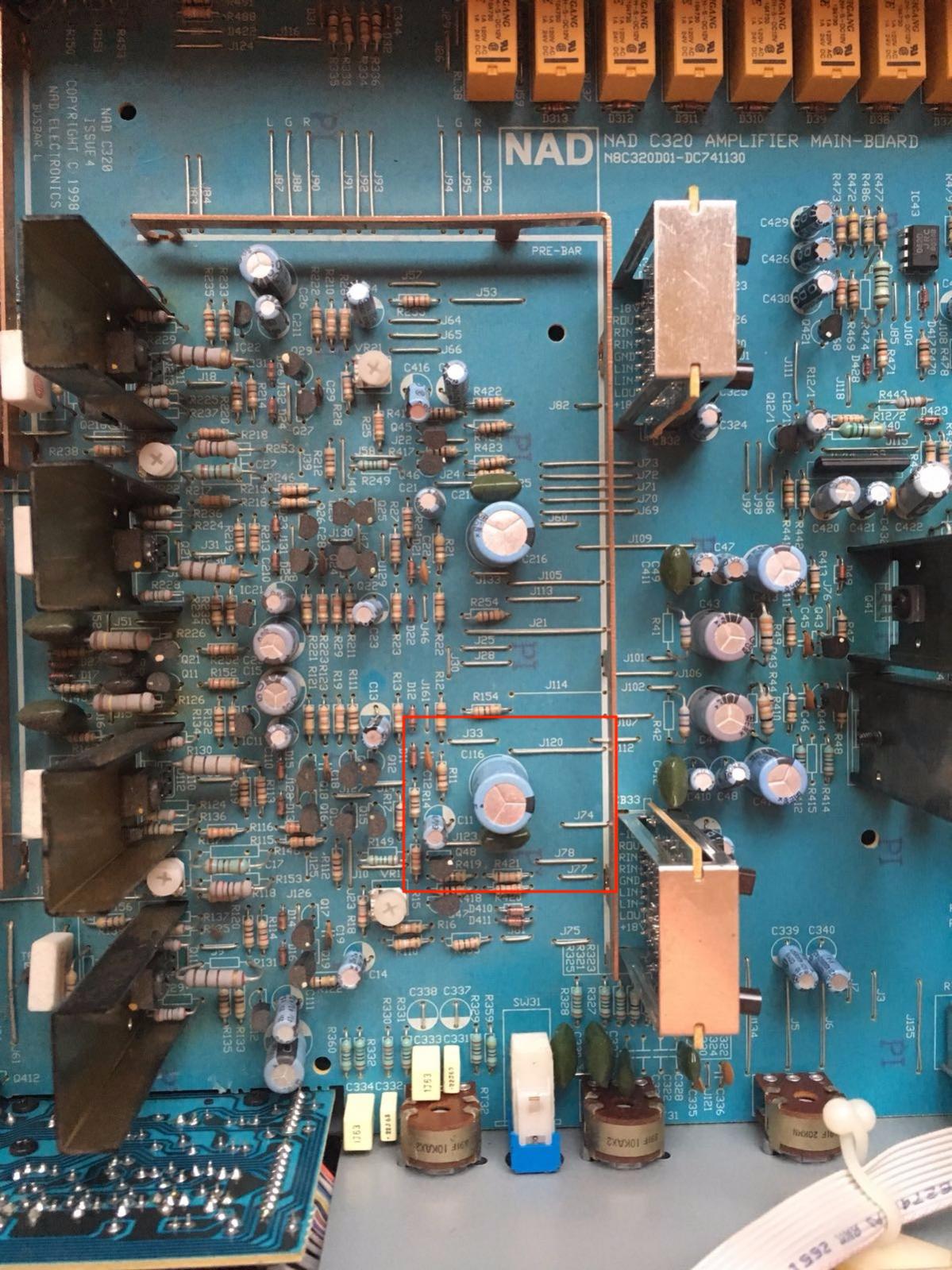

Thanks. C116 looks OK, in fact all the caps look OK (to my untrained eye). Image attached.
btw, I measured R150 several more times and could not get a consistent reading. It was between 1.0 and 1.9, but varied a lot. The other resistors were much more consistent but also easier to get the probes onto.
Does rapid variance when measuring across TP1/2 and TP3/4 tell me anything or is that expected (or maybe user error?).
Don't worry about the value of R150. That's probably measurement error. Multimeters aren't always good at low resistances. Disconnect speakers of course.
I would expect some initial, wild variation in the voltages across the test points after power up. How long does it take to settle down and what range does it settle to? I don't know the NAD bias setting but I would expect the voltage to remain less than 20mV.
Always check the supply voltages are correct as a first step. C15 and C16 should have close to the full supply across them which looks to be -/+46v. Also check the voltage across the two 4.7 volt Zener diodes D11 and D12. Should be around 4.7 give or take.
If those check out OK then you might have success using freezer spray used very sparingly to see if anything does seem thermally defective. Its quite a complex design and although there are a multitude of tests that can be done to localise the fault, you would need to have a good working knowledge of the circuit and how to interpret the results. Freezer just might be a quick route for you.
(A can of cheapo air duster which is butane based will work well as freezer if you invert the can. Aim to dispense literally a single drop at a time onto components such as the small signal transistors)
Can you measure the voltage across R123? I want to see if it also rises to 1.3V or does something else. This will narrow it down.
Be careful with those probes not to slip.
(PS: In the schematic R123 is 47k but in your photo it looks like 39k. So a production tweak at some point. This doesn't matter for tracking the problem down.)
