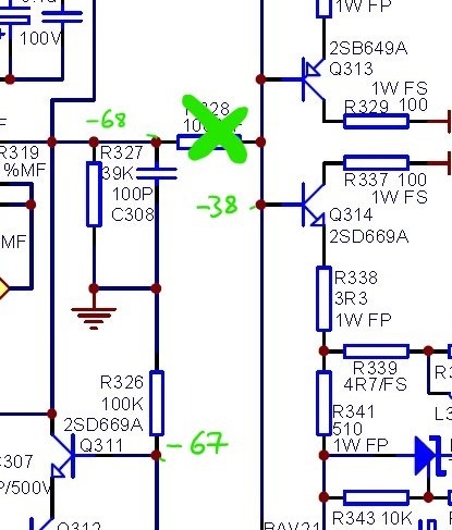

That you observed 115V leads me to suspect the meter somehow saw rail-to-rail supply voltage. Ground the black meter lead and measure each end of the resistor for insight.

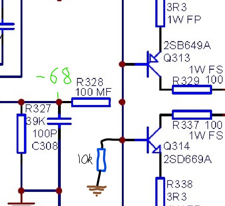

Here are those numbers with connection to input/R328 open (blue) and with 10k resistor to ground (black - highlighted):
So yeah I realised that by not "zeroing" the output side with the 10k resistor, the numbers might be rubbish. Sorry if I was confusing things there. And now the voltage drops are correct with both low-voltage ends being around +/-5V.
I also did some comparisons between Q318 (L) and Q418 (R). Once again I perhaps confused everything by not using the 10k grounding set up.
And of course, the voltage across C312 is 5V using the 10k ground! I guess I didn't fully understand what you were asking when you said to put the output stage into 0V output...now I think I see why the 10k resistor is critical to your troubleshooting. Sorry. I will now leave it 10k to ground unless stated otherwise!

A large positive voltage should appear at R327, but isn't. So again confirm about -11V appearing at L-FDBK and that R327 voltage remains stuck in negative territory. Now to discover why it's not positive volts. Would you remeasure the all the same points you reported in your first schematic of the original post, in the left channel input section. Your original measurements may still be about the same. Most dramatically concerning is the -58V near the feedback resistors from L-FDBK. I imagine it will still be "interesting." I recall that you replaced Q309. Would you report voltages at Q303,304,309,310.

Hi thanks for studying these ramblings further....I didn't manage quite so much time on it today however I now have updated voltages for the input section. These were done with the output section earthed via 10k resistor and R328 is not connected, as before.
Is that -58V actually -5.8V?
Yes, there's a tiny decimal in there, it is -5.8V.
and isn't. We definitely seem to have a large NEGATIVE voltage (-68.2V)
I suggest returning to post #14 and reestablishing that last measurement: "-12V @ base of Q313/Q314 produces -11.6V @ TP2"
I checked this and -12V into the output section gives -12.3V at R322/R319. Is that about right or very wrong?
The new measurements above don't really tell me anything, I hope they mean something to you! I have already replaced Q308, Q309, Q310, Q311, Q312.
I also don't really understand what the Q305/Q308 B-C shorts are meant to do.
I'm gonna stick my finger in the air....should Q304 be letting through more volts?
