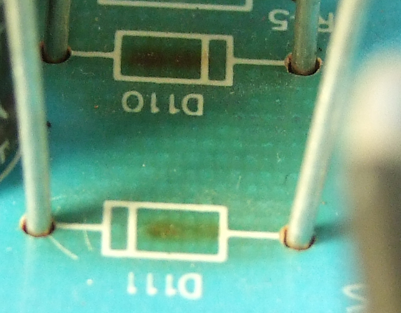

Stabilize from +/- 55 volt to +/- 26 volt: this is bulls...t!
Of course i'ts gonna be hot.
My C556BEE the same.
Especially with DAC module the result is dramatic.
( DAC module powered also from +/- 26 volts! )
Very hot Q41, Q42 heatsinks, very hot D110,D111 Zeners, browned PCB, etc, etc.
Answer from NAD: this is normal...
Oh shure!😀 😀 😀

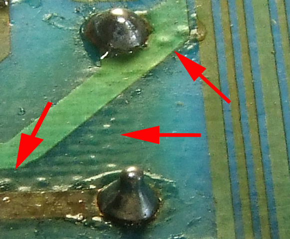

This is my C356BEE.
You see on the pictures, the PCB is blistered, which means that the epoxy carrier is also damaged by excessive heat.
If you think this indicates normal warming and just discoloration, then i would ask where did you learn this profession?

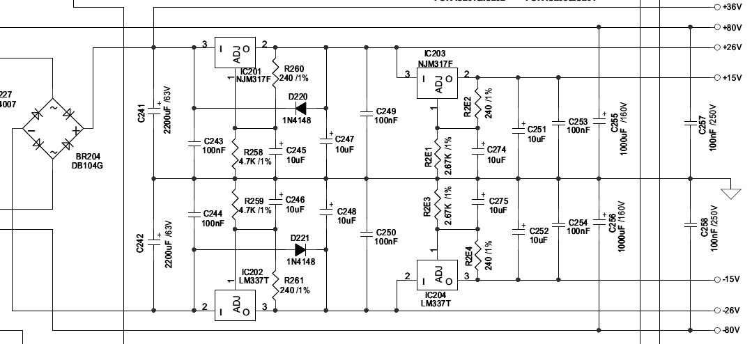

An idiot who send 30 volts different to an linear power supply input! (Efficiency?)
Would it have been too expensive to make another transformer coil with lower voltage?
In C375BEE is good solution. Input voltage +/-36 volts. (attached schematic)
Why wasn't that good?

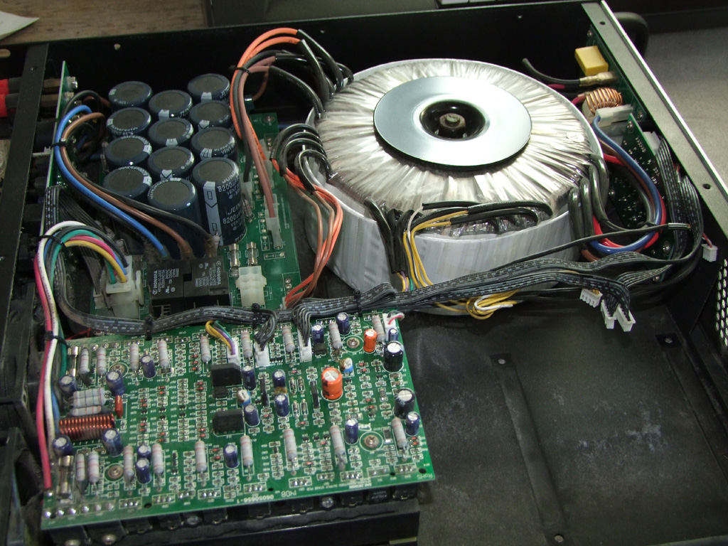

This is an Ecler PA amplifier in my workshop for repair.
(Sorry for my bad english!)
Blistered and charred boards are obviously damaged, not just discoloured, which is all I referred to. For a thermosetting plastic substrate like FR4 Epoxy/fibreglass to blister, it suggests extreme temperature conditions rather than a protracted overheating problem. I've not seen it here in local or imported audio gear - only in cheap industrial power supplies. One consistent blistering fault I witnessed was actually due to substandard PCB materials (uncured resin) and all the traceable units were replaced under warranty.
If you're unhappy with NAD's design philosophy, then take the matter up with them. I'm no apologist for their manufacturing philosophy and I have never liked working on the products from the days of the first 3020 model. I don't like it either but strong sales drive business - especially low price, high sales volume business.
Its not surprising that C356, C375 & 3020 designs are all credited to the same lead designer, B-E Edvardsen. So, if some of the relevant models seem OK and others not, then the problem is matter of deliberate budget compromises - perhaps bigger ones than anticipated.
