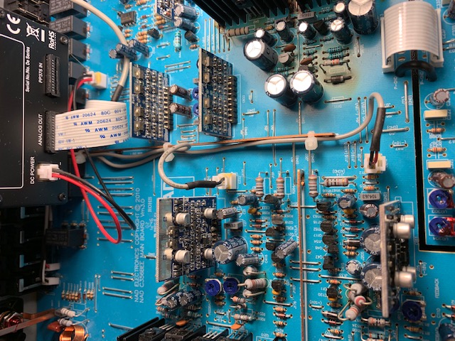

thanks, I'll double check it as I did have speakers connected. Should the volume be all the way done and nothing on the audio input at the time of the test?
Just so I'm clear, you are saying to disconnect capacitors connecting to that -26V line one by one and see if it changes the non -55V side of the resistor that is getting hot? I'd want to see the voltage on that 'low side' go up right? That would make the drop across the resistor less?
I did test the leg of Q42 (next to hot resistor) and it is reading -26V, which I think is good?
Yes. It's unlikely speakers connected or not will matter to these measurements but they will matter when you come to perform the alignment (once you're done repairing)
Measure from one leg of the resistor to the other (green arrows). The difference will tell you how much current is passing through it.
Most of the difference between the -55v to -26v should be happening in the transistor, but it will vary its effective resistance depending on load automatically, in order to keep the emitter (orange) at -26v.
Depends which leg you measured, but assuming the one you got is the emitter (marked orange) then that is expected as explained above.
Thanks Mooly, if that is the case should I order a 2 watt resistor ( or 50! Lol) to replace it with? Or leave the one in it?

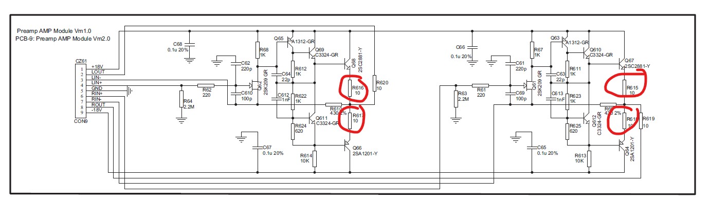

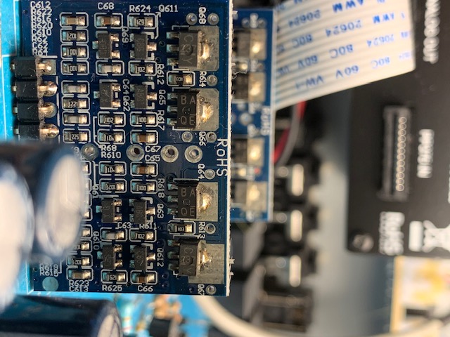

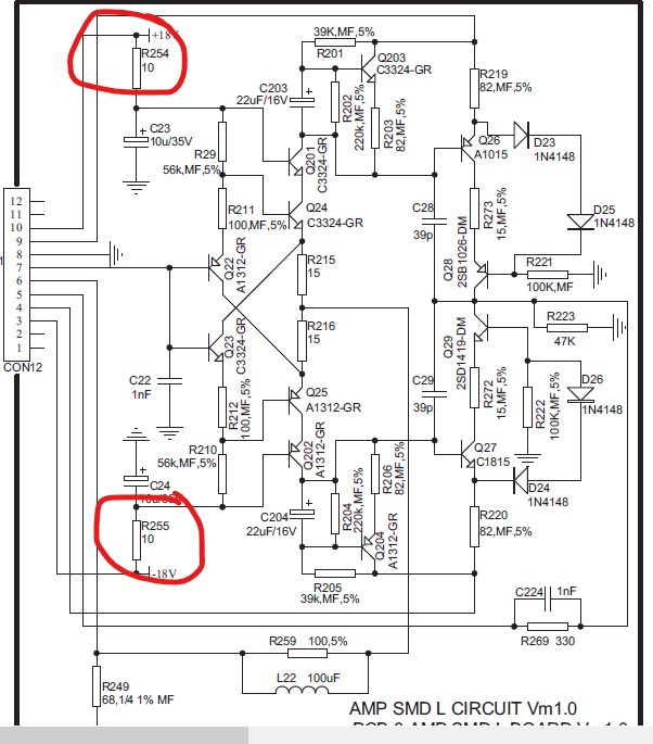

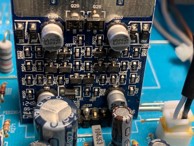

Okay folks, I'm back. I ran the test Mooly mentioned. There were two of both boards you pointed out. And the components are tiny. LOL.
I've attached a photo that shows all four, and close ups of the two styles of board.
I tested the voltages on either side of the resistors with teh volume down and no speakers attached. I got the below readings:
Board 1:
R255: 18.09, 18.09
R254: 17.78, 17.78
Board 2:
R155: 18.14, 18.14
R154: 17.79, 17.79

Nothing looks wrong there.
Need to have another look at the circuit diagram but do try and eliminate those electrolytics, they do tend to start leaking current with age.

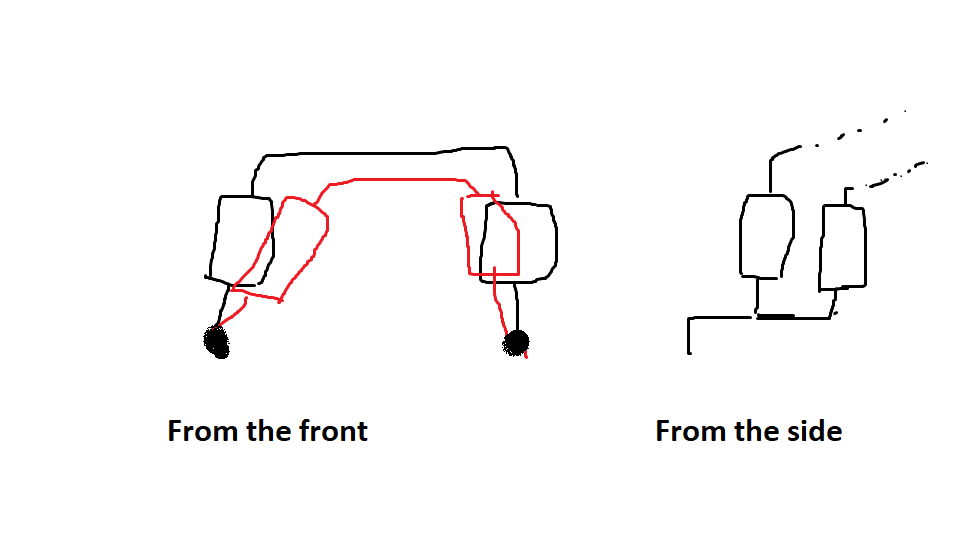

Four resistors... bend the leads neatly for one pair and mount them vertically. Add a bend so it moves them forward into that empty space. Then add a second parallel pair by wrapping and soldering to the first pair.
Like this, rubbish drawing 😀

I did a temp check on the caps in the area. C410 felt the warmest other than C43 and C44 which are both pretty hot. I took C410 out and still have 7.1 Volt drop on R46.
I also put a bright light under the board and noticed the trace from the Q42 to R46 is turning dark in color, so we are certainly running some juice across that one.
Looking at the board I was again reminded that R45 and D110 are also very hot, to the point they are also turning my circuit board weird colors as I do these tests! 🙂
Would there be anything that is common between the +55VA and -55VA sides in this area that could be impacting both? Seems like they are both having issues. The thing still smells hot within second of me turning it on.
I'm willing to take a stab at pulling Q41 out if I can figure out a way to get my meter in there. Please just confirm for me that you want me to test Q41 and not Q42.

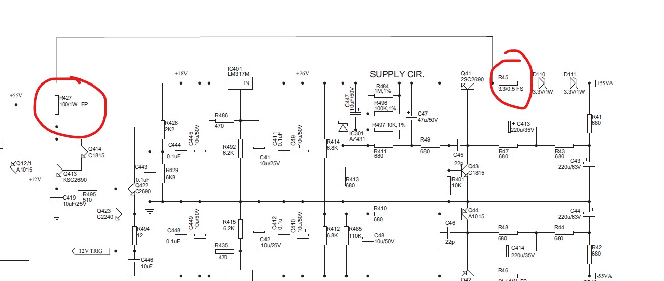

I was all ready to just rig this up with 4 of these 51 ohm resistors but I just a touch hesitant. Though the longer I sit here tonight I may end up just doing it and seeing if the smell goes away. maybe I just smell that R46 resistor.
Q42 we already know the current in, its the same as the 51 ohm.
Q41 is different because although there is a resistor present (R45, 3.3 ohm) there appeared to be a another take off point after that resistor that would add to the total current in that resistor...... and I was just looking at the snip of the power supply you posted at the beginning.
An easier way looking at the full diagram. The 3.3 ohm also feeds the 12 volt regulator via R427.
1/ Measure the volt drop across R427 and calculate the current.
2/ Do the same for R45.
3/ Subtract the first value (R427 current) from the current in R45 and that will leave the current flowing in Q41.
I would expect that calculated current to be similar to the value you see in the 51 ohm.
