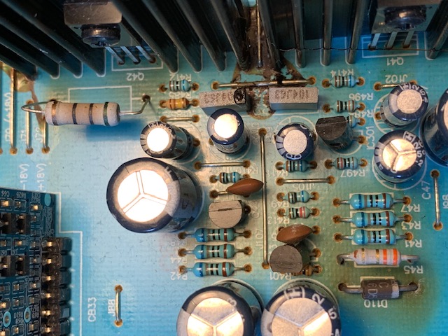

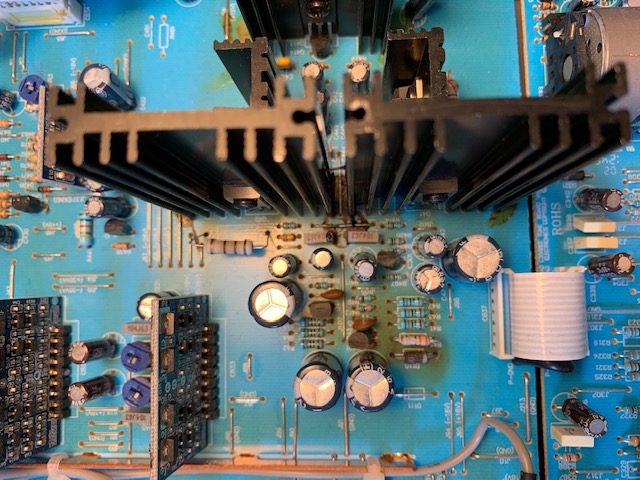

Thanks for all the help everyone! Hopefully we can zero in on some ideas. Attached are some photos of the AMP. Please note, resistor I replaced is discolored now (Colored lines are brownish), also note the board shows signs of heat by D110 which I did not replace. Again, everything is working. I just don't want to damage anything.
I'm holding another new resistor (I had to buy 50! LOL) to compare to one I replaced and is already discolored again.

Thanks for the thoughts! You've said a few things outside of my knowledge. But a few answers:
I checked all the voltages as marked on the circuit board. Things look good there (+/- 18, +/- 26, +/-55)
See the new photos I uploaded, if I understand you right the resistor does have a pretty big space from the board. I tried to make it about like the old one was.
I did visually inspect all the caps, things there look good. I also checked most, if not all, of the resistors (in the area) and they all seem right.

D111 is not in the circuit because it was simply replaced by D110 of the double peak reverse voltage drop. It is a zener diode, replace it with one of exactly the same specifications. It is not a common diode.
And, I do not share the phrase of someone who said "it would have been fried", the lamps act as a resistance that absorbs the current in case of short circuit in the output stage ....
The resistance that overheats and becomes discolored is because of something!
The issue is to find what causes it to overheat, not change the same indefinitely, until finding a "miraculous".
Now, if you decide to follow advice like "I would leave it that way", the decision is yours.
