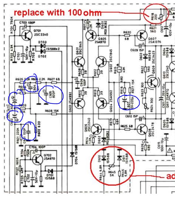

What's odd is that the RH channel with the new power transistors sounds much cleaner and more well-rounded. The LH channel has way too much treble, and virtually no bass at all. One thing that I did on the LH channel that I didn't do on the right was install a new potentiometer in place of the failed distortion potentiometer. I made sure it was set to 100ohms when I installed it, but when I found that same potentiometer failed on the RH channel, I got lazy, and tossed a 100ohm resistor in its space. It doesn't seem like this should do much, but I'm tempted to replace that pot on the LH channel with a 100ohm resistor...just for consistency's sake. Other than that, I'm tempted to replace the same power transistors on the Left channel, as I did on the Right channel.

Transistors won't cause any alteration in tonal balance. If the bass is lacking then that points to a cap that is either low in value or that has been replaced withone of incorrect value. I haven't the circuit in front of me but look at the input coupling cap and any electrolytic cap in the feedback return.

I have also been thinking about the caps. The only schematics I've had available, have been the ones I've posted in this thread.

Yeah, for the number of broken electronics friends and family throw at me, I really should own a scope...I should start a fund... But until then, looks like I'm going to have a lot of soldering ahead of me! (None of the caps on the board were visually distorted)

Well, I went ahead and pulled all the caps that you mentioned and this is the result:
Cap. Should be. Is.
C601. 100pF. 170pF
C602. 1uF. 1uF
C603. 1uF. .995uF
C604. 1.2nF. 1.34nF
C605. 820pF. 808pF
C606. 100pF. 160pF
C607. 220uF. 232uF
So, none are way off-spec. But some are more than they should be. Is it enough to cause an issue like this? (Goes back to the whole scope issue)

They seem fine. From your description of the sound it would need for example the 220uf to be below 50 and the 100pf to be over 1000pf.

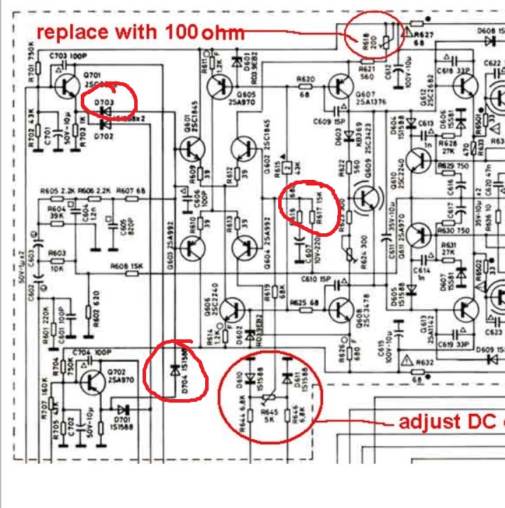

Alright, I went ahead and tested at a whole variety of tones, I setup @ 50hz since that's a frequency which the meter probably best responds at. I adjusted the volume to output 1v on the stronger channel. I also swapped L and R inputs to ensure that there wasn't a stronger output from the generator...the values remained the same regardless of which input I used.
L R
30hz 0.485v 167mV
50hz 1.000v 0.366v
100hz 0.499v 177.3mV
250hz 0.422v 147mV
400hz 391.4mV 140.3mV
1.6K 276.1mV 101.1mV
2.5K 211.0mV 78.7mV
16K 35.9mV 12.7mV

That shows a lack of gain across the board.
First thing to eliminate would be the possibility of poor tracking of the volume control if you did that test at a level that only needed the control turning a few degrees. Assuming that was all OK then its strange. Only two components set the "gain" of the whole amp, the ratio of the two resistors circled. The two diodes look to be some form of switch on (or off) noise suppression. Might be worth lifting those two diodes and retesting. I can't see it would cause any issues. The other two diodes go to the other channel. If one were leaky it would form a divider and reduce the input level so worth looking at.

One thing I wondered about but had no time to test is the impact of the speaker load. Tomorrow I'll swap the speakers and retest @1v.
To obtain 1v, it only required a couple of degrees of volume.
I'll also go ahead and check those components and see what their values are
