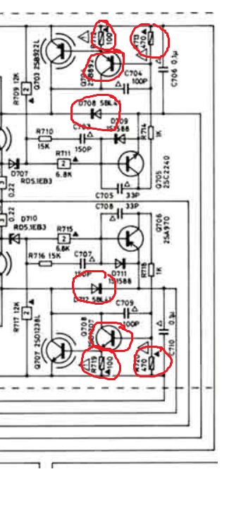

Here's a link to a schematic for the LH channel of this amp...just change each number by 50... (Q707 would be Q757 on RH channel...etc...)
http://www.diyaudio.com/forums/atta...offset-problem-nad-7250pe-offset-resistor.jpg

For ease of comparing to the schematic, I'm going to site all the RH components in the LH channel component numbers. Since we're all reading off the LH channel schematic.
Ok, so, one finding... While the amp was on end, and I was searching searching searching for D708/D712...I discovered under a bar a pot...the distortion pot for the RH channel. Elusive. I pulled it and found 1.4Mohms from end to end, should be 200ohms. So, I don't know if that would have much impact, but it's gotta be fixed.
I located D708/D712 and they both check good.
R640, R641, R642, and R643 (all the 0.22ohm output resistors) all check good.
Q616 and Q617 both check good as well.
I did find what may be a failure on Q618/Q619.
I lifted the emitter leg on all output transistors during test. Q618/Q619 both read OL when checking with + to C, and - to E, but 1.7v when checked - to C and + to E.
Q616/Q617 read OL when reading in either direction on the C and E terminals.

The 200 ohm pot (you mean the one at the top) is vital but could be replaced with a 100 ohm as shown. With it OC the amp will not function and you would get a huge offset. That offset would also cause the "rail switching" transistors to switch to the higher value... which you have got.
I would replace the resistor, then set the bias current pot (R624) to its HIGHEST resistance which will give the LOWEST quiescent current.

Well, it seems that the 200 ohm pot is going to be the culprit. I lifted all surrounding components to the failed transistors and found no issues, and when I lifted the other legs of the two suspects (Q618/619) I found them to be in good working order as well.
I will be ordering a couple of 100 ohm resistors to replace the POTs with. I'm thinking 1/4watt, but for safety's sake, I'm on edge of getting 1/2watt....
As for the comment about setting R624 to its highest resistance. I presume you mean full CCW... It would seem that CW would be lowest...
I will be holding off on applying any power until I get new transistors for Q703 and Q707, and the 100ohm resistors...

This is true on either channel A or B....
I have noticed that some of the pushbuttons are a little intermittent, LowLevel and Loudness both seem like they could use some deoxit...
The only thing that I am looking into clearing up is that now that I can get audio out to the speakers, I have mostly Mid and Treb with very little bass on the LH speaker, and mostly Bass and very little mid, and some treb out of the RH speaker.
