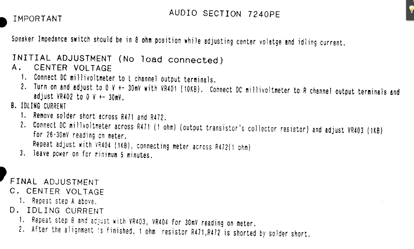

I'm struggling to understand the first page of the service manual about setting the currents. Is this worth a check and if so, could some kind soul clarify the instructions for me please?

In particular regarding clarifying checking the current settings (manual reproduced below).
Centre voltage (A1) - Is that simply across the speaker terminals? Presumably with input shorted and min volume?
Idling Current (B1) - Would this be a short on the back of the board? I'm struggling to find any removable link.

Q417 is the Vbe multiplier so poor soldering there would result in excessive quiescent current... so it looks like you've found the fault 🙂
The first part of the set up is just DC offset so adjust for 0.00 volts DC across the speaker terminals when the amp has been on for a while.
Second one is bias current. Removing the solder short puts a 1 ohm in series with the output transistors. So adjusting for 26 mv across the ohm gives a current of 26 milliamps. Leave the amp on (and no speakers) and keep tweaking until its around that figure at normal temperature. Leave the top on and then recheck after another 30 minutes or so. Then apply the short again of course.

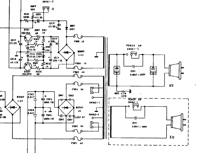

The fuses... hard to say. Haven't got the manual in front of me so can't see what they protect. They must be the correct type with regard to fast or anti-surge (time delay) specs. It should say on the PCB such as F5A or AS5A or T5A etc. Any fuses for the transformer primary should be the correct value although lower will just/or could cause random blowing at switch on. If the fuses feed into a large capacitor bank then they should be as recommended. Which they should be any way really 🙂
They are on the power supply before the bridge rectifier (see below).
As I understand it the switch chooses different secondary voltages depending on 4 ohm or 8 ohm speakers. Seems odd but I'm no expert!
Mine are the correct "T" type, it is just that I have a packet of 4 amp ones to hand and no easy supply of 5 amp!

OK, when it has been on for half an hour (the heatsink is gently warm) I am measuring 11 mV on the left hand speaker outputs and 12 mV on the right.
It that worth attempting to adjust or are the cheap and nasty presets that haven't been moved for 20 years best left alone?
Visually the two presets for each channel are in similar positions so I assume the transistor must have been making a reasonable connection when they were factory set?

Lets say 4 amp will be OK... and qualify that by saying that they are underated if you drive the amp to its max power output into 4 ohm loads. T = time delay so that's fine.

Given that the centre / ofset voltages are well within the quoted tolerances, the heatsink only gets very gently warm and seems even for both channels plus it sounds fine do you think it is worth hunting these linkages and playing with the current settings?
I'm always bothered that my 10 quid meter may not be that accurate and that it is difficult to get reliable enough probe connections. Plus the presets look real junk, nothing like the quality of the ones in my Arcam amp.
Shall I attempt it or leave well alone?

I'll probably check them at the weekend. Given the naff pots I won't touch them unless it is far enough out to justify.
The manual says 30 mV across the resistor. Presumably a bit below would be acceptable but not much above? How much would you accept before going to the hassle of fitting new pots etc?
Measure and record the voltages first, from cold through to warmed up. Remember the adjustment is finally made with it at normal temperature.
Anything from 20 mv or so up to say 35mv when its hot is acceptable. You'll probably be surprised just how much the readings change with temperature anyway and just how difficult it might to get a steady 30 mv. It depends how good the amp and physical location of the vbe multiplier is (that middle transistor on the heatsink which is supposedly at the same temp as the outputs). There's a huge amount of thermal lag there so adjust slowly and wait and let it settle.
Yeah it doesnt have to be bang on 30mV. Most of the time this is not determined in any way apart from the designer thinking "20mA of bias, that'll do" 🙂
